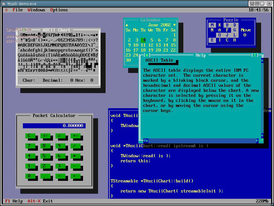

I'd like to see a TUI like this:
I think it would be simpler and faster than graphics. I know the display is graphic and not character based, but this is still doable, smaller, and likely more responsive than graphics. Plus you can still do graphics inside a TUI element.
As a "standard library" a TUI would help in educaton.
Edited 2021-02-17 02:58 by CircuitGizmos

  CircuitGizmos said  I'd like to see a TUI like this:
But perhaps not via TeraTerm if it doesn't support the box-drawing characters which that screen-shot makes use of extensively.
There is a question here of whether a TUI should be designed just for use via the VGA display or also via a Serial terminal, which the 1980's shows us should be possible.
  Quote  I know the display is graphic and not character based, but this is still doable, smaller, and likely more responsive than graphics.
I've written a substantial proportion of a character cell based API that works for both VGA and Serial terminal simultaneously. However it's still a far cry from a TUI and will probably require CSUBs if it is ever to become one.

"But perhaps not via TeraTerm if it doesn't support the box-drawing characters"
It can display box characters. Is there something I'm missing?
(Simultaneously supporting the serial TUI would be a lot of work, I think)

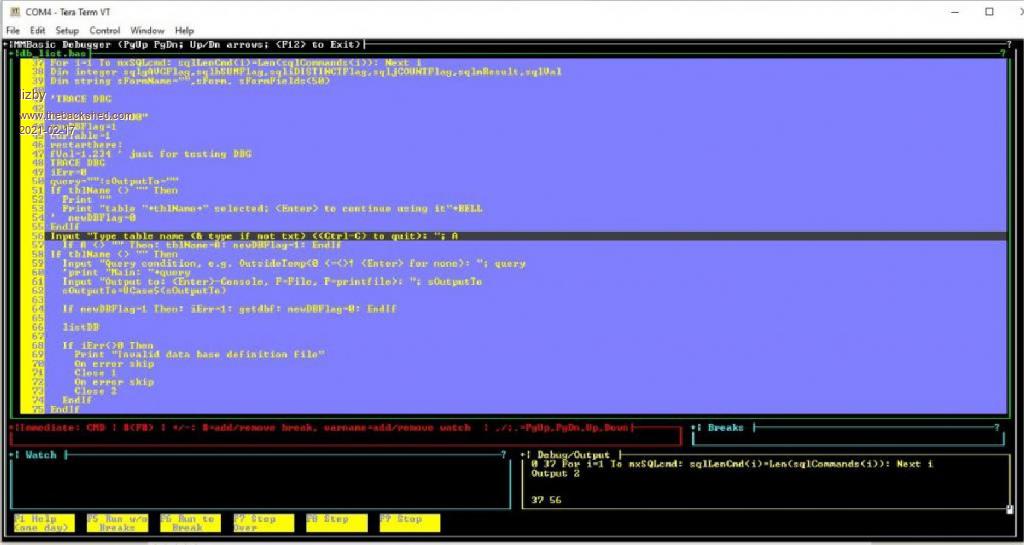

Posted: 06:11pm 16 Feb 2021
puTTY in VT100 mode works (mostly) for me for PC-type line drawing characters:
I did not pursue why some of the characters (e.g., some corners) didn't work.

  lizby said  puTTY in VT100 mode works (mostly) for me for PC-type line drawing characters:
Hold on, that screenshot is Tera Term, not PuTTY. How did you manage that? Are they the multi-byte or single-byte box-drawing characters ? Can I see your code ?

  thwill said  How did you manage that? Are they the multi-byte or single-byte box-drawing characters ? Can I see your code ?
I did some rummaging, I'm going to hazard a guess that you used the VT100 alternate character set https://en.wikipedia.org/wiki/DEC_Special_Graphics which is supported by TeraTerm. Alas not as convenient as Code Page 437 because it is different byte values to the CMM2 character set.

Oops, right--TeraTerm. I think puTTY worked also. They are single-byte box-drawing characters, with TeraTerm set in VT100 mode.
Yikes, the code? This is in C code compiled into MMBasic DOS, a project put on the back shelf some months ago, with output to a usb/serial module (the same one (or two of them rather) that you posted about a few days ago).

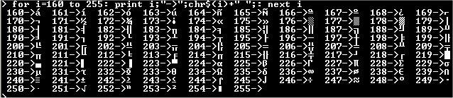

But on an Armmite F4 (CMM2 not available to me now), and Teraterm in VT100 mode, this lists what's available:
for i=160 to 255: print i,chr$(i): next i
Or, more compactly: for i=160 to 255: print i;"->";chr$(i)+" ";: next i
Edited 2021-02-17 05:35 by lizby

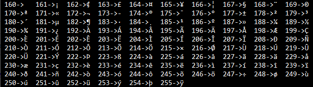

Thanks @lizby, what I've been seeing is:
However I've now discovered if I switch the font to "Terminal" then I do get the correct characters - you live and learn, it's a pity it's such a strangely proportioned font. I thought it was a code-page problem and couldn't find a way to change the code-page in TeraTerm.

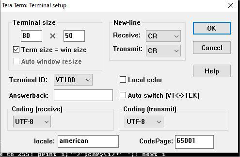

Posted: 09:38pm 16 Feb 2021
This is my Teraterm terminal setup:
I found that when I tried to copy (Ctrl-c) the Teraterm screen with the line-drawing characters and paste it into the forum here, I got the characters you show. That's why I did a screen shot.

Thanks @lizby for your earlier screenshot:
is that actually TeraTerm or is that MMBasic for Windoze/DOS, and if the former then which font ?
