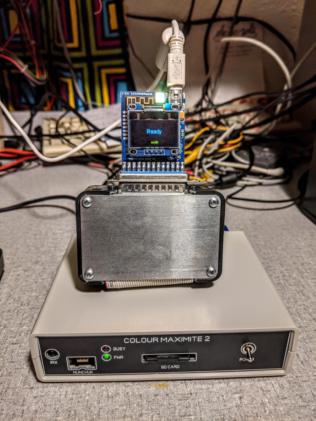

I can vouch for this because when I first tried interfacing a TTL serial port to the CMM2 I couldn't get any data to flow to the CMM2. After many hours of pulling my hair out I finally realized that the RTS pin on the TTL device had to be grounded before it would send its data.  It was sitting there buffering everything until that pin was asserted.
Ran into a similar issue interfacing the WiModem232 (which luckily uses 5V levels) until I was able to disable flow control on the device. But a 5 pin internal header with GND,Rx,Tx,RTS,CTS would be a sweet new addition in the future.
