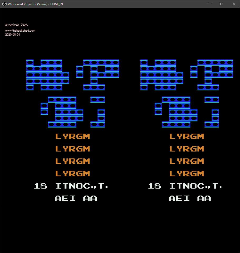

so... i rewrote the ppu logic...
Colours are working properly now but... well thats supposed to be the donkey kong title screen.
also, mode 6 works great. I need to figure out a way to offset the position of the rendering to the left by 16 pixels or so... any ideas?

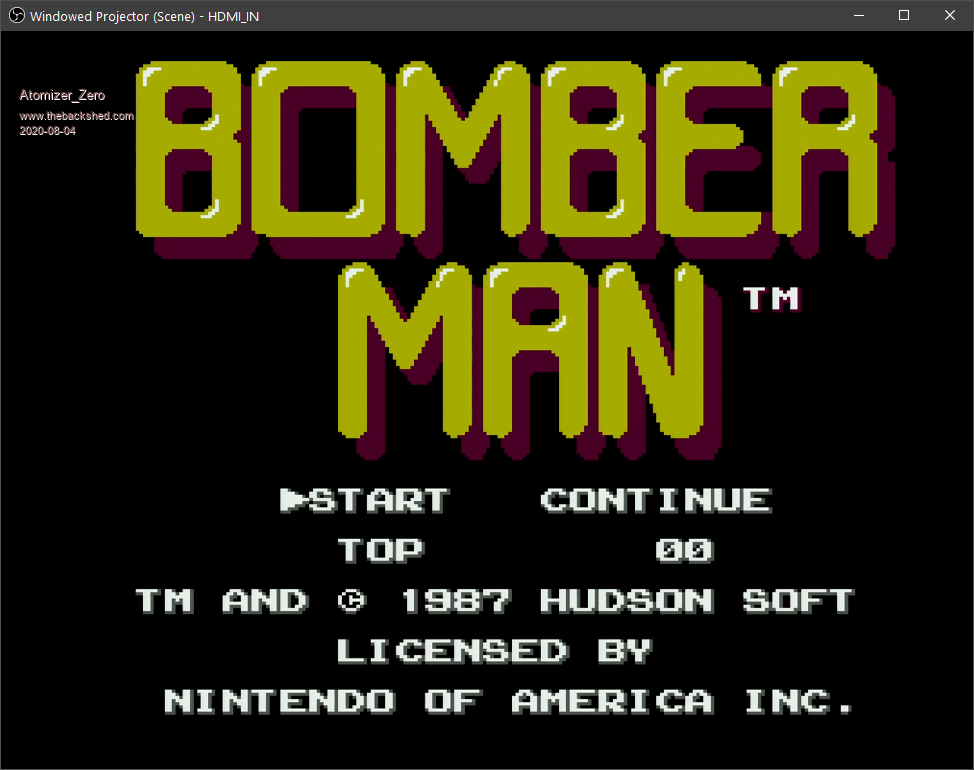

FINALLY!
But of course, still a problem. No Sprites are loading. The little Selection sprite icon isn't there.
But this is a win in my book. its running about 2 scanline a second, which is unplayable, but still a nice proof of concept.

still cant figure out the sprite issues yet. The little > triangle next to start is actually a background tile that gets drawn over the top of the background, which is interesting. Uses tile priority to draw on top. They could have easily used a sprite for it (like donkey kong does). It's also interesting to see bomberman running at all, considering it's a mapper 0 game has has horizontal scrolling.

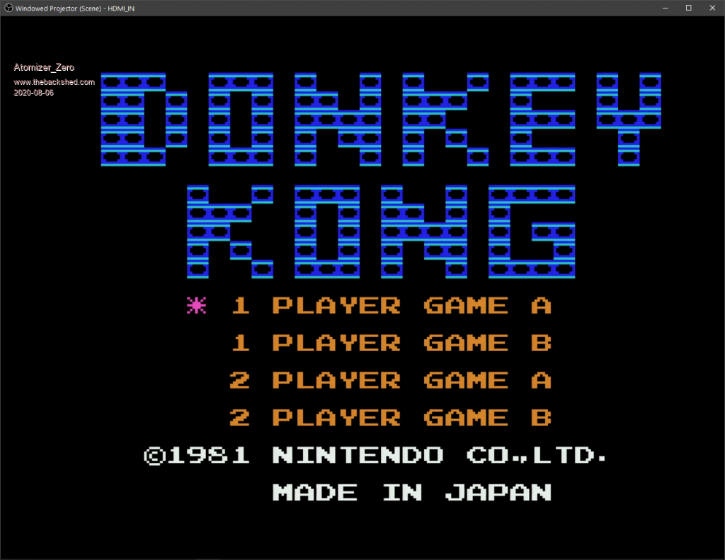

And just like that. I've fixed it
that little pink star is a SPRITE. :D
