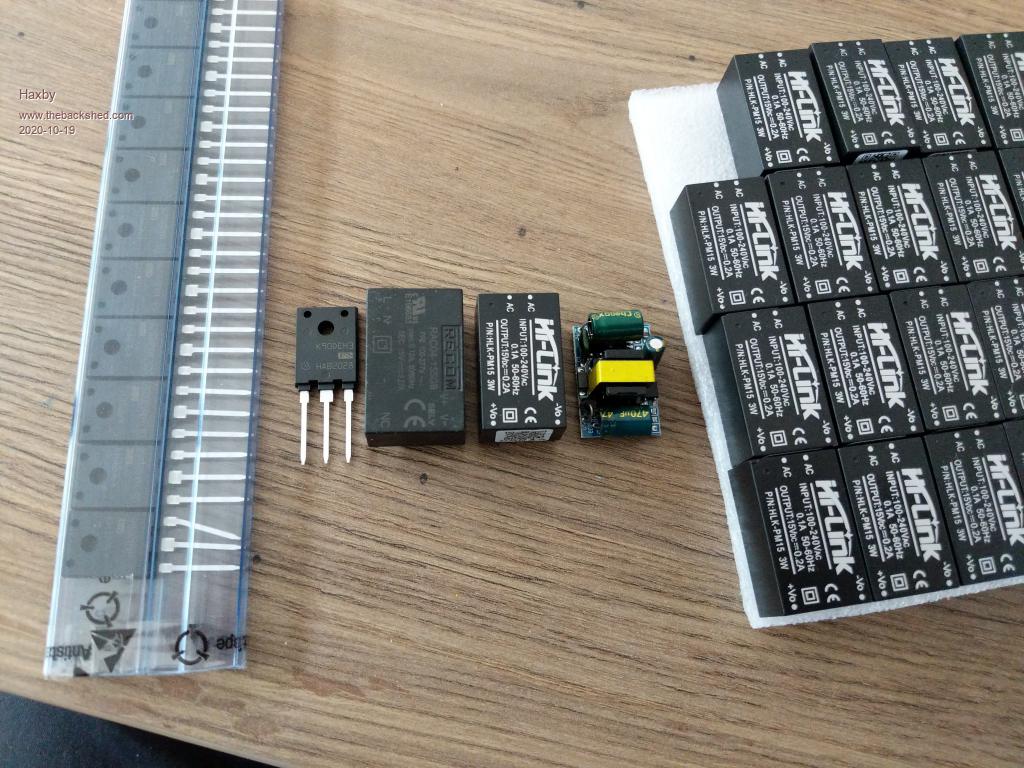

Well finally my Hi-Link 15v power supplies have come in so I can start designing the power PCB electronics.
I did get some of the other cheap generic 12V power supplies to modify to 15v, but there was so much solder splatter on both sides of the PCBs that I didn't trust them enough to put into what will otherwise be a very robust inverter. Also since I'm designing a PCB I don't want to lock myself in to a footprint that will change based on their availability.
The pic shows a comparison between the Recom, Hi-Link, and generic power supplies. Price wise, they are $30, $3, $2 respectively. I opened up the Recom and the Hi-Link to take a look inside. Both look like they are made from very good quality components. Both are in a silicone resin so it's hard to see everything. One thing I noticed is the Recom uses 2 X 3.3uf 450v rated capacitors but the Hi-Link uses a 400v labelled single 6.8uf capacitor. So the Recom is a slightly bigger package overall, and with a UL rating, you know you will get some good quality product. But for $30 each from RS, it was too costly given I need 16 of the little fellas. I'll go with the Hi-Link ones for this design.

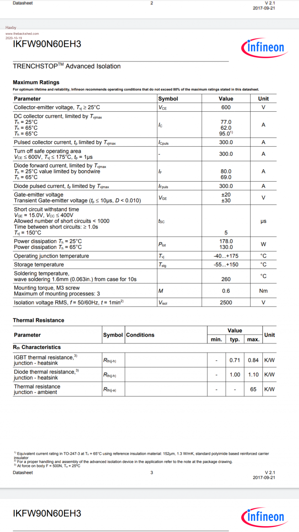

Now on to the IGBTs again!  I was going to use some 3 phase IGBT modules but have now decided to go with discreet components. Namely 12 x IKFW90N60 IGBTs for the first 3 inverters and 4 X IXGN320N60A3 for the biggest inverter.
The IKFW90 is an INSULATED TO-247 package that can handle some decent current.
Now can any engineers tell me why there are two separate current ratings at 65 degrees? And why the current rating is higher at a higher temperature? The footnote doesn't make sense to me....
I have already bought 20 of them, so I hope they will be ok. I bought them from mouser at $12 each, so I'm assured of their origin and quality.
Come to think of it, what if I used the IKFW90 for all 4 of the inverter stages. Would I be able to plug in a 10A arc welder to the inverter and use it reliably? What headroom do any of these numbers really need? The switching speed is going to be nice and slow, and assuming a decent heatsink, there is a lot going our way. But trusting the numbers is an issue for me.

You would need to get the Infineon data book.
Somewhere in that it will explain exactly how the device is tested, and what all the various abbreviations mean.
But basically mosfets act like resistors when in the on state. Power and heat production rise in proportion to current squared.
Under fault conditions, there will be an explosive release of heat which can be pretty fatal.
Also the Rds on increases with temperature.
As you work them harder they become slightly less efficient.
Mosfets are excellent devices, but fragile.
IGBTs on the other hand have a fairly constant voltage drop when turned on (rather like a diode). Power and heat production increase roughly proportional to current.
Under fault conditions the heat release is vastly less than with a mosfet, so the device can handle short term overload much better.
The on state voltage drop decreases with temperature, so as you work them harder they increase very slightly in efficiency.

To Make sense of the 65 degree Infineon temperature rating you need to read the additional notes on their isolated TO247 package (pg 12 for summary or 8-11 for verbose info), happy reading.......
Infineon-TO-247-3_Advanced_Isolation-ApplicationNotes-v01_01-EN.pdf

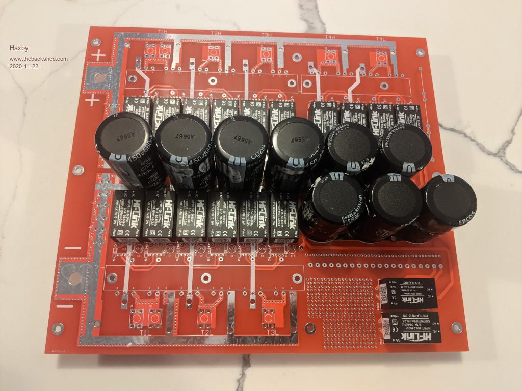

The PCBs have come in! The idea was to make it as compact as possible, so I put as much as I could on one board. I was tempted to only use one DC psu for all of the low side switching IGBTs but ended up having one psu each, as per other designs. Obviously with everything on one board, it's not as easy to fix as other modular designs, but the failures should be limited to partnered IGBTs only, and I really wanted something as compact as possible. The low profile will allow it to fit in a storage area between the boot floor of the Prius and the spare wheel.
Just waiting on the heat sinks to arrive so that I can finish it off and start testing. Transformers are all good to go. I'll solder 5mm diameter copper rod to the exposed tracks to fortify the current handling.

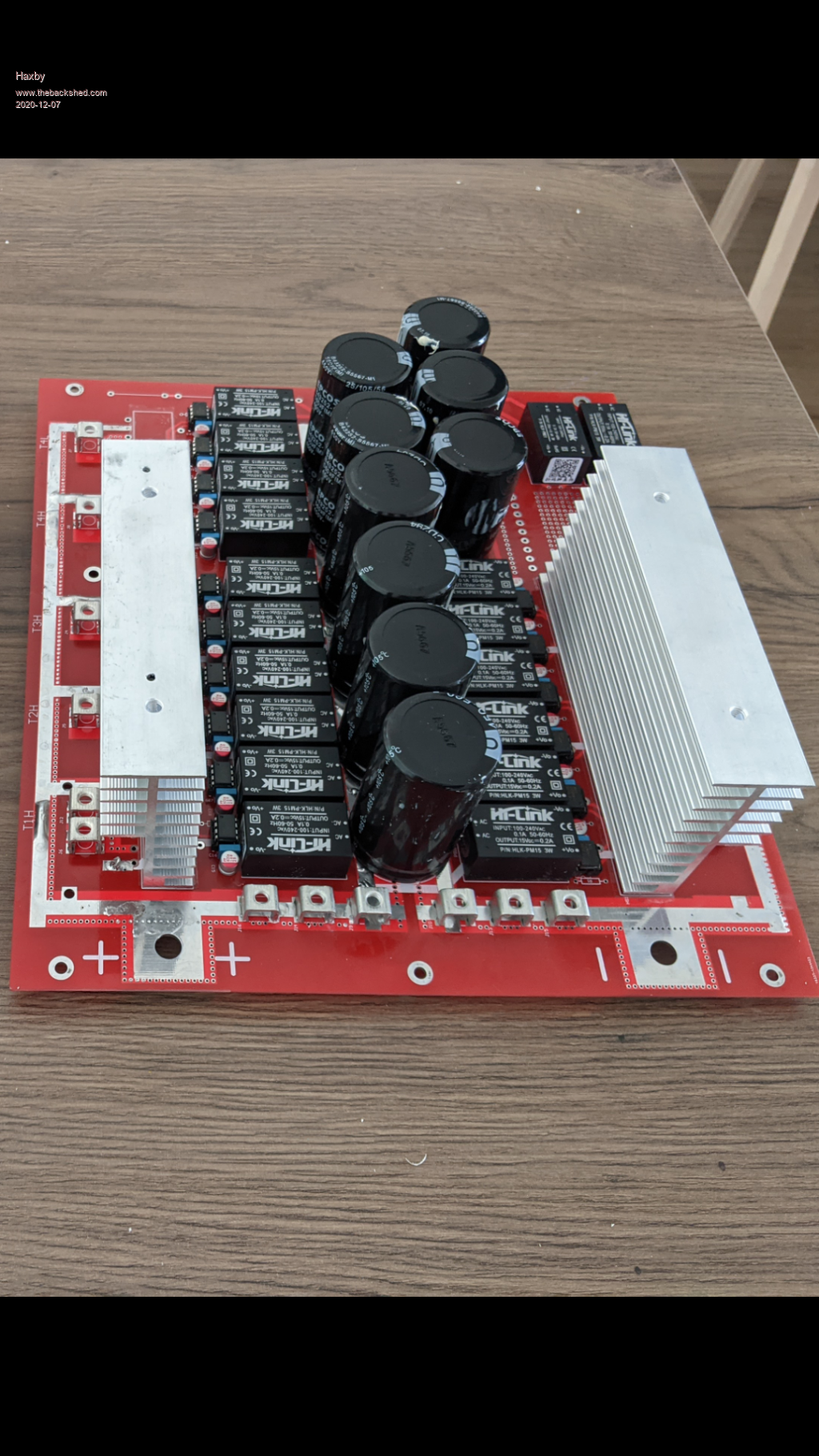

The heatsinks came in today so I'll be mounting the IGBTs. The heatsinks were pre-drilled and tapped by the manufacturer, which is nice and convenient.
Edited 2020-12-07 13:40 by Haxby
Posted: 04:44am 07 Dec 2020
Golly that looks really nice, better than a bought one !
I suggest you start off with just four IGBTs in the largest inverter and see how that goes first.

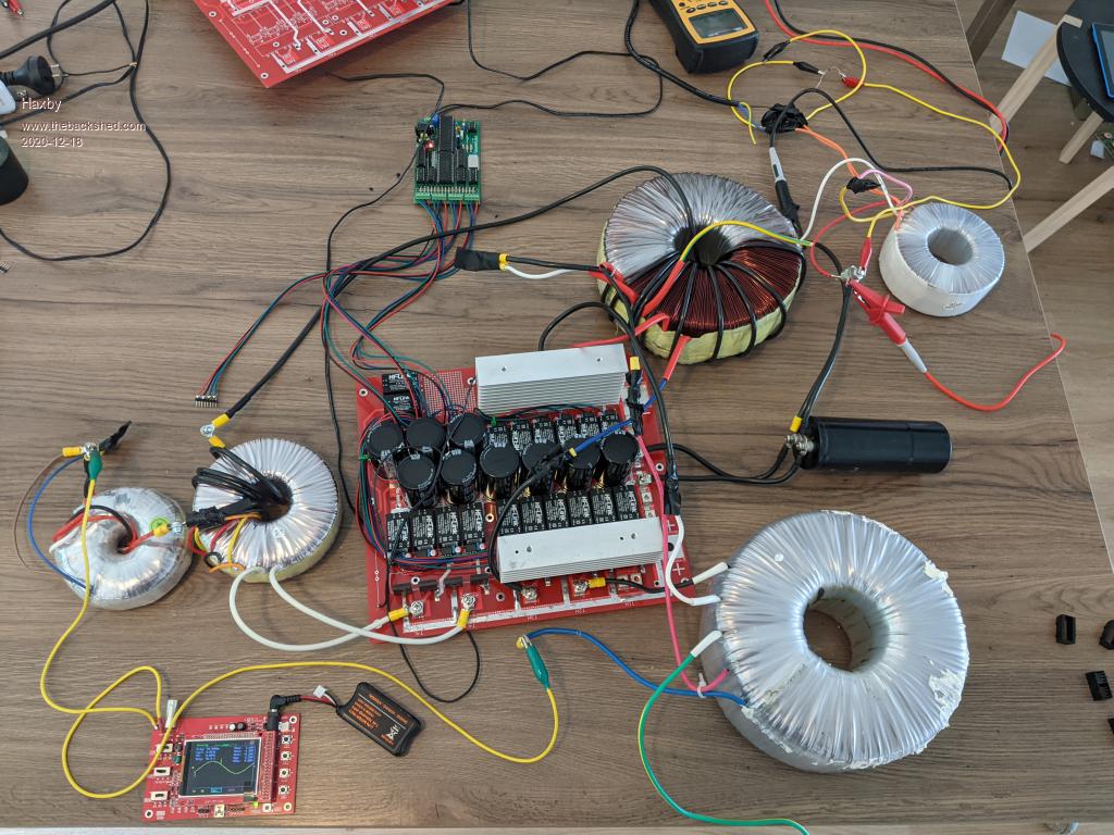

Good news: the high voltage warpverter is nearing completion.
Here is a pic of it running on 3 inverters. A big thankyou to warpspeed for all the input to get it to this stage. It has been a great covid lockdown project.
I blew up some IGBTs doing something silly so the 4th inverter will have to wait for another day. There are some unidentified spikes on the oscilloscope. Not sure if I trust the oscilloscope though. It's a cheap $40 oscilloscope connected through a 200k voltage divider.
For those not following the thread, the toroids are all unmodified, save for a few extra windings to get the volts right. The two biggest toroids are a 3kw aerosharp and a 1.5kw aerosharp.
I'm hoping to use this on my 200v DC Prius battery, but it should work unmodified up to 400v.
Load testing to follow. And in case you are wondering, that 5th toroid is the isolated mains input power supply. I wasn't game enough to try it right off rectified mains for the first tests.
Posted: 01:26am 18 Dec 2020
I have one of those "Barby Doll" small oscilloscope boards, and it did exactly the same thing.
Random spikes that blink on and off.
I would not worry about it, they are almost certainly not really there.
I fixed mine with a simple low pass R/C filter ahead of the oscilloscope. Looking at the mains waveform with a real oscilloscope, it looks clean.
You will find the smallest inverter makes a big difference.
Well done !!

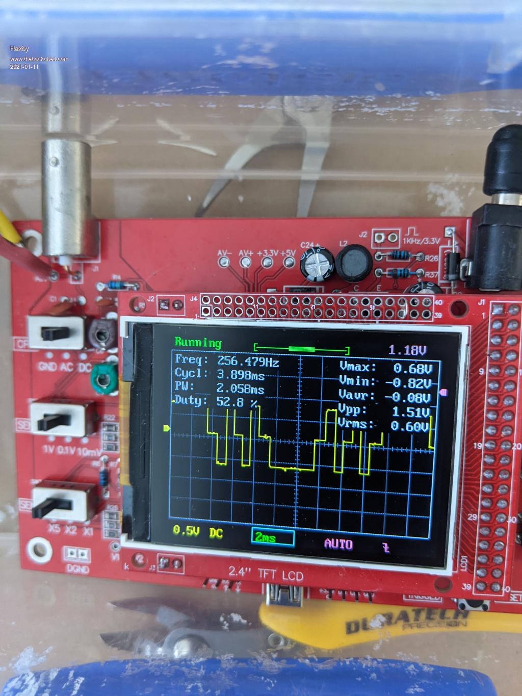

More popped igbts today I'm sorry to report!     .
I replaced the IGBTs on the second largest inverter, and checked all the MOSFET driver ICs. I found a bad hi-link power supply too.
Before connecting the transformers I powered up and took readings on the outputs. The second largest inverter output (with no transformer connected)shows this trace. Could it be the dead time capacitors? I'm using 10nF caps across the opto driver:
After replacing and checking components, I powered up with 330vdc, this time with a 1000w halogen bulb in series with the power supply to limit the current. The bulb lit briefly as the caps charged, then extinguished, then lit up again a second later as the inverter IGBTs shorted out.
