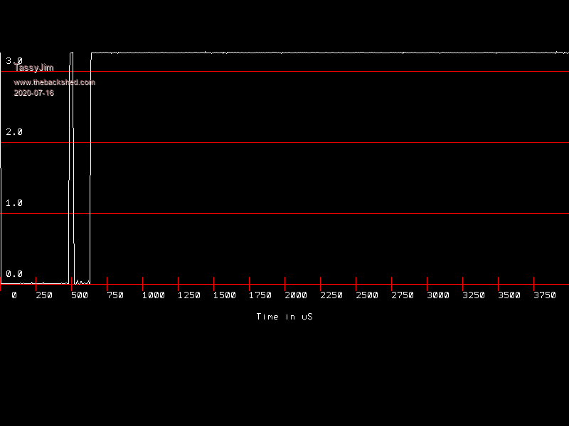

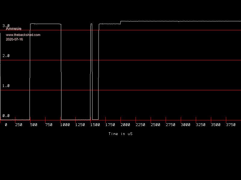

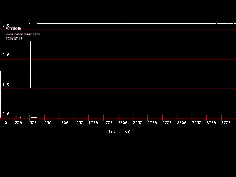

This program samples every 5uS starting form the first negative going transition
Sample from a 'good' DS18B20
It is encased and with a 1M lead.

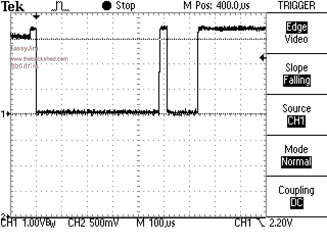

As a comparison, this is the same run captured on my CRO

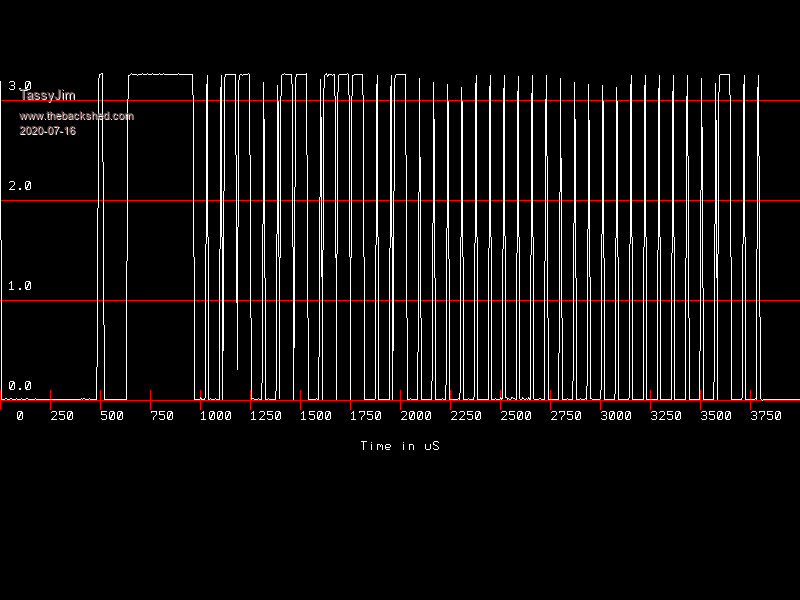

By changing the trigger to a normal TEMPR(42) read
 ADC OPEN 200000, 7,12,13,allDone
 ADC TRIGGER 1, -2 ' start reading when level drops below 2
 ADC START presence()
'  PIN(42) = 1
'  SETPIN 42, DOUT, OC
'  PULSE 42, 0.481 ' change this value for testing
'  SETPIN 42, DIN
x = tempr(42)
 DO
 LOOP UNTIL INKEY$<>""
We get
Not enough resolution to decode easily but enough to show that it works.
I really do like the background ADC capture.

  Quote  The next thing I will try is to see if we can measure the level that your devices are bringing the data line down to.
I suspect that they have a high impedance and are not pulling the line low enough for the CMM2 to recognise a LOW
Jim may well be correct in which case there is nothing to be done except try a higher value pullup - say 6K8 as a start. The low threshold for a STM32H743 is 0.4 * VDD - 0.1 so in our case 1.22V

So I have done some testing:
first I ran Jims tests, here are my results:
Then "By changing the trigger to a normal TEMPR(42) read"
I've done all readings multiple times, the result is always stable and the same.
After this I tested all kinds of pullups and even without pullup. Things got worse here.
Without a pullup I only get error readings (1000) and with values up to 30k I get false readings like 16.120 (instead of 22°C) - so the pullup @ 4,7k seems to be right.
After this I tested matherp's new firmware. But nothing has changed. The missreadings / errors in relation to the correct readings seems to be the same as before. So there are
some correct readings, but a lot of errors, too.
