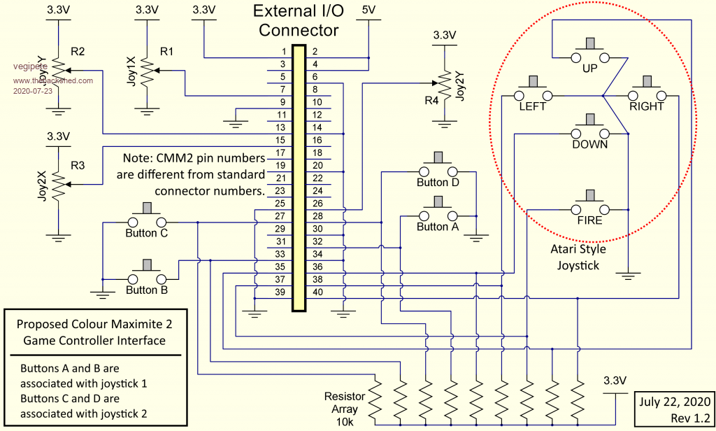

I took Bill's connector function diagram
  Turbo46 said
and turned it into a
CMM2 circuit diagram (hi-res). Hopefully I got everything correct. The only change is the addition of one extra digital input for the fire button of a standard Atari joystick, connected to pin 37. This keeps the digital joystick completely separate from the analog ones and allows the Atari joystick to function with only the end 6 pins (35 to 40) of the connector (plus 3.3V for the pull-ups.)
A note about 'classic' joysticks:
Classic joysticks, paddles and similar analog input devices, as used for example on Apple][ and IBM-PC computers, are a little bit tricky to use on the Colour Maximite 2. This is because the CMM2 has actual analog to digital converters which expect to digitize an analog voltage. This differs from the classic computers that had no such converters and instead measured the time it took to charge (or discharge) a capacitor through a variable resistor. As a result, the potentiometer is wired as a variable resistor and usually lacks the third wire needed for a voltage divider. At the cost of reduced precision, a suitable resistor pulling the analog input up or down as required should work.

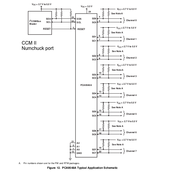

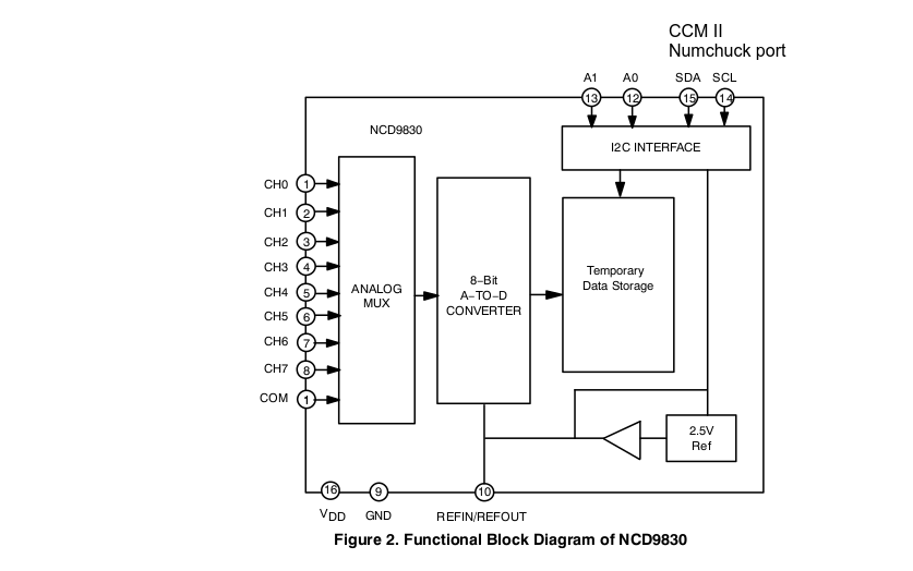

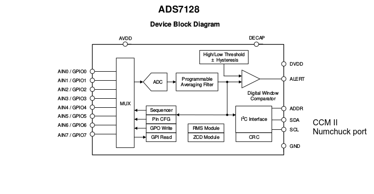

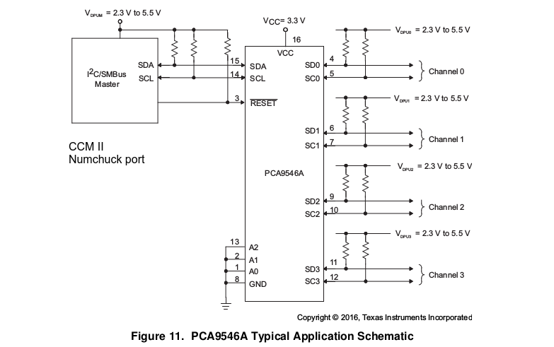

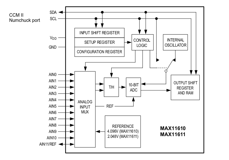

Ok here is my ideas for using the numchuck port for all game controllers.
4 ports
8 ports
xyz and buttons
I think you get the ideas now
one more
         Mouser  Digikey  Newark
ADS7128    $5.95  $5.95
Max11611   $5.10  $5.06    $4.92
NCD9830    $2.91  $2.92    $2.91
PCA9548    $2.36  $2.36
PCA9546    $1.63  $1.89    $0.828
TCA9546A   $1.32  $1.32    $1.32
may be a sub library i.e. controller drivers
this leaves the back Interface port open for better things.
have FUN and be SAFE

  vegipete said  I took Bill's connector function diagram
Regarding the pull-up resistors for the buttons - do you want these even though the CMM2 has its own pull-up option for pins?
For arcade controls people may want to support multiple buttons with the digital joystick. I might go with the original A&B, or A,B,C and D in that case. I think it should be easy enough to support that in one set of code with support for your one button joystick, at least for one player games.

How about a board that connects to the I/O connector, and exposes the unmodified side of the I2C inteface on a nunchuk PCB section, so it's easy to add one extra classic controller using the existing software standard, but also uses a multiplexer to support more controllers if the software supports it?
Your idea seems good except that it doesn't support the existing standard for adding a second nunchuk/controller. At least so long as the additional software support is easy to write in basic.

  capsikin said  Regarding the pull-up resistors for the buttons - do you want these even though the CMM2 has its own pull-up option for pins?
External pull-ups guarantee the pin state even on power up, before optional internal pull-ups can be turned on. Just to make sure.
  robert.rozee said  be aware that using pin 40 is not safe. if it is grounded at startup the CMM2 will erase option settings and (i believe) any user program in flash.
Pin 40 held low on start up is a bigger problem. An Atari joystick held to the right erasing the option settings is less than ideal. I would suggest the start up firmware could be changed to look for a link between pins 40 and 38. If one of the pins tracks the highs AND lows of the other on start up, there is a good chance they are jumpered together - deliberately.

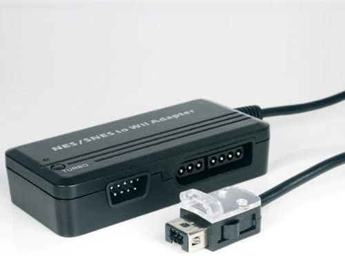

Check out this addapter.  I have no NES of SNES controllers but have a crap load of PS2 and PS3 controllers.  I got one of these just to test it when I get my CMM2(Still waiting PATIENTLY!) It could be good.  It maps all the PS controls directly to the corresponding on the WII clasic. I have some old favorite PS controllers I would love to use again.
https://www.amazon.com/gp/product/B002OJ8S7C/ref=ox_sc_act_title_2?smid=ATVPDKIKX0DER&psc=1

Any interest in picking a different pin for digital right?
Maybe pin 37, give up having separate buttons for the digital vs analogue joysticks, and also it's "COM1: DE", I don't know if that's important. I won't do this if you're keeping it for the digital joystick button vegipete, as that would make the code incompatible.
Maybe pin 31, which is also the PWM 2B pin (and the PWM 2A pin is already used for digital down)
Maybe pin 29, which is also the PWM 1C pin (PWM 1A and 1B aren't used in this
Of these, pin 31 is 5 volt tolerant, pins 29 and 37 are not. I don't know if that's important. The original atari joysticks/interface were supposed to have a 5 volts supply.
There were some other pin ideas I don't like:
Use pin 32 or 33 for digital right, leaving one less joystick button.
Use pin 27 or 28 for digital right, leaving one less joystick button, and also you need some detection code to tell whether they are an analogue or digital joystick or a nintendo controller (otherwise you can just run both the code for the nintendo controllers and for the joysticks using separate pins, until you need the 4 buttons for the joysticks).

  lizby said
At what point is the grounding of pin 40 checked--is it by some waveshare or on-chip firmware, or is it in MMBasic. If in MMBasic, could there be a prompt at startup asking if the user wants to do the erase, with perhaps a timeout of some period in case part of the problem being corrected by the erasing is lack of connection to console?
Perhaps if the erasure is done, a restore image could be written to the SD, with a notice on rebooting after erasure that OPTIONs, etc. could be restored.
One of those might also help, yeah.
