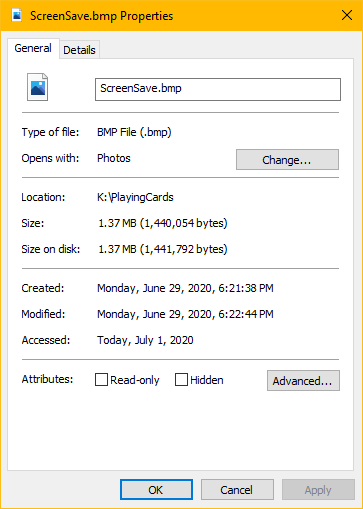

Posted: 09:31pm 01 Jul 2020
  CircuitGizmos said  What size is the file?
The resulting BMP file, after impatiently waiting for ages, is 1440054 bytes, as reported by Windows:
The image is 800x600 pixels.
Posted: 09:48pm 01 Jul 2020
  vegipete said  Has something become broken in the 'save image "filename"' command?
Never mind, I see it just takes a while to save the full mode 1,8 screen: 65 seconds!
It takes my system about 6 - 7 seconds to save in any of the mode 1 screens.
Running latest beta firmware but I never noticed any slowdown in any of the firmwares.

Posted: 11:29pm 01 Jul 2020
I was using a 2GB card which gave the 6 second save.
I just tried a new 16GB card and had to change my setting to OPTION SD TIMING CONSERVATIVE
Now the same 800x600 save image takes 2.06 seconds.
I would look for a new card.
