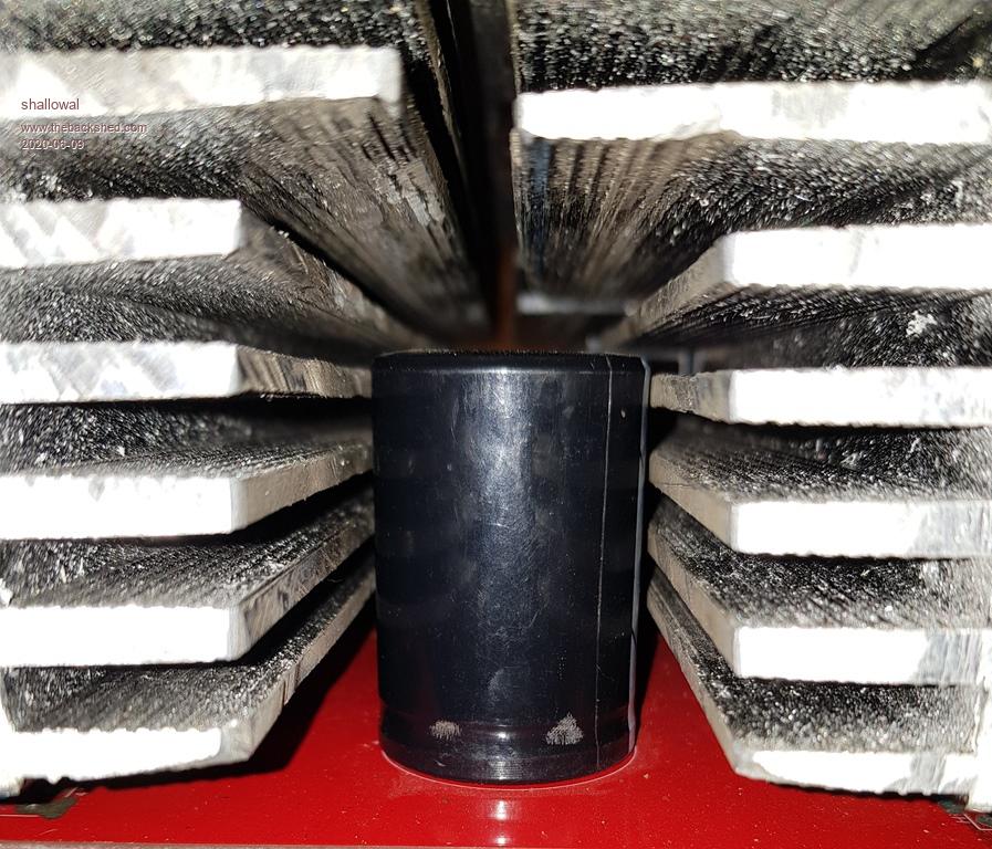

I think I discovered why I had that last blow-up.
Allan

Looks like it needs a bit more clearance between the heat sink and capacitors...would help a little with airflow

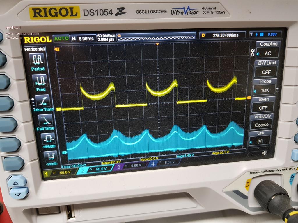

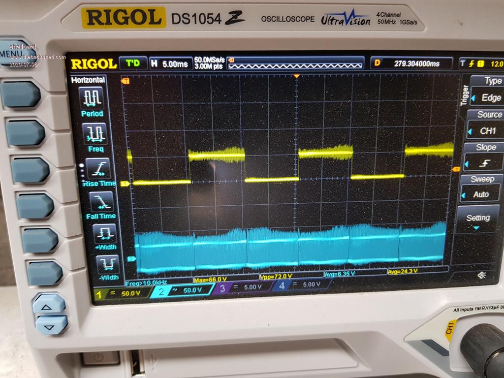

So by using the current limited power supply I discovered that I had a damaged through hole on the Drain of one of the Mosfets, so essentially no connection, and the replacement IR2110 had a faulty output on pin7 thereby preventing the chargepump voltage buildup. Looked good without the powerboard, but was all but zero output when loaded.
So now I have got to the point of installing 8 FETs, but no caps and connecting the toroid and examining the waveforms.
Is that fuzz on the bottom caused by an underrated choke?.
Or is there something else happening somewhere?.
Allan

Fault finding after a mishap is often the most difficult part of the project, trying not to burn up all the new components and work done in the process.
Can't say I have seen a fuzzy trace like that yet, but I also don't have Good DSO that would have a fast enough sampling rate to see it.
I'm not sure if the choke (if underrated) would be doing that, what I did last time at this stage, was to put 1 small capacitor back in (think it was a 120uf all that was handy on the bench) hopefully not big enough to damage the fets if something went wrong, it was just a small effort to help stabilise the DC supply on the power board bridge.
Anyone have a different view on this?
I will also be doing the same test regime in a week or so...

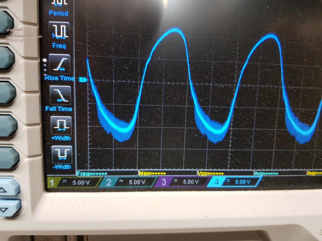

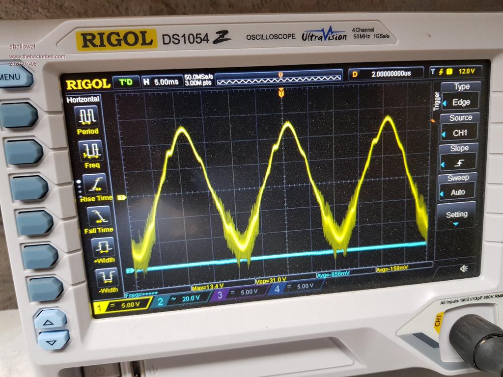

8 FETS installed, unrestrained battery, No Caps, no load.
Unrestrained battery, No Caps, approx 1200 Watts load.
I'm measuring at the output of the voltage feedback transformer.

Trying to interpret what I can see on the SCOPE pictures, the little wobble just below the peak of the wave could be an effect from the load applied and I expect it could be fixed or improved with some adjustment of the choke, air gap or something, not sure what you have there already. I do like the laminated steel cores myself.
If you still only have the 475 polyester film capacitor in place, I wouldn't push any more load on it than that 1200w.
Now the fuzzy beard bit I'm not sure about, Could it be your scope is picking up noise from something?
Also it appears more fuzzy on 1 half cycle than the other, makes me think one leg on the bridge is not working properly, I hope this is not the case.
I assume the 2 high speed diodes uf4007 (CR25 27CR) are ok. Don't know why I'm thinking about them.
I'm no expert this either.
Are the capacitors around the totem pole drivers Ok?

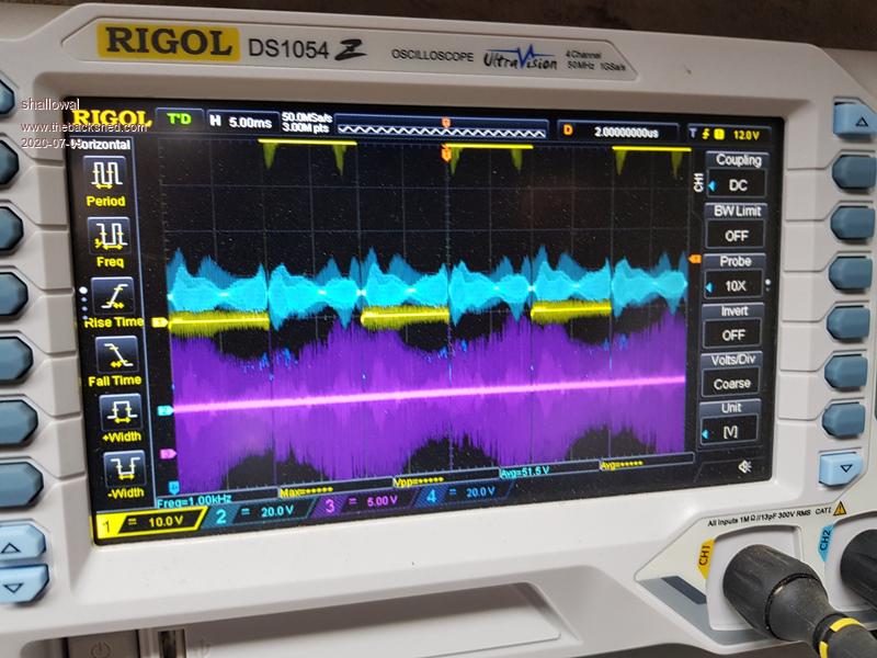

I'm pretty sure the problem is with that 5 volt rail on the EG8010 (purple trace), but now I've blown the EG8010 chip so will have to wait until LCSC ship me the spares I ordered a couple of weeks ago.
Allan
