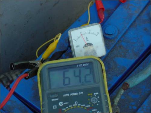

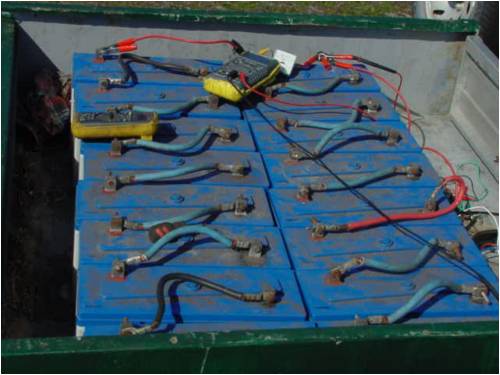

Update:
I did some work for a fella who needed a few kilometers of trees pushed down to allow his overhead wires to go to his house and get grid power.
As it turns out, the grid was duly put on, and I thought no more of it, he paid for the fuel and hydraulic oil and transport ... no problems........the months tick by......
Yesterday, he fronts up with a utility full of 125 AH 6v yuasa batteries (UXH125-6).... 16 in fact.... 48v@250AH. as a thanks for helping him out ...... with a grin from ear to ear.
So I quickly put them on the end of the chainsaw blade mill to see just how stiff the windings actually are.
Here are the new gifts...

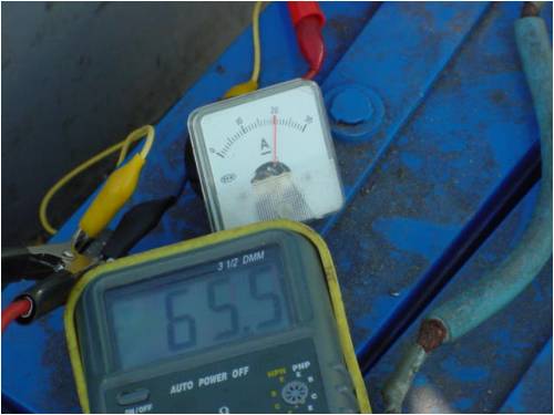

It was another clear day with fairly light winds with a few gusts from time to time. Mostly it sat around at this level (500-600watts or so)
Now and again a decent gust would come along ,but only lasted for a minute or so then go quiet again (500w) .. a 1300watt gust looks like this:
A decent gust came through which lasted for about 2 mins, and pushed it up to 31 amps at 70.6v.. or about 3 horse power in the old money. (2100 watts).... and the camera was back at the shed.
The way the mill pushed up the battery voltage I think shows just how low impedance this alternator really is, or how rapidly it charged them up to fullish, and then pushed them up fast.
Now when I drive past a pine tree, I look at it a bit differently.... how big a blade could I carve from that one ..... etc...
Now, I just need a decent load for it to drive.

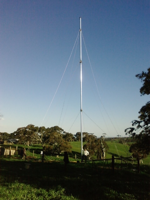

PS I attach a photo of a good tower for your mill.
19m high and 150mm Gal steel. check the relative height of a person.

I do like the tower, I have two 12m lengths of 7"x1/8" wall galvanised pipe for mine.... If I'm developing this kind of power at ground level on nice days, I should have plenty to go around when I'm high in the air.

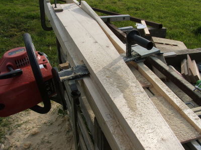

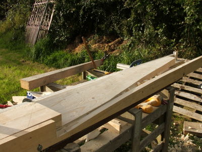

Well, our friends in Ireland have had a go at this chainsaw business, and done a way better job than me at it.
Check this out.... Irish renewable site
and this photo collection. The man did some magnificent jigs.... I've been shamed big time...
pictures of the jigs etc
There was also a picture on Hughs site of another fellow in Ireland building them at one of Hugh's classes at Galway...I think, but the picture has moved somewhere else..
These blokes have taken it to a new height methinks.
And with improvements like handles on the blade slide jigs too, and roller bearings on the side...... WOW
The finish is beautiful, and the twist is complex not just simple like mine was....
I've been made redundant already.... sheeesh.
........oztules
