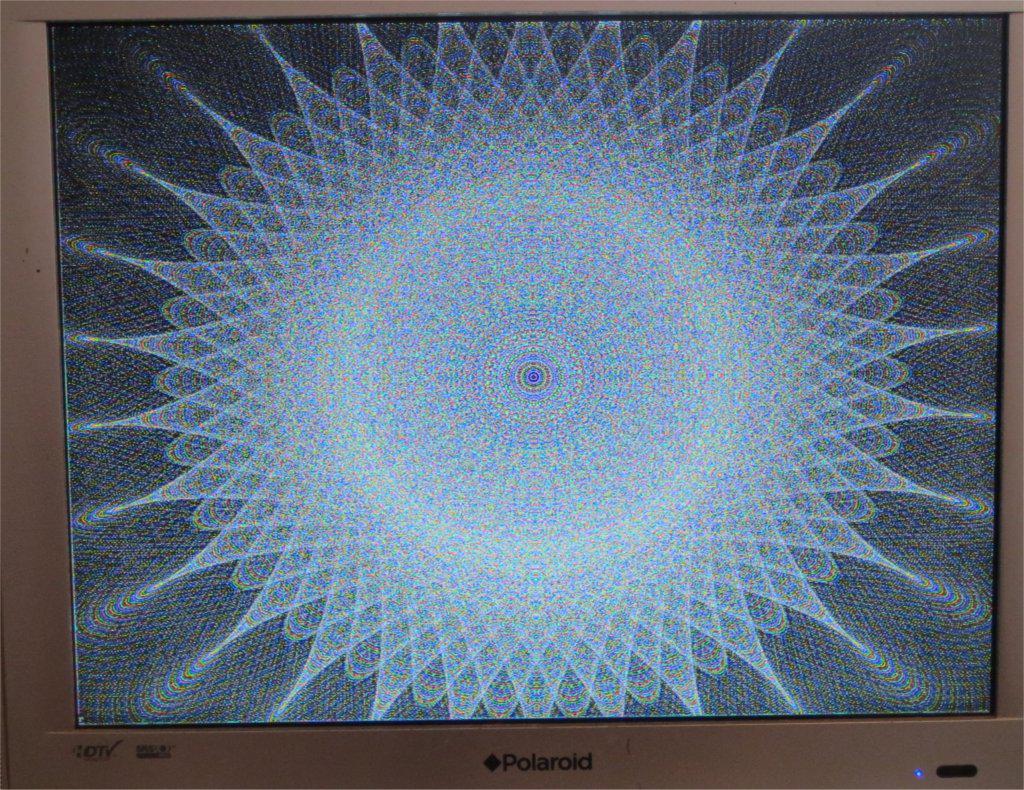

Here is RPI-ZW output from MMBasic to my ancient 15" vga monitor using this HDMI to VGA converter:
The picture doesn't do justice to the clarity of the display. (I needed a mini-hdmi to full-sized hdmi cable to connect the converter to the RPI.)

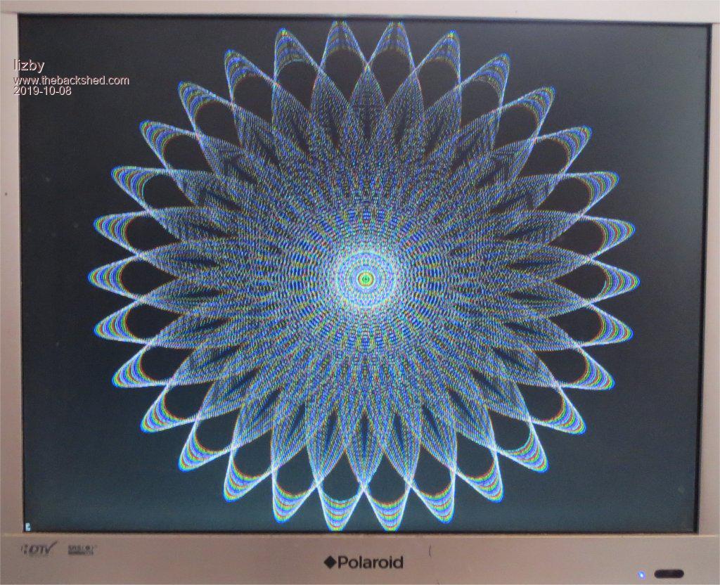

Here's the hdmi->vga output to the 15" monitor running matherp's spirograph program.
And after it had run for a few minutes.
See this thread.
I used "a=600: b=340: p=80" and, when prompted, inc = 4.
mm.hres is 1280, mm.vres is 1024.
