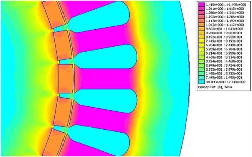

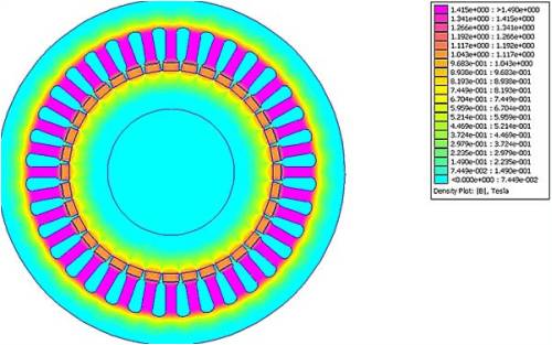

I reconstructed the stator, rotor and the magnets to actual dimensions/shape and also scaled the entire assembly to real-life and was impressed with the results.
I scaled the magnets to dimensions of magnets available from Ebay (10mm x 10mm x 30mm) that matched the stator tooth contact of 10mm.
The reason for the big difference between the picture below and others I previously posted is that the magnets are seated into the rotor by about 1mm only, rather than being fully seated and the re-design to actual real-life dimensions helped substantially (cheers Oztules for your pointer). The flux is directed to the stator where I want it.
The picture below is of a 36 pole set up with an iron rotor. I will be uploading the result of the 12 pole setup once I have decided on what magnets are available from Ebay that best suit the scale of my unit.
Not too long now I feel before I get a rotor to play with
Edited by CraziestOzzy 2008-08-12

Looking very slick I must say.
I like it a lot. Your max flux is almost the full depth of the slot, you can't do much better at directing your flux than that.
In truth I think you are saturated... (which is a good thing). Dinges knows more about this than me, but I like it.
Looks like 1.4t in the slot arms, the sort of flux I only dream about in a duel axial flux.

Looking good indeed. Not sure if the stator saturation is a good thing though, I thought it would introduce extra losses in the stator as the reversing magnetisations of the saturated teeth developed extra heat. Not 100% sure though, maybe others can chime in.
On the other hand, you haven't modelled the stator wiring as well. Under load the statorcoils will develop a reacting, opposing magnetic field that reduces flux density in the stator tooth. By how much ? No idea. I haven't tried to model this effect yet.
Would be nice if you managed to find out how to and then post it in here so I could learn how to do it too...
BTW, are you sure your dimensions are correct ? If those are 30 mm magnets and you have 36 of them, that gives a circumference of, say 30+5 =35 mm/magnet; 35*36 = 1260 mm, which gives a rotor diameter of about 400 mm. This sounds like it's much larger than the 7.5 hp motor you were talking about in your first post in this thread.
400 mm diameter rotor... My 10 hp conversion has a diameter of 130 mm... Either I'm missing something or that's one monster of a conversion you're planning to build.
Edited by Dinges 2008-08-12

ummm, the dimensions of the mags are 30mm deep
I can't get a handle on which order to put what, just to say the area dimension of the mags here are 10mm x 10mm...the 30mm is heading away or towards you to give the 3D depth. My original rotor from the motor was 139mm in diameter. The stator inner diameter here is 140mm...I am using a 0.5mm air gap in this project. A 40cm diameter rotor sounds great though, I gotta get one of those
I believe it is oversaturated too. Was thinking of using less powerful mags to compensate but figured more gutz is a good thing.
Co-incidentally, I am looking into a means of including the coils...one hell of a task to figure it out as I have only begun looking into this step. Will post my failure or success in this matter of including wiring and how to do it. Edited by CraziestOzzy 2008-08-12

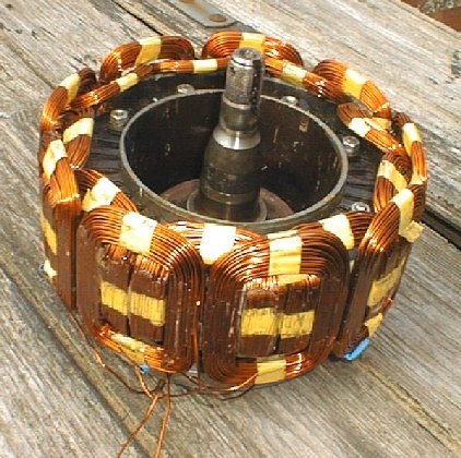

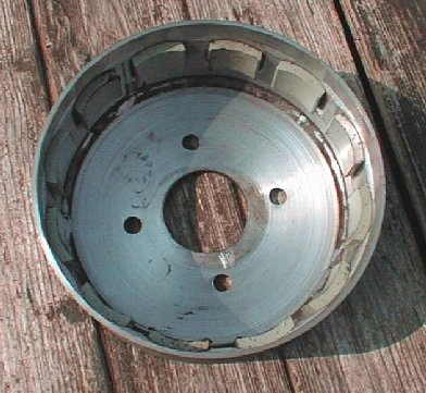

"As a question, how do you alter the iron stator dia in a rebuild. "....answer.. choose a different victim.
The only other way of changing dynamics is to put the coils on the outside of the stator and the magnets around them there like this: (courtesy of Flux)
and then build a drum for the magnets like this: (Flux again):
Beyond that I don't see any other obvious way apart from cut and paste each plate (cut sections out and alter the diameter) and re-assemble. difficult but possible.
.........oztules Edited by oztules 2008-08-15
