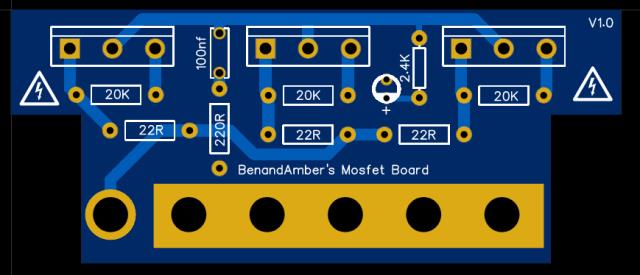

Ben, fair chance you'll need to drop the gate resistor by half. So Rg=22R.
You'll see plenty designs around here that drop it even further, as in Rg=10R. I note that the Latronics I have uses 10R but, all the Gate resistors are in series with a single 1R // diode.

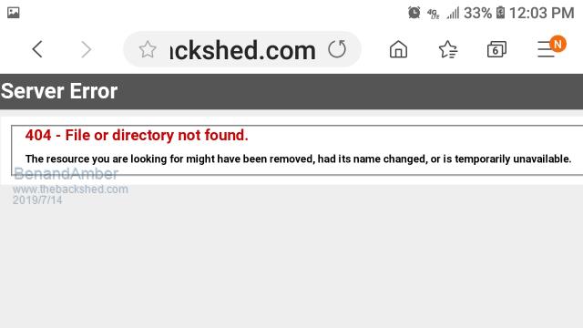

here's the screen I get when I click on the search function at the top of the screen
All information is really hard to find on here you have to read 4 days to find one little piece of information

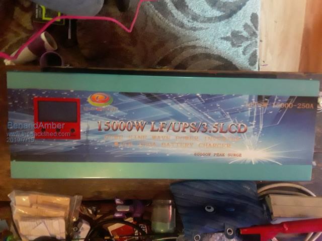

I have this inverter that I would sell
someone would have to be able to come to my house and pull the top off of it check it out try it out use it
then decide if they wanted to buy it
It is supposed to be new I've never used it besides just trying it out for 5 or 10 minutes
I would not ship it they get tore up in shipping too often

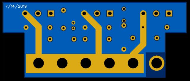

2019-07-15_133509_MosfetBoardV1.0.zip Here is the updated board

Posted: 03:36am 15 Jul 2019
That is absolutely awesome I really appreciate it

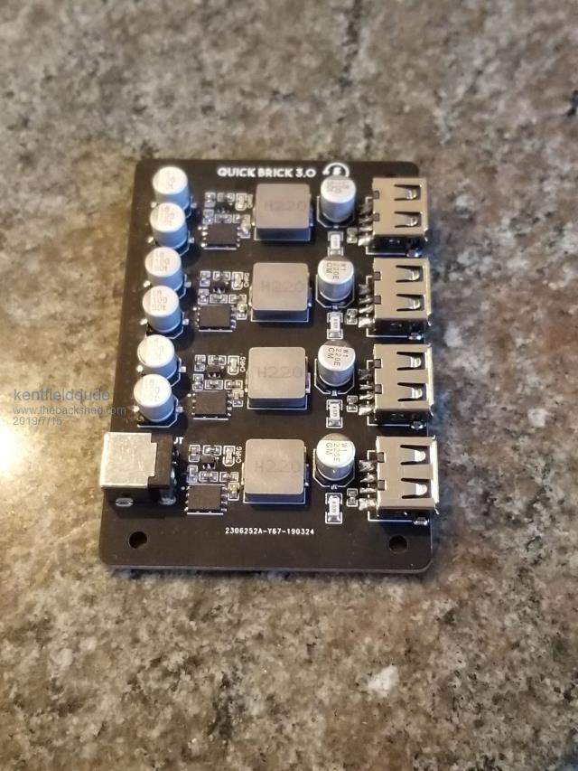

I made and designed this 4 port quick charge 3.0/apple fast charge usb charging hub. Capable of 3 amps on each port simultaneously.

Kent, That is a brilliant piece of engineering!
Ben, Unfortunately that inverter is nothing even close to 15KW. Those Toroid's are barely able to do 8KW if what I've seen on Youtube is correct? Now the really big monstrosity they have might be able to do 15KW for a surge, and do 10KW continuously. Gentry has been working with them and convinced PJ to reduce the 10KW unit to 9000 watts continuously. At any rate, I'm running a 12v system so am limited to 2500 watts. For 12 volts 3000 watts max. Anymore than 3000w and the amps get insane! This is only a temporary setup though. Eventually I am going to either 24v or 48v depending on how big I want to go with my system. 12v is a good system to get your feet wet.

I think Power Jack has since improved their 15,000w inverter but in this video the guy is only able to get 5000w out of it

Yeah I'm trying to talk Gentry right now I'm on private message with them right now trying to hit get him to become part of the site
His name is Sean and he's a pretty cool guy I told him he needs to be part of this site and I wouldn't trust that inverter for over 5000 Watts continuously if that
He sent me that inverter free of charge because he accidentally sent me a 230-volt 8000 watt inverter really good guyEdited by BenandAmber 2019-07-16

That is awesome Kent and the best thing of all they don't get to gouge you for one of their Chargers I've been wanting one something like you made for Android phone

Iron Maiden rewrap the low side and put a nano in this power jack I got
I think it would do the wattage you're looking for and maybe a little bit over
I really don't care if I sell it at all
it will have a nano one day I just figured I'd tell you I have it and if you was willing to come by my house and check it out try it out and liked it
then I would sell it but I don't care if I sell it
It was more of a I didn't want to see you pay a big amount for one

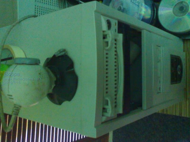

Ben, I wasn't going to spend a big amount for a PJ. I'm actually working on building a LF inverter into a old Gateway computer tower. I saved the PC tower for a DIY welder but have decided to build a Oz inverter inside of it instead.
The PJ stuff is interesting, But they are also quite disappointing. I always said If I got one, I would rip off the labels and repaint the dang thing so I don't have to see their crazy advertised wattage that's bogus.
