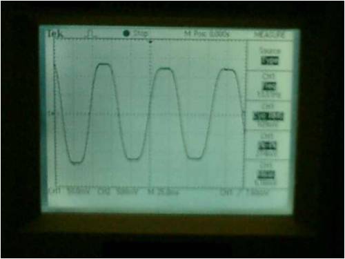

  Oztules said  Was 125rpm/v for a single six coil phase? (I assume AC rms.)
I should have more clearly described it in my previous post. There's a single-phase, single-turn wave-winding in there, the equivalent of 6 coils of 1 turn each. See image below:
Output was 1Vac at 125RPM (actually measured 0.5Vac handcranking at 63RPM, using a stopwatch and manual counting methods); I measured it using a non-RMS DMM and as the waveshape is not a perfect sine there'll be an error. The digital scope can measure RMS-AC and show waveshape so I may use that when making accurate measurements with the VFD test setup.
Here's a picture of the waveshape of the 10hp conversion (the variation in amplitude is caused by variations in RPM because of manual cranking):
It looks moderately sinusoid, better than I expected, even though there is some 3rd order distortion which is mostly manifest as clipping of the tops of the sine.

Hi dinges,
I will not speculate on harmonics, etc, or hijack this thread. The flat top of the sinisoid is caused by a period in the magnetic rotation where the coil arrangement sees a constant magnetic field. If you extrapolate what you have recorded further, you will end up with the waveform I have on my axial flux mill. One that approximates a square wave output, ie the constant voltage output approximates to 45% positive output time, and approx 45% negative output time. There is a total 10% transition period time where the output voltage reverses.

  Gordon said  The flat top of the sinisoid is caused by a period in the magnetic rotation where the coil arrangement sees a constant magnetic field.
Yep, that's the explanation I had in mind too, and it shows itself in the waveshape as 3rd order harmonic distortion :) I actually 'predicted' this from looking at the FEMM simulations, but in hindsight I had expected the problem to be worse than it is. 'Problem', I say, because it would be an issue when using transformers to transform output voltage. For battery charging it's not an issue of course, though I wonder if 3rd order distortion doesn't actually reduce power output, as compared to the situation where all electrical energy is present as a fundamental sinewave without distortion...
A square-wave can be synthesized from only a sine fundamental and its odd-order harmonics, so your axial flux has a lot of harmonic distortion too. 'Distortion' has a negative connotation to it, but it's probably not a problem in our applications (battery charging, or using resistive loads), as long as we stay away from transformers.

In the case of an alternator, the shape of the output waveform in relation to harmonics content is important only with transformation. This is similar with a mathematical representation as well [fourier transform analysis and the like]. I might suggest that in my alternator that the fundamental output is a square wave. Just because this can be represented as a combination of sine waves, does not detract that fundamentally this is the waveform produced. A transformer load is probably the only load where a single sinisoidal frequency is important, as you have mentioned as well. Power transmission companies may value this property, but if DC is the ultimate goal, then I would opt for the square wave. A conductor will have the lowest loss, only when the average current and the maximum current are equal. This does not occur with a sine wave. Power generation and transmission, with a sine wave property, occurs with an efficiency penalty. My F&P mill with series caps probably benefits from a sinisoidal output. I believe there is a tranformer action occuring in this arrangement that allows this combination to produce more current. The alternator efficiency is probably lower, but the wind energy extraction of the complete system is higher, so caps will probably stay.

I wouldn't lose any sleep about driving a transformer with a squarish waveform. I strive to get a square wave whenever I am building a PWM. Transformers seem to deal well with the square wave (forced on us by the switching characteristics of the fets.. full on or full off).
I haven't noticed any woeful efficiencies from that quarter.... (unless I drive them into saturation... and then it gets ugly very quickly
Is there something I am missing here?

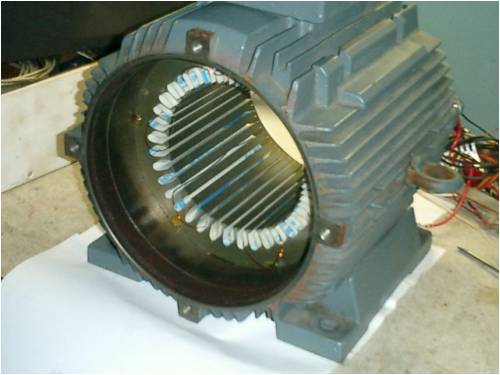

One question I must ask before I dive in: is that a picture of blue boy with all the wire taken out? Or is it the current 10 hp project? You haven't removed all the wire from this one yet, I hope?
My recent 7.5hp Toshi conversion is a PERFECT 48V wind turbine generator with its original wire. I'd hate for you to have to re-wire your motor just like it was before.

  Steven said  One question I must ask before I dive in: is that a picture of blue boy with all the wire taken out? Or is it the current 10 hp project? You haven't removed all the wire from this one yet, I hope?
That is the 10hp conversion with all its wire taken out, yes. The idea was to turn it into as good a generator as possible, regardless of amount of effort it took. So it was turned from a 4pole into a 12pole and now needs a rewind. And one of the goals is reducing resistance as much as possible (though I knew very little about the importance of that issue when I started out on this project). In short, a suitable cut-in (which I think was what you were thinking of) is a necessary but not satisfactory condition for a suitable generator.
BTW, w.r.t. Oztules' remark about resistance (if zero, the generator won't be able to break stall), he's ignoring the fact that we can easily add and remove resistance in the line; where it is not generating heat inside the generator. Also, once the generator is wound, it's impossible to change (lower) its internal resistance; but we *can* vary line resistance. So it makes sense to have as little resistance inside the generator, and do any resistance matching (when needed) on the outside.
  Gordon said  The original windings would probably be rated for 415VAC star, or similar. There is an approximate 10fold reduced output voltage to run at 48V.
It's even worse than that... it was originally wired for 690V in star (400V in delta). See nameplate:
http://picasaweb.google.com/motorconversion/75KWMotorConvers ionBlueMonster#5207081974285014674

Posted: 05:36pm 03 Dec 2008
I have just measured more accurately the RPM/V of the 'Blue Monster' 10hp conversion. The stator now has a wavewinding (just one phase), which is the equivalent of 6 single-turn coils per phase.
A few weeks ago I arrived at a result of 125RPM/V, using a stopwatch and manually cranking and counting the revolutions during 60 seconds while trying to maintain a voltage of 1Vac. Today I made a more accurate test which basically yielded the same resulting figure, 120RPM/V. Turns out there was only 4% error with the rough, manual test. Not too bad!
If anyone could verify my calculations for cut-in RPM I'd really appreciate it. I've verified them a few times myself but, well, since that little incident with the 500W-conversion (where cut-in RPM ended up at 1000 RPM instead of the desired 250RPM due to a calculation error...) I'd rather not take any risks. Don't want to end up with such an unpleasant surprize on this conversion... so if anyone could take the time to verify my calculations, that would be really appreciated.
1) is the calculation of the original slotfill (as motor)
2) is the determination of the correct turns/coil for the generator (with a RPM/V of 120)
3) is the determination of the max. wire thickness, based on the results from 1) and 2)
4) is the calculation of the current density of the wire back for the old motor
5) is the calculation of the power rating as a generator, based on the same current density (27A/mm^2, which is stupidly high, IMO) as when it was a motor.
Here is the scanned .jpg (600kB) of the calculations:
http://picasaweb.google.com/motorconversion/75KWMotorConvers ionBlueMonster#5275614109900425122
(clicking on the magnifying glass zooms in for more detail.)
Hopefully my handwriting isn't too illegible...
