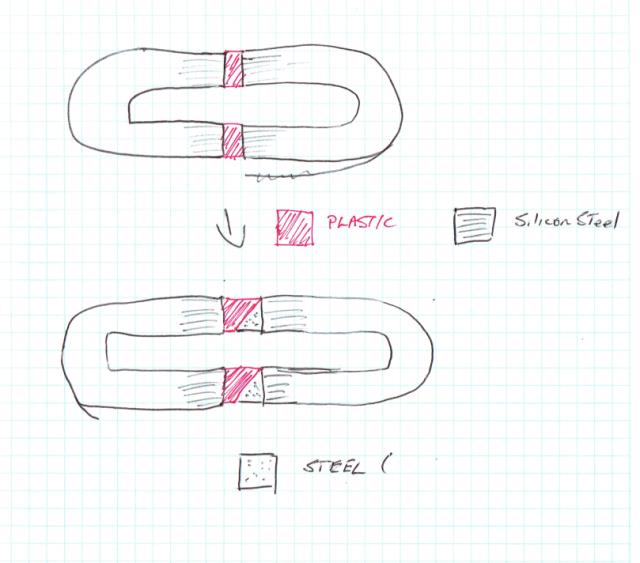

Is it crazy to use a small wedge of ordinary steel along with shaped plastic to fit into an existing choke?
Posted: 07:19am 26 Jun 2019
The air gap cannot be steel, whatever forms the gap must be non magnetic.

Tony, I didn't communicate that clearly.
If I have an existing choke and a wedge shape gap spacer can't be fitted; that I provide a wedge piece of steel (garden variety) to extend the face of the core in a wedge shape and make a plastic gap spacer to fit.
I imagine standard steel will saturate at a lower flux density which wouldn't hurt that much since it's facing the gap.
Swinging Choke
Am I wrong?

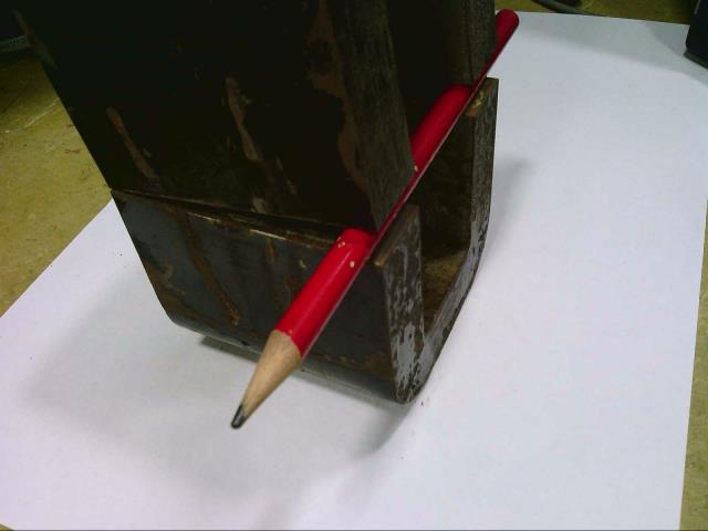

Ah, it suddenly becomes clear now, I understand your reference to a steel wedge.
There is an easier way to do it.
Here is a cartoonish parody of a giant air gap wedge.
The real wedge might be only 1mm or 2mm thick, and will go unnoticed when the choke halves are finally assembled.

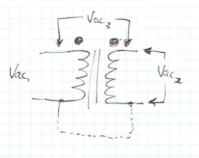

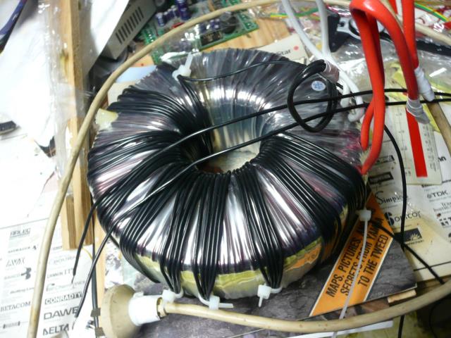

Transformer Polarity
Transformer Polarity is important with the WarpInverter. We have four transformers, some are adding voltage and some could be subtracting voltage. So polarity matters.
To show what happens when a transformer is connected in the wrong polarity.
In this case the second Largest transformer was of incorrect polarity.
This may cause some clicking and what not but doesn't cause any harm to the inverter. It can however destroy gear like this cheap AC power meter that uses a mains capacitor in its power supply.
Polarity Test Setup
We supply a voltage into Vac1, I use a transformer (below) that's large enough to energise these transformers, but at a safe voltage like 30Vac.
I also arrange the test so that I'm not sticking 30v in and getting 240V out. So feed in the 30V supply into the largest voltage winding.
So we arbitrarily assign the dot convention, I use red heatshrink or red tape or red wire to denote the Dot end of the winding, on both primaries and secondaries. Logically I use Black for the non-Dot ends.
Connect up the non-Dot end of the primary to one of the secondaries as shown in the diagram above.
We know when we have matched up the Dot ends of the winding when .
Vac3 = Vac1 - Vac2
Done, it's that simple.
You'll note that the transformer primaries are connect Red-Black, Red-Black .... and so on.
Also the secondaries are also denoted by Red and Black (well the small transformer had it's dot end marked by White tape just to be different ). This terminal block is a convenient method for me to play around with the secondaries.
I use the same 30v transformer to check the turns ratio.
Andrew

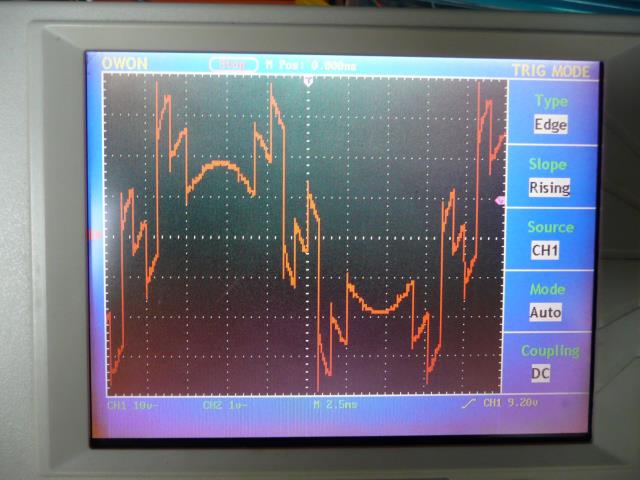

Posted: 12:20am 05 Jul 2019
The transformer phasing is not difficult to sort out, the waveforms either look good or go really strange. And its just a case of swapping a few things around until its right.
Edited by Warpspeed 2019-07-06

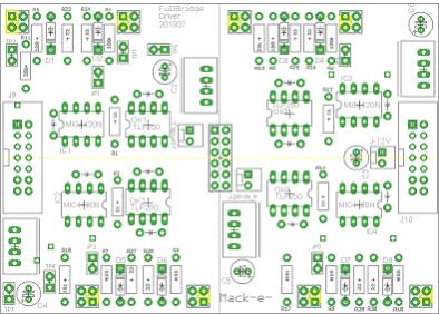

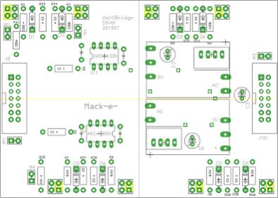

New versions of Mosfet PCBs and Driver PCBs available
Mosfet Bridge PCB (201907)
Just a heads up. I have updated the Full Bridge Mosfet Board to include (optional) SMD 100k pulldowns and have changed the 2 pin headers to 4 pin Headers. You can still put the 2 pin headers in, and is backward compatible. A 2 pin driver board will drive a 4 pin Mosfet board. I did this not because I had problems, except I found over time with all my experimenting and tossing boards about, I occasionally knocked the housing off. Put it back on and she was sweet. But I thought the 4 pin header is stronger and some redundancy would be useful.
MosfetBridge_201907 Gerbers
Github page
Driver Board PCB (201907)
I have updated both the Half and Full Bridge driver PCBs.
In my earlier versions, the means of extending driver boards like you would need to do for the Large Transformer was a little, um, messy with little cables everywhere. This was fine for me, and experimenting but I thought I would do something a little nicer and clearer.
On the Full bridge Driver board I have put a IDC14 connect on the left and on the right sides of the board. I have done the same for the half bridge driver boards. As you imagine the Full bridge receives the signals from the inverter board, buffers the signal, and transmits them respectively to their LEFT or RIGHT port. Non-isolated DC and Upper/Lower Isolated DC is commonly bussed over these ports. Each Driver board has provision for Isolated PSUs. The Half bridge boards have provision for either the small 1or2 Watt or the ACDC isolated PSUs. So where you have half bridge boards connected you are probably better off omitting the PSUs on the central Full Bridge Board and let the Half Bridge driver boards feed its Iso-pwr to the Full bridge boards.
The IDC14 ports are extended to both sides of the Half Bridge boards which allows them to be extended forever - sortof.
Driver PCB Github page
I hit the Update Post accidentally before I was done
AndrewEdited by mackoffgrid 2019-07-09
renewableMark
Joined: 09/12/2017
Posts: 1679
Posted: 11:21pm 08 Jul 2019
Nice work, I'm still trying to get my head around the connections.
What is the power supply on the full bridge driver board?
Cheers Caveman Mark

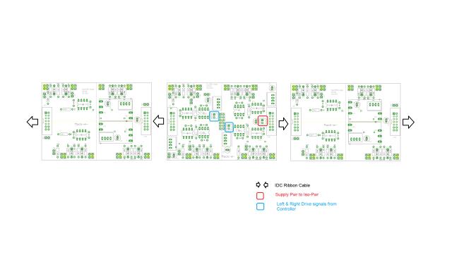

AS promised a diagram to show the inter-connections
I've included a Zip of the image file so you can get a better look at it.
2019-07-11_212127_ThreeAmigos-D.zip
+12V Molex
pin 1 ------ +ve
pin 2 ------ -ve
Left & Right Drive Signals
Controller PCB ---- Driver PCB
Pin 1 ------------- Left Pin 1
Pin 2 ------------- Left Pin 2
Pin 3 ------------- Right Pin 1
Pin 4 ------------- Right Pin 2
IDC ribbon cable is 14 way.
You can keep expanding Half Bridge Boards to the LEFT and RIght for as far as you want.
Andrew

renewableMark
Joined: 09/12/2017
Posts: 1679
Posted: 10:54pm 11 Jul 2019
Now I get it, combined with looking at the top and bottom of the boards with gerber viewer it makes sense.
With the 12v supply for the red connection what does that need to be rated for?
Cheers Caveman Mark
Off grid eastern Melb
mackoffgrid
Joined: 13/03/2017
Posts: 460
Posted: 11:28pm 11 Jul 2019
Cool. The PDF schematics should there as well.
Depends on how many driver boards in that cluster. You will generally use about 1 Watt. So you are only needing about 100mA for that connection. In my case I use about 4Watts for all my driver boards and I use a $1 LM2596 AliExpress Buck converter. I imagine, in a 48V system one of those 5W (maybe two or a slightly bigger one) ACDC converters would be used to provide a general 12V supply.
Again in a >= 48V system, the driver cluster that drives the big transformer; it could be convenient to use those ACDC supplies on the Half Bridge boards, omit the little PSUs on the Full Bridge Board, and feed battery voltage into where it says 12V. I should probably call it Vin.
Andrew
