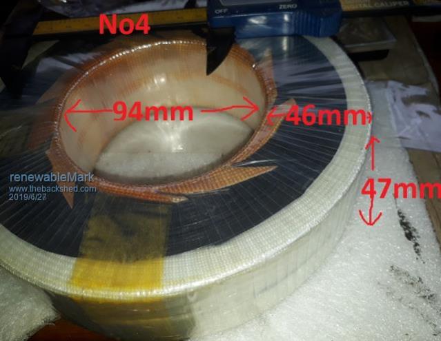

Thanks. I try not to strip all the wire off my cores, where possible I re-use existing windings. So my core dimensions can be a bit of a guess sometimes. All your figures are useful to me including the num Turns you've provided. (I presume Tony worked those out?)
Andrew
renewableMark
Joined: 09/12/2017
Posts: 1679
Posted: 07:35am 27 Jun 2019
Yes, Tony worked all those out based on my cores.

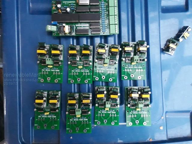

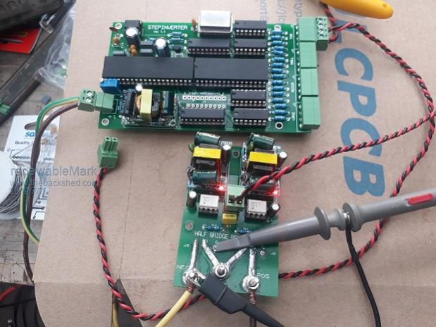

Almost finished the driver boards.
Tony, if I fire the control board up connected to the driver boards I should see square wave signals from the gate pin on the driver board right?
Cheers Caveman Mark
Off grid eastern Melb

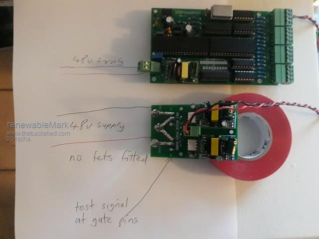

Posted: 09:42am 03 Jul 2019
Should all look like this. The wires all fan out logically.
I don't have pictures of the individual gate drive waveforms here to show you, but you should definitely be able to see the drive to each mosfet gate with respect to its corresponding source.
Only try to do that without any mosfets fitted !!
If you ground the source of the upper mosfet with a mosfet fitted, it will go bang.

renewableMark
Joined: 09/12/2017
Posts: 1679

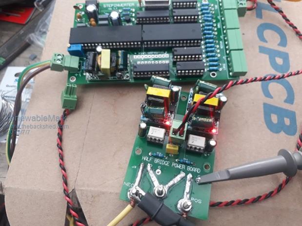

Posted: 10:39pm 03 Jul 2019
So wire it like this and it should show signals at the gate/s?Edited by renewableMark 2019-07-05
Cheers Caveman Mark
Posted: 11:04pm 03 Jul 2019
Yes Mark, exactly like that.
Between gate and source pins of each mosfet you should be able to see the gate drive waveforms.
There will be a red LED that indicates that the small supplies are up and running.
Then fit the two mosfets, and you should be able to see something that looks pretty much the same, but switches 0v to 48v on the TX pin.

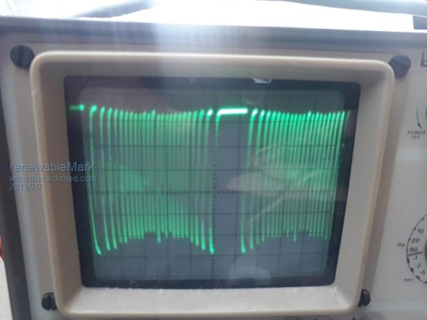

Posted: 03:59am 07 Jul 2019

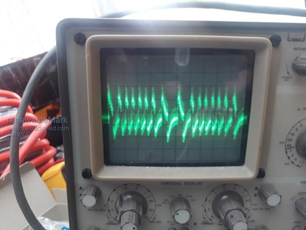

Tiny torroid, left gate.
Tiny torroid right gate.

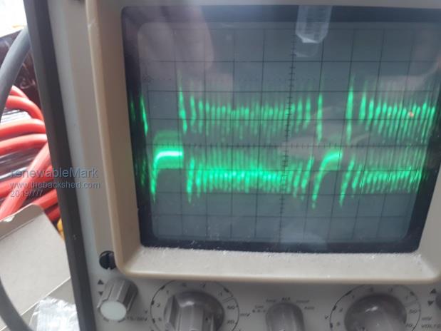

Right side looks a bit messy, can't seem to adjust the scope to get it looking clear.

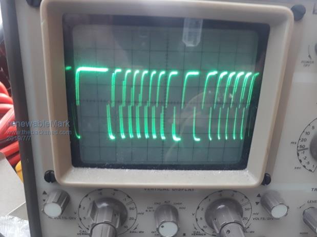

Small torroid left gate.
Small torroid right gate
Edited by renewableMark 2019-07-08
Cheers Caveman Mark
Posted: 05:06am 07 Jul 2019
First two pictures look good.
There is a problem with the next two pictures "right gate".
You need to measure between gate and source of the right hand mosfet which you are not doing. Move the probe ground to the central TX connection, which is the source of the upper mosfet.
Check your probe compensation, there will be a screwdriver adjustment either on the probe, or sometimes where the probe plugs into the CRO.

Posted: 06:14am 07 Jul 2019
Silly me, forgot to move the ground clip across.

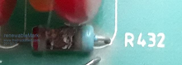

Plugged it all back in and the trace flickered and stopped, then started making a funny crackle sound.
Un plugged it opened it up and plugged it back in, a resistor was sparking.
BWD 826 50mhz, can't find a manual for it or parts list.
Cheers Caveman Mark
Posted: 06:43am 07 Jul 2019
Oh, that is very bad Mark.
BWD went out of business in the mid 90's and no longer exists.
Did an internet search for the 826 and came up empty.
I have a BWD 530A here and it took literally bloody years to finally track down the circuit diagrams for it.
Anyhow there is a guy at KevinChant.com that has the circuits for an an 820 and 821 that may be similar enough to be useful.
https://www.kevinchant.com/bwd.html
Look for test instruments in the left hand column, then hit BWD.
If you are really screwed, you can borrow my 530A and leave your 820 with me.
No promises, but as a very last resort there might be a very faint chance I may be able to fix it.Edited by Warpspeed 2019-07-08
Posted: 07:09am 07 Jul 2019
Found R432, its in the very high voltage section that supplies the CRT.
There is an excellent chance that this identical circuit board is used in all of the 800 series of oscilloscopes. Its 2M2 and would explain why it sparkled and arced over and the display flashed.

I think you are right, the 824 looks more like it.
R432 looks correct as it's across two caps.
I'll give that it's last chance.
