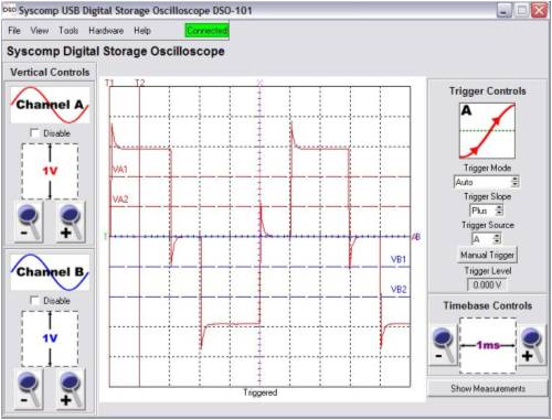

I have replicated Bryans test results. The capacitors are in series with the output, and not across the outputs. The mill is capacitor coupled to the load. I have recorded 19.5A @ 28.4V today, on many occasions. 550W, not bad for a standard 100S twisted poles in delta. I had measured a 5 degree temperature after an hour of operation, in the capacitors.
I will present some digital CRO outputs.
The first is the waveform between 2 phases on the mill side of the 230uF capacitors.

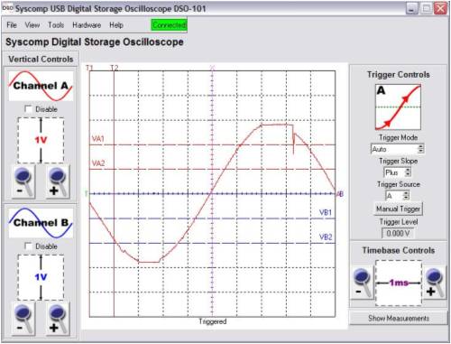

This was the output waveform after caps prior to rectifier, just at cutin speed.
The waveform is just starting to be held by the battery load.

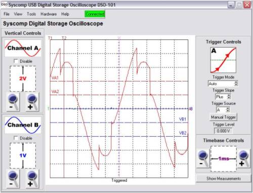

This is the output after the caps, prior to rectifier, at about 15A output current to the battery.
The series configuration seems to perform a VI conversion. I will not pretend to know exactly what is going on yet.

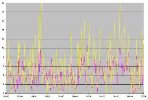

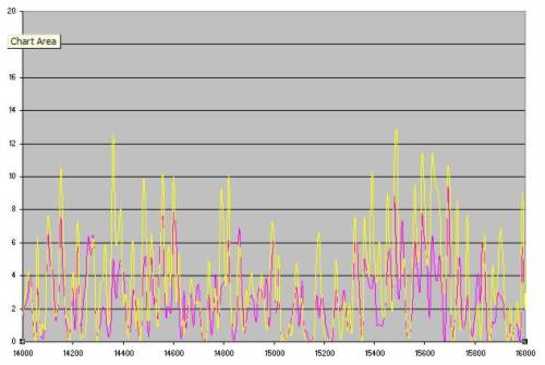

This is a comparison of before and after series caps on a 100S F&P in delta.
The comparison should be interpreted as the change in the ratio of the average of the F&P in yellow to the axial flux in purple. The F&P has 50% larger swept area.
Thge first graph is before caps with maximiser and the second shows the change in the yellow graph[F&P with caps], without maximiser. The ratio of the average of the data is the important detail.
GRAPH 1
GRAPH 2
The ratio in the first graph is 1.33
The ratio in the second graph is 1.46
The caps provide a better increase in average power than a boost maximiser.
There is a significant increase in the maximum power output, by almost a factor of 2. This would be of more use in stronger wind conditions.

The graphs are battery current vs time, for the same timing period. The wind conditions had changed, but the 2 windmills were operation in the same winds, with no wind shadowing and are only 6m apart.Edited by GWatPE 2008-09-23

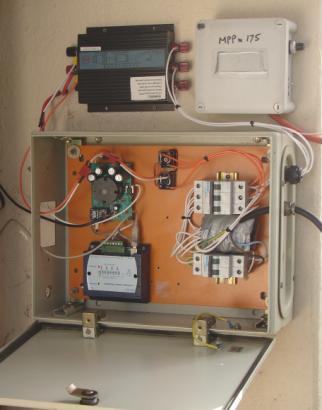

This is a picture of the revised windmill/battery interfaces.
At the top left is the chinese mill controller, used as an output regulator and main F&P rectifier.
The top right is the custom analogue MPPT and output regulator on my axial flux mill.
In the cabinet.
The mill output lead enters on the right. There is the mill shorting switch and above is the capacitor block and then the capacitor shorting switch. In the centre is the secondary rectifier for the boost maximiser, at the top left. Below is the 4channel data logger. The wiring allows the caps to be switched in or out and the maximiser can be switch disabled. The DC output exits on the left. The cabinet is placed to allow the lid to be used as a bench for a laptop etc.

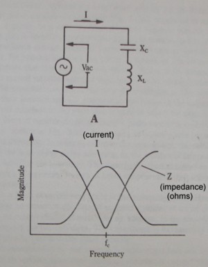

there was a lot of chat earlier about capacitors somehow producing current and there was conflict about efficiency etc, etc.
My theory is: the capacitors are not really about power factor correction. There is probable blade, wiring, iron eddy current and diode efficiency improvements. Current that would not normally be able to travel to the battery is stored in the capacitors, like a battery. This current is able to be transferred as additional DC through the rectifier action. The emf is able to push against the capacitors in a way that allows the rotor to change speed with the windspeed. The power from the increase in windspeed and then rotor speed, produces a higher voltage. Normally the current increases and there is additional voltage loss in the stator. With capacitors in the wiring, the voltage is not held down by the battery. This allows a lower current to produce the same power, and allows the rotor to accelerate and better follow the wind energy.
In theory above a certain frequency, the capacitor becomes a very low impedance. This will allow the load to then heavily load the mill. The extra current is probably related to this relationship. I will be performing some more tests with additional capacitors across the windings in addition to capacitors across the bridge rectifiers. I am unsure if there will be much benefit. Maybe only a few less switching spikes.
Gordon.

Help me read those scope plots, please: The flats in the second and third plots are at about 28-29V, correct? And the scale of the first plot puts the first peak at about 22V? The time scale gives me about 180 Hz (or is it 90?), so with your 230uF caps, that's a reactance of about 3.8 ohms (voltage lagging current, ignoring the rest of the system). What's the phase resistance per leg of a FP stator anyway?
If there are spikes of voltage as shown on plot 3, does that imply a large inrush current at that moment?

Hi sparweb,
20mS is 50Hz
these graphs were without a boost maximiser.
the 3rd graph is 5mS, or 200Hz, approx 18A 430rpm
the 2nd graph is 11mS or 90Hz, cutin 190rpm
the 1st graph is 5.5mS or 180Hz, approx 15A 380rpm

I have just simulated the cap arrangement on RFSim99 to estimate the inductance of the windings given the performance and the cap size used. I estimate the inductance of the 100S delta configuration to only be 2mH, not 8mH.
If I increase the inductance, then the frequency peak drops proportionally.
The inductance is the key element. Useful rpm is 100-400 for a F&P unit. This gives 50-200Hz AC output. I suspect that the 100S in delta is the only unmodified F&P stator that has a low enough inductance for caps to be of benefit. Rewires of other series stators is required. There is benefit of caps to lower voltage systems[12-24V]. Higher voltage systems ie, 48V, may not benefit due to the higher inductance of the stator. A rewired 80 series to 7S2P will have an inductance of 1/4 of the original stator.
A low pole machine with higher inductance can still benefit with caps, but these will need to be much larger to compensate for the lower frequency.
This is still not a quick fix for all machines. The inductance/voltage/pole count determine suitability and size of caps.

I suppose seeing how everyone is putting 2 bobs worth in there's no harm adding another amateurs view.
From my understanding the key is resonance. I see Flux beat me to promoting this though I see it in simpler terms and disagree on a couple of points with his views.
For those less familiar with this state I'll refer to this pic.
I see two major influences in this arrangement.
The first is a better matching of wind power with gen load. This is stage 1 of the idea I promoted on MPPT.
The second is increased power through lower resistance.
The first influence applies through a reduced generator loading at a non linear rate. this can be seen in the diagram as the impedance load reduces as frequency increases. In my MPPT proposal this was done by switching off the battery at a duty cycle that reduced as rpm increased. Here the generators high impedance reduces output at low rpm and increases it as rpm rises. this is equal to having a variable resistor in series and reducing it as rpm increases. We note the impedance drop off is not linear and whilst I have no idea if this is a perfect mathematical match of wind power it goes close if not. On this first factor I would not expect to see much change at low rpm perhaps a very slight rise in cut-in. I disagree with flux as caps being suitable for fixed rpm generation only as it's changing impedance is exactly in the manner required by wind power generation.
For the second influence I see a reduced impedance up to resonance. As has been stated time and again by someone oztules knows well, reduce coil resistance, get it as low as possible. Well resistance is measured in ohms, the same as impedance and this is not for some whimsical reason. Reducing impedance by adding caps to achieve a resonance at peak rpm is the same as reducing coil resistance as rpm picks up. I understand the high voltage peaks Flux warns of at resonance though disagree with runaway after that, at least no more over-speeding than would occur with an uncapped mill and that's why they all need furling, no more , no less. From the formula for resonance F = 1 over 2 Pi sqrt LC or it's derivative LC = 1 over 4 times Pi sq times F sq we can theoretically calculate caps for all series F&P.
One Thing I would do is not to back-to-back caps but rather connect and match to the rectifier diode's bias.
This may change the trace but more importantly not stress the caps with reverse potential and so increase working life.
