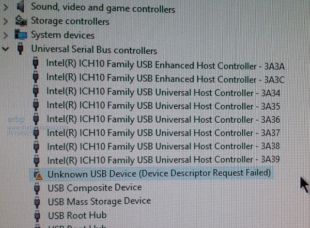

Got my board (and LCD screen) yesterday and have been trying to got it to work today. I got the firmware loaded ok after also experiencing some problems with the flaky USB connector as others have previously reported. But I cannot get Windows to recognize the Virtual COM Port after removing the BT1 jumper and changing BT0 to connect to GND. All Windows will do is report an error - see image below:

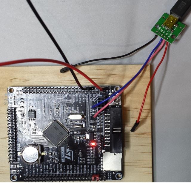

Initially I thought this was also due to the flaky USB connector but I have tried two computers and multiple USB cables (most known to work) all to no avail. I have even gone to the extreme of adding a replacement Mini USB connector - see below:
This arrangement has given a rock solid USB connection, and I have re-loaded both the original firmware file (2019-05-03_050415_ArmmiteF4.zip) and the updated one (2019-05-06_013740_ArmmiteF4) without any connectivity issues. Windows is quite happy to see the STM32 BOOTLOADER when the BT0/BT1 jumpers are set for firmware loading, but as soon as they are switched to just BT0 connected to GND - no USB connection!
I have also tried using an external 5v power source (actually connected when the above image was taken) - no difference there either.
I am thinking there must be something wrong with the chip or at least the parts that drive the non-bootloader mode USB.

BTW: If anyone is having trouble with the flaky Micro USB connector on the board and decides to add an outrigger one like I did (see the image in my first post on the previous page), there is an easier way than having to solder a couple of fly leads to components on the PCB. The USB D+ and USB D- signals use PA11 for D- and PA12 for D+ and these exist as pins on the J3 (right-hand side) connector - so you can just connect to them there using dupont connectors - no soldering required (well maybe at the replacement USB connector end).

After a bit of dorking around with st.com access and updating Java, STM32Cube ran but all was not quite well. The USB jack on the board is flakey and only works with certain side loads applied to the plug. Hard to type when one and a half hands are busy holding the plug just right. However, after some mucking about, I successfully programmed the firmware and played a bit.

Hmmmm, some careful use a small piece of emery cloth inside the USB jack on the board has improved the connection tremendously. Even the crummy USB cable provided with the boards works hands free now.
Corrosion is not your friend!
