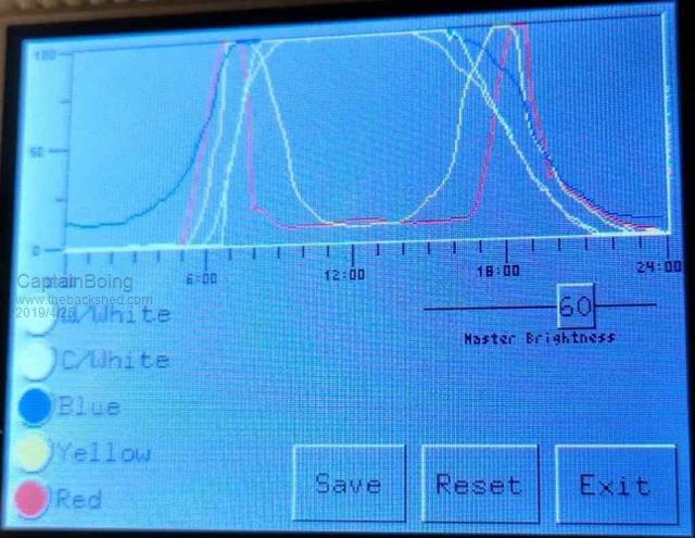

Agree with that. little 28 pin flat pack on my 1.5" square board does most things... several belting around the country in bikes as idiot light and rev-counter controllers and a hundred or so tucked away in the ceilings of Britain's snooker clubs (and a few in the loos too!)
Latest incarnation for a customer is an aquarium light controller that gives a graphic display of five different LED colours over time... the editor allows you to directly trace the curve of intensity over time to simulate night, dawn, day, dusk and night again.
all buttons and touch handling is hand-cranked. I avoided the inbuilt graphics buttons etc so as to get a pseudo Windows look to it. Job done I'd say. The buttons "animate" when pressed and the responsiveness is really good. If you trace the curve too quickly it will drop points but it can easily handle 1cm/s. The curve data is stored in strings in the Flash so as to get byte data a given time slot (PWM is 0-100) - actually two sets coz it provides two profiles, so 144 10 byte strings and a master brightness integer. Each time slot is six minutes and it traverses the PWM values smoothly from those in one slot to the next, so no sudden jumps in brightness. These values are then converted in real time to PWM values to drive the LEDs through five MOSFETs. works really well and 1000Hz PWM doesn't cause any interference when switching 1A per string or freak the fish (whose eyes may see the flashing we dont'). There is a bluetooth module going in (soon) that will talk to an Android app and allow the cycles to be changed etc... The thinking from him behind this is "yes I know I can buy this sort of thing commercially but they never work exactly as I would like so now I can tweak it to perfection and *when* it breaks, I can go in and fix it!" Agree with that... the ones on the market come from our Chinese buddies and are built to a function/price point that seems to result in them packing up after 6 months and becoming landfill because they are not serviceable. No more!

BTW @Captainboing, VERY nice project!!!!Edited by viscomjim 2019-04-27
why thank you Jim.
The software as seen here is working but incomplete. The editor screen is going to have a couple more radio buttons to select between Edit and Test. In test mode, you'll be able to drag across the graph and that state of the curve to be PWMed to the LEDs immediately so you can see in real time if the levels are what you expect... I found they seldom are. PSU is a laptop 10A@19.5V, so couldn't get the 30V ish required to drive 9 LEDs per colour in a single string, so divided into 2 parallel strings of 4 and 5 CREEs at 500mA each so 1A for 9 LEDs total per colour, well below spec to increase lifespan. Driving all LEDs at the same current, Reds and Blues are very intense and appear much brighter that the others, more apparent when you lower the current right down. So it is likely the profile will have to reflect that to get the total colour profile (i.e. what you actually get in the tank) exactly right - but that is config and not code so the customer will have to play with that, but being able to go straight in and test the profile as he sets it will be nice.Edited by CaptainBoing 2019-04-28

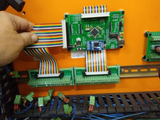

No doubt, mine is on order BUT I still love the layout and features of the E100.
I made a small boo-boo by having 40-way headers pointing upwards and the power socket interferes with the ribbon cable connector. I really don't care for the barrel-type connector so I pulled it and am playing with alternatives.

@Tinine
Looks good. Nice & neat.
Question. Where did you get those terminal blocks mounted on the DIN rail?

Dinrail mounted stuff is widely available, we used to use it by the palletload in the mining industry for control cabinets etc
Element14 (Farnell), RS Components both stock a wide range plus Ebay/Aliexpress of course

Didn't expect such high quality...really nice!

Didn't even have to make up the ribbon cables, they are nominally for the RPi, 200mm from CPC Farnell

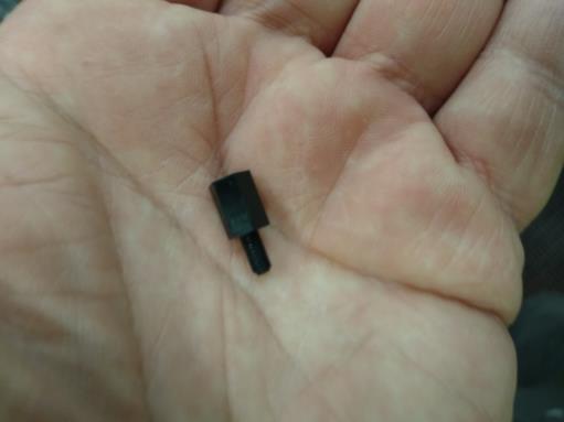

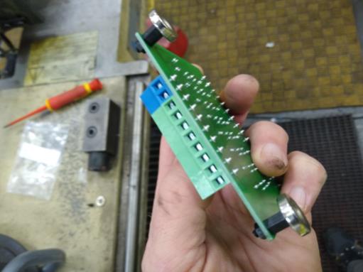

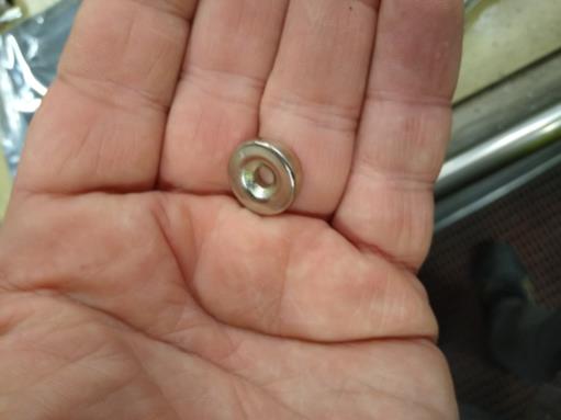

DIN rail...meh. I used it because it was already there but look at the feet for the E100 and the board next to it...
Neodymium magnet..
Nylon standoff..
Makes for very attractive feet and no drilling/tapping required.

  Quote  Neodymium magnet..
That's smart thinking.
I have used them at times including holding a small solar panel onto the roof of my truck, but never considered them for circuit-board mounting.
Just keep them away from the SDCard socket.

Clever!

Magnets,
Wow, Great idea..
Now how to stick to aluminium?
