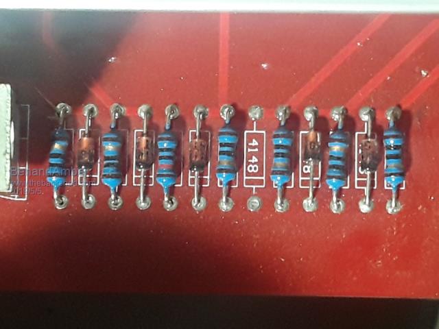

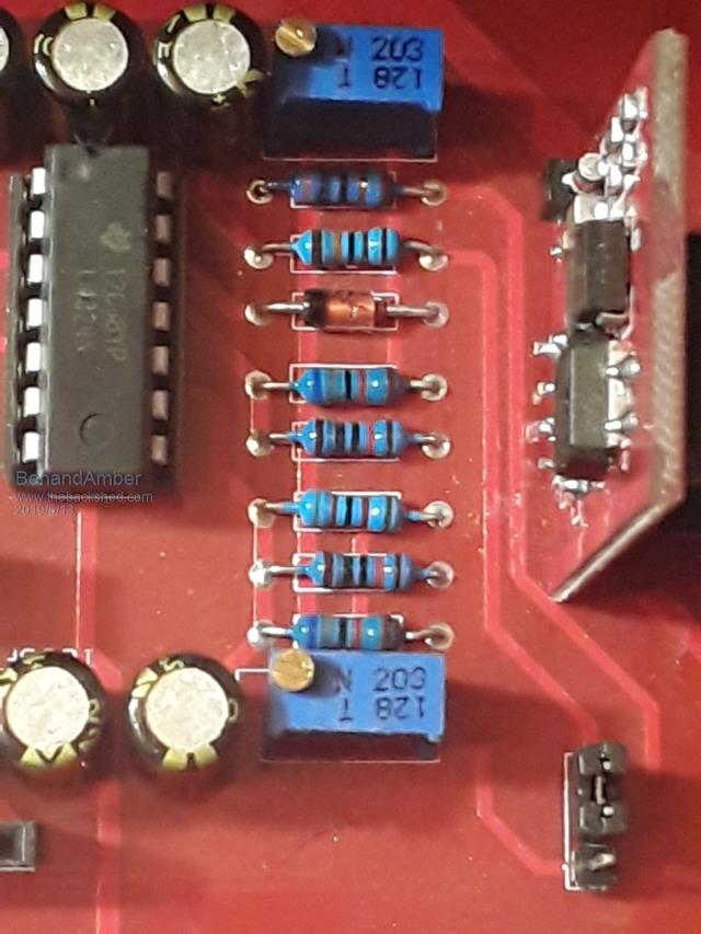

I was trying to wrap my head around how the totem pole drivers work and saw this
Can u see it
If so any suggestions
I'm not exactly sure what part number it is
I think I've read somewhere that diodes have different voltage drop across them
I don't know how it would affect it if I put the wrong one in thereEdited by BenandAmber 2019-05-06

Ben, is that your board with the missing part?
If so pick up a 1N4148 and solder it in.

Yes it's my 10000 watt board it was missing from the factory and I just caught it

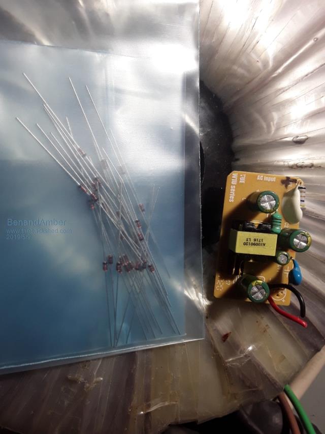

The diodes came in today
Thanks to renewablemark I knew what to order thank you much
Something that is a lot more interesting is right above those diodes
That is the board out of a 120 volt AC two 12 volt DC power supply or wall wart you know the kind of things that you charge your phone with
Poida the great brought this to my attention thanks by the way
So instead of having to wait for the slow boat from China we can have dc-to-dc power supplies
A lot of these Style wall warts work on DC as well as AC
I'm running a 48 volt system and I tried almost everyone in my house and they all work on 48 volts DC
This is absolutely awesome to know
Since then I've started reading about ladyN experience at running AC items on DC
I just thought I'd bring it up in case someone else didn't know
like I didn't maybe they'll see it on here and be as glad as I was when I found out

Does anyone know if the physical size of a diode makes a difference
The diode that's on my 10000 watt board is physically larger than the diodes I ordered
I ordered 30 1n4148 so I can change them all out if necessary
Posted: 12:33pm 09 May 2019
Ben, in this electronic tinkering business it pays if you learn to look up data sheets for components.
Its very simple, just type the number on the component into Google and sift through the 'hits' to find what you are searching for.
With diodes its principally the reverse voltage and the power rating.
Next is the forward voltage drop and speed.
You need to check those diodes if you blow up any of the mosfets, that often takes a diode out as well in my experience.

I couldn't make anything out on the diodes that are on the board
I even got mine 11year old son and he couldn't even make anything out
And I have a large magnifying glass
I bought 30 of the new ones just in case
I was thinking that I could probably change them all out if I had to
I'm sure the new ones I bought are the most common diode for this style board
You know how China stuff they just use what they happen to have on hand that day
I'm just wondering should I change them all which isn't a big deal at all
I still really enjoy fixing and soldering something and this gives me an opportunity to do so
I'm just really appreciative that somebody told me what to buy because I didn't have a clue
People like me don't know what they're doing and if somebody don't at least point us in the right direction then we don't have a chance
So moral of the story if people quit giving out advice people like me don't have a chance
If something isn't exactly the same it isn't anybody's fault
And it isn't a big deal at all it's all part of the fun of electronics
If everything worked out perfectly every time it would be no fun at all no challenge no fun.
And if no advice was given they'll be no use for this site
So a big Thanks goes out to those willing to step forward and give a little bit of advice you are much appreciated

Different suppliers will have different casings,
I have some rated the same and they are different sizes.
What is the link to the ones you got?
Cheers Caveman Mark

I ordered them from digi-key
I de soldered one of the diodes that was on the board and got a better look at it
it says 1N4148 on the side of it
So it is the same part number
Just a little bit different size exactly like you mentioned earlier in this post
I was kind of hoping you would tell me to change them all
I really appreciate your help renewablemark
It wouldn't have mattered to me if it was the same or not
I still enjoy solderingEdited by BenandAmber 2019-05-12

this is the one you got
looks fine to me, probably what I would have ordered.
Maybe one of the wise old owls could confirm.

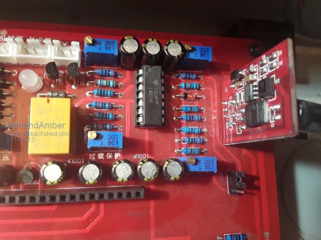

There is a little black jumper bottom right-hand side
Does anyone know what this jumper is for
I think it is for changing the voltage of the board
not sure which way the jumper should be for a 48 volt
Edited by BenandAmber 2019-05-14
BenandAmber
Joined: 16/02/2019
Posts: 961
Posted: 02:46am 17 May 2019
I got a hold of the people that I bought the board off of
they said it was for Factory testing
I need not worry about it
I don't believe it but that's what they said

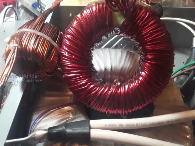

I was a little bit worried that the first inductor wire wasn't big enough compared to the Transformer wire
at the bottom of the picture there 2 a w g two of them so a total of 4 on the low side of the Transformer
I came across these giant chokes figured I could get more wire on it
so that's what I've done it has 16 in hand 2 mm wire 51 U h and I've already epoxy it
It shouldn't be too much longer till I get this one up and running
Haven't had much time to devote to it
Hopefully some of the greats are looking at this post and will warn me before I blow 24 mosfets if I've done something wrong
If the board blows up the first time I start it I plan on asking for some help to figure out how to make it a 12 mosfet boardEdited by BenandAmber 2019-05-18
