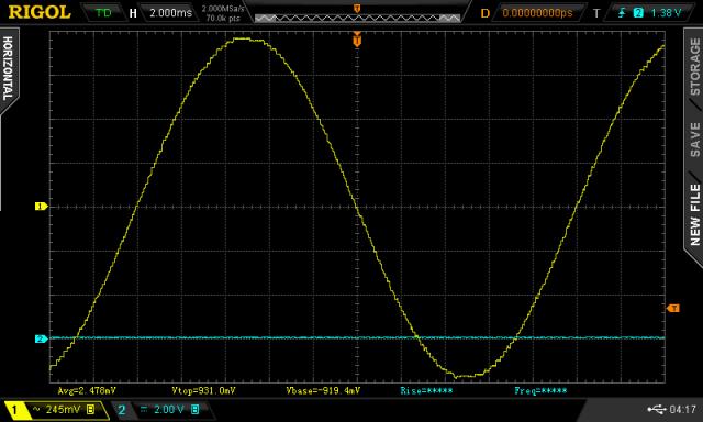

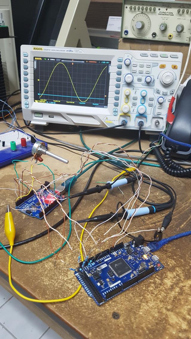

Mack:
Like you I used the Arduino Due to simulate the 4 transformer inverter.
here is the code, and I just put any inverter output into any of PORTC inputs
in any order. (eyesight is no longer useful when tracing thin wires)
I used 5K or whatever resistors to limit current when overdriving the Due inputs
to 5V.

It gives the expected stepped sine wave shape.
the hacker's hacked up hack:
video of how the various bits switch on and off, adding or subtracting their
1,3,9 or 27 units to the amplitude as I twiddle the pot. And it was synchronised to the blue trace squarewave at about 48.78Hz

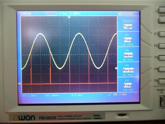

I've done a DUE based step Inverter Simulator:
You feed in the 8 non-inverted outputs of the Step Inverter (of any kind, whether it be an eprom based or micro based) and it scans it at a 10uSec sample rate. The input is translated into a voltage > 12bit value and is written to the DUE's DAC in real time. The image below is of my Eprom based board, but it could just as easily be the new micro based prototype.
The DAC of the DUE seems a bit noisy, and my DSO was syncing to small ~100khz transitions rather than the big picture so I made D27 go high whenever the input, 8 lines were all zero. The DSO liked to sync on that.
As Tony has told me, the good thing is you can vary the battery voltage, and watch how it changes. Etc.

Poida: talk about timing
Your Scope displays a much nicer image than mine.
I came at it from a different direction than you did. I started out intending to display a plot on an LCD, so implementing grabbing frames of data to export to serial and display. I decided I couldn't be bothered by the LCD and implemented the DAC.
I like the simplicity of yours and it shows more simply, how the inverter works.

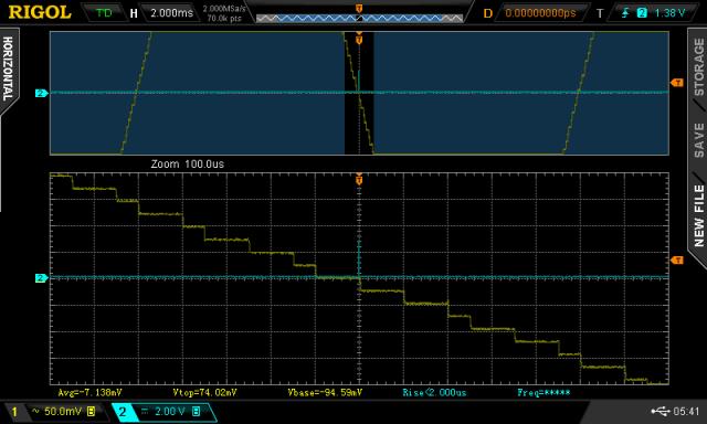

Posted: 01:58am 03 Apr 2019
I usually find the DSO of mine shows cleanest traces when I choose "High Res"
from the Acquire menu. This averages many samples together and then displays that one average value on the screen at each pixel's time value.
Eg maybe 640 pixels wide, time base is 2ms/div, 10 divs screen width
So a pixel might be about (2ms x 10)/640 = 31us each. The DSO might be sampling at 2M samples/sec, so each pixel is the average of 62 samples. This crushes noise.
Your DSO, OWON PDS5022S, does not have this high res mode. You do have 2 things to help. First, I would enable the HF reject on the trigger, under "Coupling" in "edge trigger menu". And I would use under Acquire menu, the Average function, maybe 4 or 16 averages. This should clean things up.
DSOs have shown to the great unwashed masses how much noise is present within a scope's front end. (just short ch1 with small wire and see the trace still appear "noisy".)
CRT scopes don't show it to human eyes very well due to each trace is showing the new noise, never overlapping the previous trace's noise. CRT traces look cleaner. Only 'cos we can't see the noise. It's there...
Maybe just for you and me, here is a closeup of the zero crossing, clearly showing the steps as it approximates the sine function at various times.
