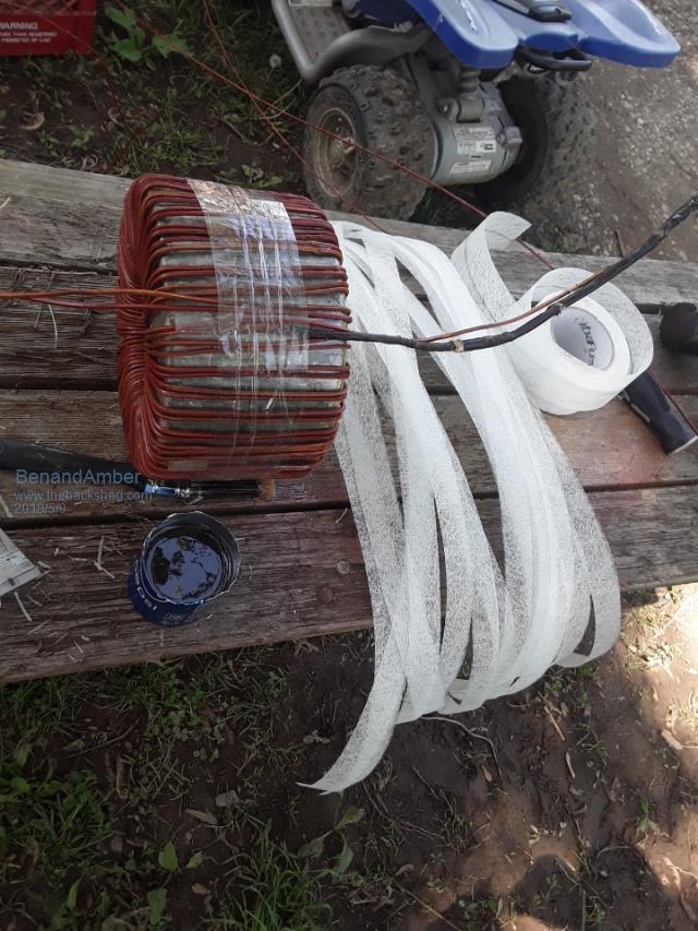

Getting ready to epoxy the first layer of wire
see the fiberglass tape I'll be winding around it
I cut it in short pieces to make it easier 2 wind
Thanks tinker for the idea and adviceEdited by BenandAmber 2019-05-10

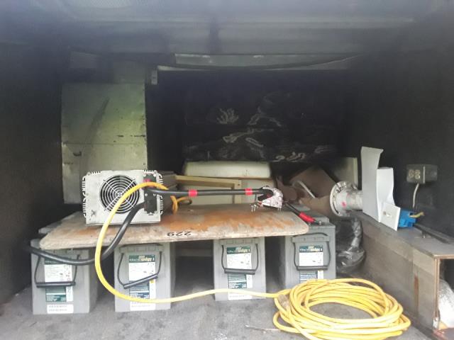

Little Energizer Bunny just keeps going and going
I did put a 30 amp dc breaker
on it like poida the great told me to
It flips oftenEdited by BenandAmber 2019-05-10

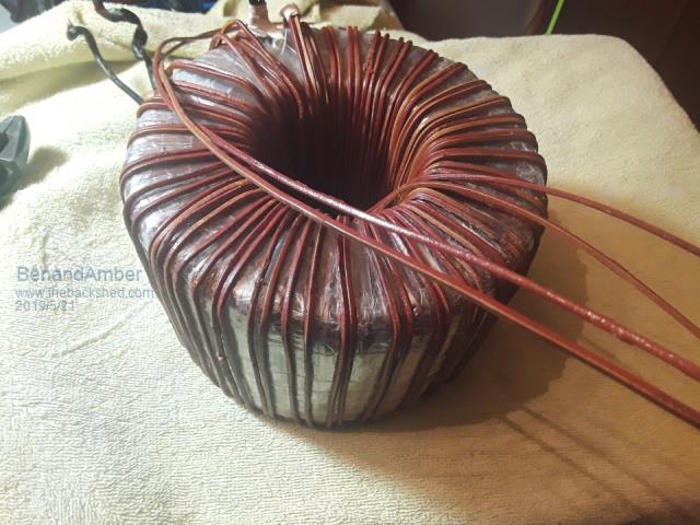

Got a chance to wind another layer
Running out of space we decided to go with 1 in hand 3mm Square wire not round Square
Just not enough room to fit into the power Jack case if I went to in hand sucks but it is what it is
Hopefully I can get 4000 watt continuous and peaks of six or seven just for a few minutes
It probably doesn't really matter anyway because I doubt if I run over 2000 Watts continuous
I just don't have the batteries for it
8 145 amp hour batteries at 48 volt so 290 at 48

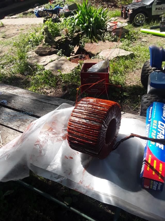

I had a chance to epoxy the last layer of the high side secondary
After the epoxy dried I wound it with two layers Transformer tape
now I am ready for the low side

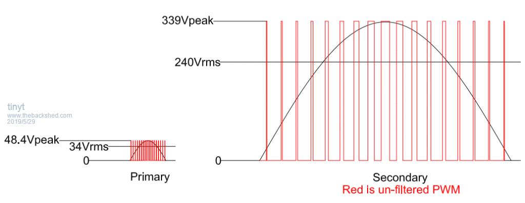

tinyt
Joined: 12/11/2017
Posts: 564
Posted: 08:33pm 28 May 2019
  BenandAmber said   I'm trying to understand it all tinyt
I made a sketch of what I think the waveforms are for a 240VAC rms sinewave with the PWM superimposed on it.
For a sine waveform, the relationship between the root-mean-square(rms) and its peak is: peak = rms x 1.414 or rms = peak x 0.707
The sketch is for the ideal case and the 48V battery is at 50% state of charge. The highest voltage on the primary side will be the battery voltage and is the peak voltage for a sine wave. So the equivalent rms will be 48.4 x 0.707 = 34.2 VAC (same as 48.4 / 1.414).
If you want your secondary to be 240VAC at this condition, the ratio will be 240 / 34.2 = 7.017. or 1:7. But this does not consider losses in the choke, wiring, mosfets, etc. When the battery is between 50% thru 100% state of charge, and the PWM electronics can monitor and regulate for output voltage changes, the 240VAC can be maintained and hopefully also the waveform.
At the ratio of 1:7, when the battery voltage drops lower than 48.4, the pwm electronics might still regulate but the peak of the waveform will now become lower together with the rms value. So, within limits, it is better to use a higher ratio.
I am no expert. But this is the way I understand it.Edited by tinyt 2019-05-30
