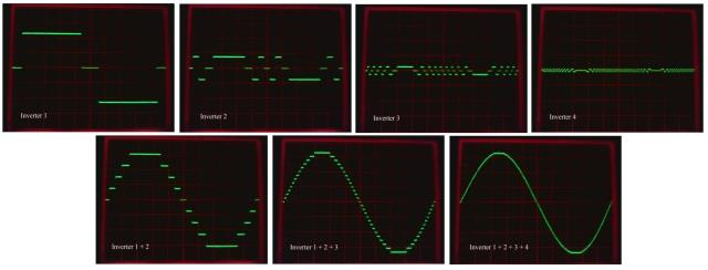

Posted: 11:53pm 11 Mar 2019
Klaus,
The top four waveforms are the secondary voltages of the four inverter transformers shown in correct amplitude relationships.
The lower three waveforms are the voltage produced when these transformer secondaries are connected in series.
Posted: 11:59pm 11 Mar 2019
This is a larger picture of the final waveform.
Edited by Warpspeed 2019-03-13

Posted: 12:11am 12 Mar 2019
Thats the picture I was looking for but could not find.

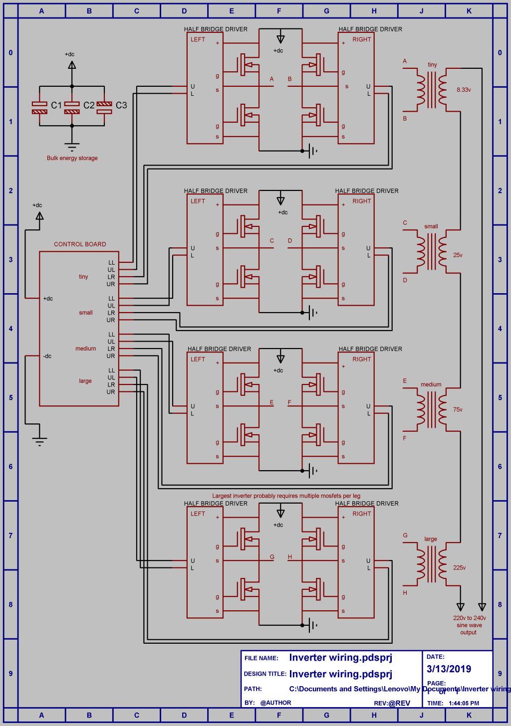

O/k here we have the overall wiring diagram for the entire inverter.
The control board just generates some drive waveforms appropriate to the measured dc input voltage.
There will be eight identical half bridge driver boards, that just have a pair of 15v isolated dc supplies, and a pair of opto isolated gate driver chips on each.
Schematic of that to come very shortly.
The three smaller inverters just use four mosfets. The largest inverter will probably require multiple mosfets per leg, depending on the power level. Or alternatively single large devices such as mosfet or IGBT power blocks.
And of course four transformers.
And some large electrolytics, and probably an EMC filter on the output just to finish things off.
A fair few parts, but its really quite basic.
Just noticed C3 is upside down, and a few other minor things need tidying up, but the schematic is correct enough to convey the basic concept.
Edited by Warpspeed 2019-03-14

Posted: 03:33am 13 Mar 2019
The "bulk energy storage" are the low ESR RIFA caps?
I am assuming the polarity of C3 reversed is just am oversight
Posted: 03:50am 13 Mar 2019
Yes C3 is standing on its head.
Should have spent a few more minutes looking at it before I posted.

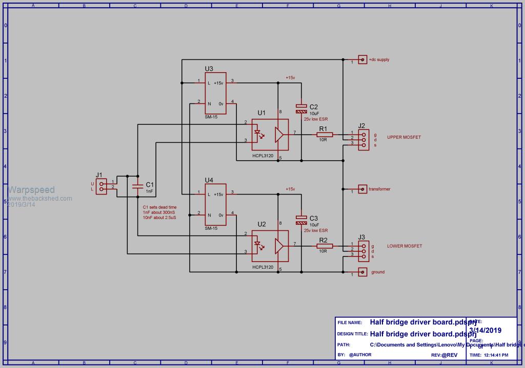

Posted: 12:49am 14 Mar 2019
Here is the schematic for one (of the eight) half bridge driver boards:
This deceptively simple circuit has a few very valuable features that go a very long way towards making the whole inverter pretty bullet proof.
The U/L twisted pair from the control board dives a pair of opto isolated mosfet gate drivers, and the LEDs of these are connected in inverse parallel. This makes it impossible for both upper and lower gate drivers to be on simultaneously. This provides very simple and effective cross conduction protection under any conditions.
To turn one opto isolator off, and the other on, the U/L drive voltage must slew through zero, where both opto isolators will both be off. The symmetrical dead time produced will be about 50nS, but we can increase that by any amount by fitting C1.
These opto isolators provide extremely high noise immunity, and also prevent any blowups from propagating back into the control board.
The HCPL3120 also has an internal undervoltage lockout to prevent any misbehavior during power up, and power down, or brownout.
As we are only switching at a very low cycle rate, the HCPL3120 can easily drive multiple very large mosfets or IGBTs with ease through suitable gate resistors.
U3 and U4 are small five watt isolated switching power supplies of postage stamp size. If very lightly loaded, as they are here, they will start up and run from about 30v, and operate safely up to around 400v dc input.
In my inverter I have seventeen of these small supplies. One on the control board, and sixteen on the eight half bridge driver boards. The combined running power of all the electronics in the entire inverter (with the transformers disconnected) will be 5 watts.
Edited by Warpspeed 2019-03-15
