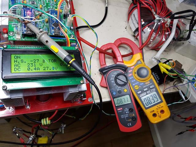

  wiseguy said   ... I believe what we are seeing is the charging up current for the AC capacitor on the rising voltage waveform and then recovering that energy back into the supply for the falling part of the wave form.
I beg to differ, I think it is the magnetising of the toriod core one way, then the other, as the 50 Hz waveform (probably about 90% to saturation) is driven by the inverter.
My idle current is 0.39A at 27.3V or approx 10.5W
This represents the losses which include but are not limited to
- Rds(on)
- I2R losses on the primary winding and the choke.
- toroid core's hysteresis
- powering the nanoverter (about 0.02 A at 27V, about 0.5W)
- Rds(on)
I based my statement on the measurements from my 2.5kW toroidal core, which was only drawing ~ 40mA RMS at 240VAC unloaded. Your quoted idle current of 0.39A led to circulating primary currents of ~ 10A ?
The true power involved with my Toroid @ 40mA was 6.42W the VA was under 10W which is a TAD shorter than the 300W of circulating currents that appeared to be on the primary from your measurements - 10A RMS at ~28V ?
If I am wrong, then surely the data from the excel sheet must be wrong ? Just to get a feeling for the magnitude of current - what is the value of the 240VAC capacitance ?
I think 5uF on 240V has an XC around 600 ohms which is nearly half an amp - I reckon it is a much bigger contributor to the circulating currents ?

Posted: 11:31am 01 Jun 2019
The 240V cap is 10uF.
Using an AC clamp meter (with unknown frequency response)
on idle shows 8+ Amps AC, with a primary voltage of 12.6V AC RMS
when driven with the 27.3V supply.
I prefer to use the current sensor and DSO to determine this current
since it is not fussed with frequency or crest factor within the limits of
my test scenarios.
The 240V cap I believe does not present much of a load on the inverter,
it continually takes and gives energy each 1/2 cycle. There are some losses
from ESR and other capacitor real world imperfections but it's there
to do a job which is be part of the LC filter.
I place 6A DC across the choke and primary winding, I see 100mV
This is 17mOhm DC resistance.
Edited by poida 2019-06-02

Ok now if you clamp one of the 240V AC capacitor leads and tell us what the capacitor current is - I am expecting around 1A.
And it would be that current increased by the turns ratio that we are seeing on the primary. But I agree & have stated it is of little concern because almost all the energy put into the capacitor is returned back to the supply each cycle.
There are 2 components to the story, yes there is magnetising current and there is capacitive reactance, but I am confident that the capacitive reactance is the major part of the primary current we are seeing on the unloaded inverter output.
Don't get tempted to disconnect the capacitor, the inverter might get angry with you.
To add clarification I am not suggesting the capacitor is a problem or that it shouldnt be there, it was a philosophical comment about the 10A Toroidal primary idling current and that the FETs are a little busy given there is no load.
FYI Carefully plug the 10A capacitor on the Power-Mate Lite socket (death lead) and check the idling power at 240V probably less than 0.5W true power now look at the current on the meter screen and then tell me it doesnt load the inverter - if there is less than 0.7A I will be very surprised. The VA should show you ~ 170VA (I will indemnify your meter against damage....)
Edited by wiseguy 2019-06-02
Cheers Mike

I just now removed the cap, measured the power when I apply 240V AC to it.
I saw 117VA. After careful discharging it from 320V to zero, the LCR meter
shows 6.2uF.
(The marking has "10J300VAC", no worries. Maybe it's 10 Joules at 300V.
What's that mean in capacitance? Joules = 0.5 x C x V x V,
so given 10 Joules, 300V, whats the capacitance? 55uF..hmm the marking is Joules not uF? )
Xc = 1/(2PI x 50 x 6.2 x 10-6) = 513 Ohms
current then should be 240/513 = 0.47 A
VA might now be 240 x 0.47 = 112 VA
Close enough for me.
So that's what I am seeing when I see phase difference between primary current and AC output voltage. It's due to the cap, not inductance. What a dill I am.
Thanks for leading me to the truth, again.
By the way, this 0.47A times the turns ratio (230 / 12.6) = 8.6
Which is what the 2 clamp meters see.Edited by poida 2019-06-02

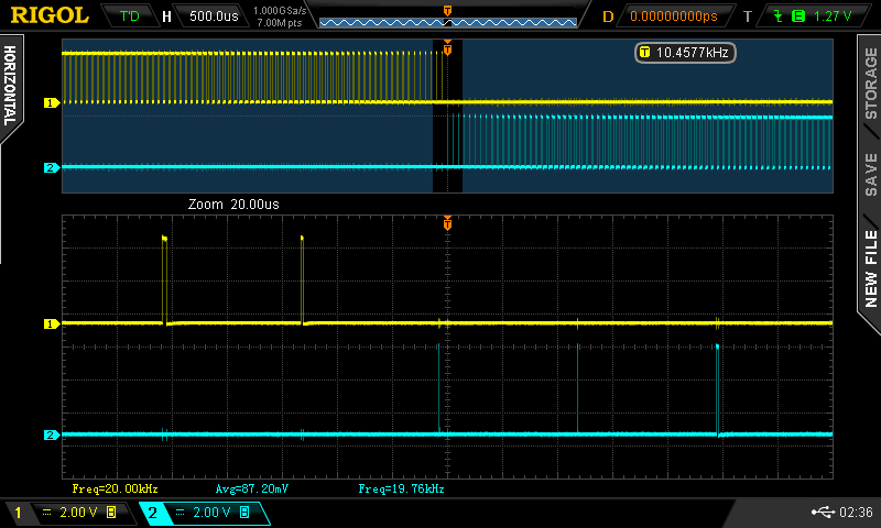

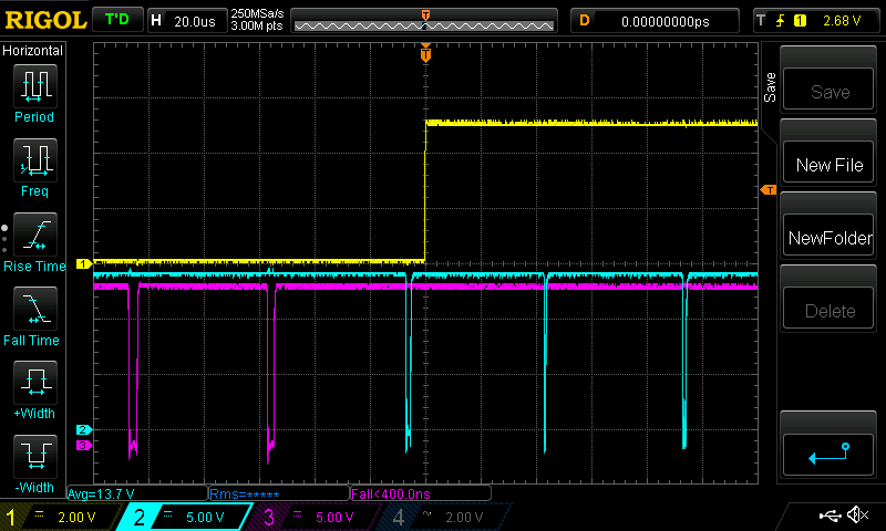

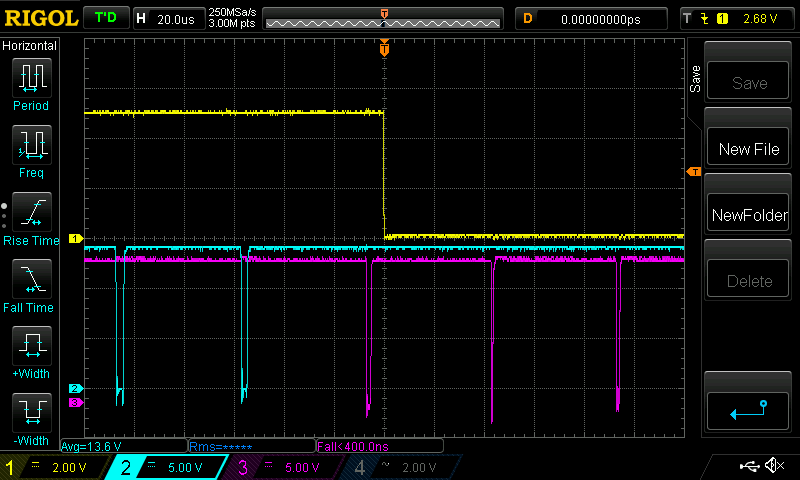

Mike,
the duty cycle is a nominal 800 clocks, at 16Mhz.
This means a 20kHz PWM cycle.
I can, on a 20kHz cycle by cycle basis, alter the duty % as needed.
From memory if you use a duty cycle of 1, you get a one clock pulse high
with a 799 clock low. If you choose a duty cycle of 799 you get 100% on with zero clock periods off. This is a particular behavior of the ATMega328.
In the code block "loop()" it runs once each 1/2 cycle of the 50Hz.
i.e. 100Hz at zero crossing time, I determine the correction needed to obtain the required AC output voltage. This voltage is directly proportional to duty cycle %.
I determine the required "power" value, and then ensure it does not fall below 0.01 or above 0.99, then multiply it by 800 and that is now the duty cycle in clocks.
So, a power factor of 0.01 is equivalent to 0.01 x 800 = 8 clocks.
This 8 clocks is the minimum duty cycle ever output to the gate drive ICs.
And 0.99 x 800 = 792 which is the maximum duty cycle, in clocks, ever output.
So the gate drive ICs will see a square wave, 20kHz, with duty cycle ranging from 8/800 to 792/800 clocks, at 16MHz.
That is, 0.5uS ON, 19.5 uS OFF for the floating point power command of 0.01 and
19.5uS ON and 0.5uS OFF for a command of 0.99
I ensure there is some significant amount of ON/OFF, at the 20kHz base frequency
to keep the charge pump circuit functioning.
With dead time and slow rise and fall times of the total gate drive circuit, this 0.5ms pulse does not amount to much ON time for a MOSFET.

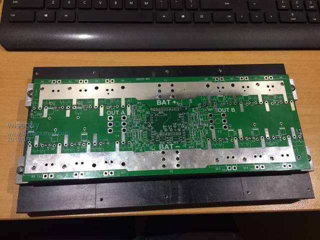

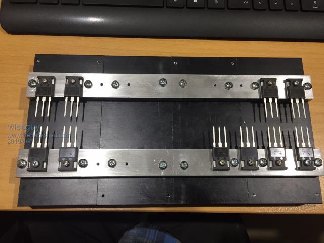

Sorry for the belated reply I have been busy since yesterday, bashing the metalwork into shape which had to be done before I start to populate the PCB. Here is what Ive been up to - and I ran out of FETs until my slow boat from China arrives
The FETs are mounted on a 25mm x 10mm Aluminium bar, the FET legs will be bent up to go into the PCB, the screws holding the FETs are temporary and will finally go through the PCB and sandwich the FET between the PCB & heatsink.
The 4 heat sinks were left over from an old project seemed like a good way to use some up...
I have not had a chance to open the variac nano code yet - it will come in very handy for testing purposes & I appreciate you taking the time to comment it for me - should be a great help in following and understanding.

Finally today I hooked up a large toroid and a 30V 5A supply to begin testing my inverter.
Everything is working essentially as expected and it even ran a Makita hand drill (only ~ 140V out), but it all works a treat.
However looking at the pulse trains for the sine-wave generation I noted the following behaviour of the Toroidal drive
First pulse      ~ 1.65uS    + 48uS delay
Second pulse    missing     (50uS delay)
Third Pulse      ~ 940nS     + 49uS delay
Fourth pulse    ~ 1.65uS    + 48uS delay
Fifth pulse       ~ 2.44uS    + 47uS delay
Sixth pulse      ~ 3.24uS    + 47uS delay
Next I checked the same pulses strait from the nano and got the following results
First pulse        ~ 1.6uS     + 48uS delay
Second pulse    ~ 70nS      + 50uS delay
Third Pulse        ~ 910nS    + 49uS delay
Fourth pulse     ~ 1.6uS     + 48uS delay
Fifth pulse        ~ 2.4uS     + 48uS delay
Sixth pulse      ~ 3.2uS      + 47uS delay
The last 3 pulses from the other end of the half sine waveform were
Third to last pulse     ~ 3.2uS  + 47uS delay
Second to last pulse  ~ 2.4uS  + 48uS delay
Last Pulse                ~ 1.6uS  + 49uS delay
The other half sine-wave phase gave the same results.  The second pulse (70nS)is too small to get through the FOD3182 opto-coupler that is why it disappeared from the FET power drive to the toroid.
Poida, I suspect that the two half sine-waves have essentially the same shape and probably deliver equal energy content albeit with some slight distortion.
There does appear to be something strange occurring though especially with the first and second pulse being 1.6uS and then 70nS respectively, they should be getting bigger not smaller. Also I would have expected the first few and last few pulses to be the same.
I am only bringing this to your attention as I suspect there is something going on that you may not be aware of.  Why can we resolve in ~ 800nS steps starting from zero on the up (ok starting from 1.65uS then zero) but on the way back, the final 2 pulses are 2.4uS and 1.6uS - I would expect the first two pulses on the up to be 1.6 then 2.4 ?
Note: This is an open loop result where the AC feedback is currently too small to regulate, so the gain of the nano has gone to maximum.  I have found in the past that when something is happening that is not fully understood other things may be occurring or affected that may have the potential to behave in a negative manner (bite you in the ass later....). Having symmetrical drive either side of the 90 degree peak gives lowest distortion & having symmetrical positive going and negative going half sine-waves are highly desired (essential?) to eliminate flux walking.
In an ideal world I believe the best results might come from a look up table of a single 90 degree sine portion that drives a sine wave to 90 degrees and then reverts from max back to zero using the same steps in reverse and the next 180 degrees for the other drive is derived exactly the same as the first 180 degrees. The gain would be constant and uniform for each whole 360 degree cycle. Read the feedback dc level and then use it to create the next (gain compensated) 90 degree look up table for the next 360 degrees.  This would ensure each complete cycle, once started would finish with exactly equal energy content and symmetry for both half sine-waves.
I am not suggesting the look up table contents actually has a fault or bad values but that something is causing some unexpected results to occur.
I do have the beginnings of an inverter showing promising signs of potentially working - albeit - so far not at full output yet - a quick clip showing a messy bench and a Makita hand drill being driven Here .  Idling power at 30V in is ~ 185mA (5.5W)
Edited 2019-09-30 00:23 by wiseguy

Mike,
I did a quick hack of the nano1 code to obtain how long V1 and V2 are switched on for.
Let V1 and V2 be the inverter outputs for the 2 half bridges.
When V1 is on for longer than V2, we will see a DC current appear on V1 compared to V2. I will see a unbalance in the duty cycle count totals if this is the case.
The hacked code sums the PWM duty (in cycles) for both V1 and V2.
I only start summing V! and V2 total cycle counts when the ramp up is complete.
In my test, there is no inverter present, no Vfb so the ramp up continues to
100% power and stays there.
I printed the difference in duty cycles for V1 and V2 at the time when v1low = 1
and uf = 1, that is some fixed time in the 50Hz output.
I see a constant value of (V1-V2) which in this test is 12 cycles.
The 12 cycles difference is likely due to one half cycle not quite being at 100% when the soft start completes.
The important thing is that this difference does not increase or decrease.
It stays constant after the soft start completes.
It stays at 12 cycles...
this means there are exactly the same number of clock cycles switching V1 ON
as there are clock cycles switching V2 ON. The V1 waveform has the same form as V2,
down to the clock cycle.
But this is when there is no voltage feedback.
This condition is important. Vfb might end up causing one 1/2 cycle to become larger than the other at some undefined time, and then Vfb might require the 1/2 cycle to become smaller at some other, later time. The magnitude of the changes might not exactly add up to 0.0000 at any time we chose to measure.
Nano1 code uses the same lookup table for duty % for both 1/2 cycles of the 50Hz output. One output pin is driven low and the other is driven by the PWM sine wave.
Pins 9 and 10 are the driven outputs so we will see pin9 low and pin10 SPWM for a 1.2 cycle, then pin10 low and pin9 SPWM for the next 1/2 cycle.
Here are the values in the lookup table for a power of 0.99 which is the maximum
the code will ever output pins 9 and 10.

Nano1 code runs through the index of 0 to 200 INCLUSIVE.
It runs through this table each 1/2 cycle.
200 entries, 800 cycles per pwm and 16MHz clock means a 20KHz PWM
with a minimum PWM width of zero and a maximum of 800 clocks.
I like to not let it go to 800 clocks, since that would mean the PWM would be permanently ON and no pulsing, and importantly, no pulsing for the charge pump.
So I limit it to 0.99 of 800 clocks, leaving a short OFF period during the full power PWM pulse, to keep the charge pump alive.
The value for index 0 = 0 cycles
and we never get to index = 201
So it is not exactly symmetrical, but near enough.
(where symmetrical means the same number of cycles ON during the ramp UP as
there are during the ramp DOWN in a half cycle.)
I could modify things so it is symmetrical about the maximum of the sine wave.

The first and second pulse widths are right about when the control loop
does it's modification to the required power output.
It's possible that early in the half wave the Vfb control loop chooses a smaller power output that then will scale the PWM duty width to "small".
But I don't think so.
I would like to think that under a relatively steady state condition, well past soft start, the changes to the power output would be small.
I have spent a fair bit of time in the past looking at PWM output during the AC output zero crossing. I concluded that I could obtain perfect PWM timing if I used FPGA.
I don't want to go down that rabbit hole.
The ATMega328P offers near perfect timing and it's programmable and we can control it with OUR programs. (not like the EG8010 which is fixed in function and has some drawbacks)
I see with the current nano1 code the PWM is not optimal.
pin10 = OC1B
pin9 = OC1A
v1low = 1 when pin10 is SPWM and pin9 is pulled HIGH
Yellow = v1low (v ONE low)
Light Blue is inverted pin10 low side gate drive
Pink is inverted pin9 low side gate drive
Here is the zero crossing where v1low drops from 1 to 0
and here is when it rises from 0 to 1
We can see in both cases there is a PWM pulse that should not be there
The pulse about 5 uS before the yellow trace changes state.
Maybe no so much "should not be there" as it's the wrong pulse out the right pin.
Also there could be an "out by one" error with the pwm table counting.
Maybe I never get to the entry numbered 200.. and then it's time to switch over to the other 1/2 bridge.
I could fix this, maybe. I doubt it though.
I also doubt it will result in any significant issues either if I leave it be.
here is the code that prints the difference in clock cycles
if you want to see it.
nano_1_v8_pwm_sum_test_wg.ino.zip
load this into a spare nano or uno and see the output in the serial console
You will need to pull pin8 to 5V to make the inverter code run.
press reset button and watch variable sst grow(slow start..) to 251 when the totals
of V1 and V2 clock cycles comparison starts. It will show some value
and I don't care what it is but the important thing is that it does not change.
