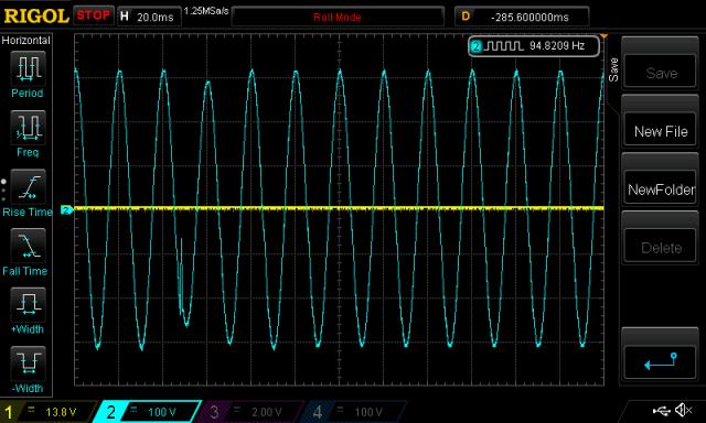

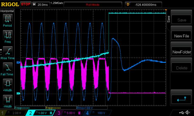

I have improved the transient response in the nano1 code.
This is where the closed loop control is keeping the output voltage at the setpoint.
I looked at what happens if I remove the digital low pass filter that is applied
to the Vfb signal. I used this in my other prototypes and it worked well in
removing noise from the AC output Vfb signal.
In the case of the nanoverter we already have a low pass filter on this signal.
This is implemented with an active LP filter, U10 on the schematic.
The results are good.
Again, same testing conditions as a previous post in this thread.
with the digital LP filter in place:
and with it removed:
This is a lot faster recovery. And to my eyes it seems there is less overshoot.
I would estimate it took 2 cycles to return to the setpoint, compared with 4 or more
cycles with the previous code.
So I want to continue with this code from now on.

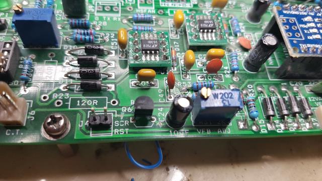

I am not using the SCR shutdown circuit yet. In fact, I have no
current sensor function so far.
I'm not sure I understand the R54/R23 design issue.
The way I see it is R54 is needed to be across the current transformer.
This is to limit the voltage that is then applied to the diode bridge.
1N4007 diodes have an upper voltage limit before breakdown.
We do not want to exceed this, so if the current tranny does not have a
resistor built in, we need R54.
The diode bridge then sees a small load of about 470 Ohms, and this
might be enough to "switch on" the diodes. At least that is my understanding.
R23 might not be needed at all.
I clearly need guidance from TinyT and others with this.

That SCR circuit was taken from oztules design with the added option of selecting where to place the current transformer load resistor. The oztules design has the load resistor after the diode bridge and there were suggestions of moving it before the diode bridge (right at the current transformer output). So, the PCB gives you a choice where to put it.
Here is the way I understand the circuit. The scr data sheet says it needs typically 0.5V between gate and cathode to trigger it to conduction. This voltage will be coming from the wiper of the 2K trimpot R25. The positive terminal of R25 is connected to a 1K resistor R26 with its other end connected to the anodes of the diode bridge. Assuming that the trimpot wiper is set at midpoint, then the diode bridge has to output 1.5V(peak) to trigger the SCR. The current thru the 1K and 2K will be (1.5)/(1000+2000) = 0.0005A(peak). The drop across the 1k8 R22 gate series resistor is assumed negligible for a trigger current of 50 uA.
If the load resistor is R23 (after the diode bridge), for SCR triggering, the current thru it will be (1.5)/(120) = 0.0125A(peak).
The current thru the diode bridge will be 0.0005 + 0.0125 = 0.013A(peak) or (0.013)/(1.414) = 0.0092A(rms). This same current has to be supplied by the transformer for SCR triggering.
Looking at a 1N4007 data sheet forward voltage characteristic curve, at this current the forward voltage drop is roughly 0.6V. So the output of the current transformer has to be 1.5 + 2*(0.6) = 2.7V(peak).
If R54 is installed instead of R23, the output of the transformer still has to be 2.7V(peak). But the current thru R54 is (2.7)/(120) = 0.0225A(peak) For SCR triggering, the current transformer has to supply 0.0005 + 0.0225 = 0.023A(peak) or (0.023)/(1.414) = 0.0163A(rms).
Assuning the current transformer used has a 1:1000 ratio.
For the R23 configuration, the SCR will trigger if the primary current is 1000*(0.0092) = 9.2A. If this is the current going thru the load of the inverter, then the SCR will trigger with an inverter load of 230*(9.2) = 2116 watts or higher.
For the R54 configuration, the SCR will trigger if the primary current is 1000*(0.0163) = 16.3A. If this is the current going thru the load of the inverter, then the SCR will trigger with an inverter load of 230*(16.3) = 3749 watts or higher.
I hope I did not make any mistakes in my understanding and calculations.Edited by tinyt 2019-02-22

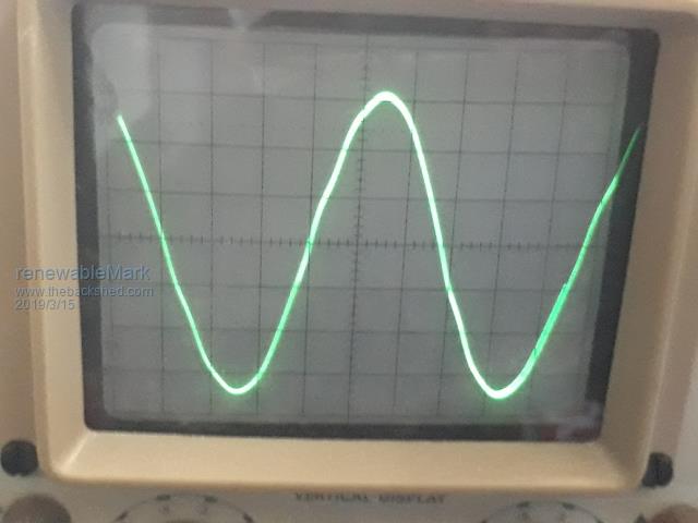

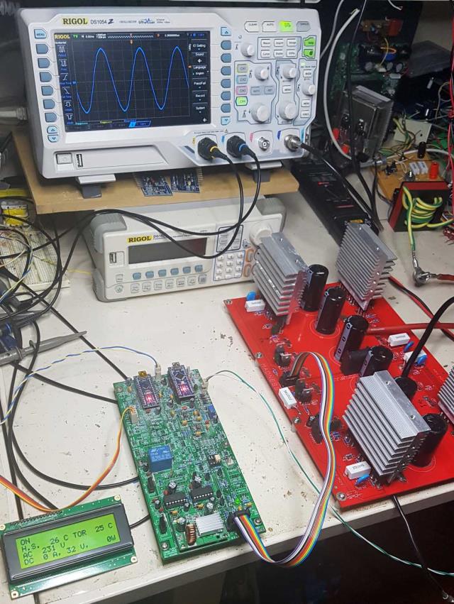

I've just completed building one of Madness's power boards.
I fitted only 3 MOSFETs per leg of the bridge.
It worked first time when I fitted one MOSFET each end, to save repair grief.
So I put another 2 on each end.
See it powered by the nanoverter.
The primary is 45uH E core ferrite and a 1500W Areosharp toroid.

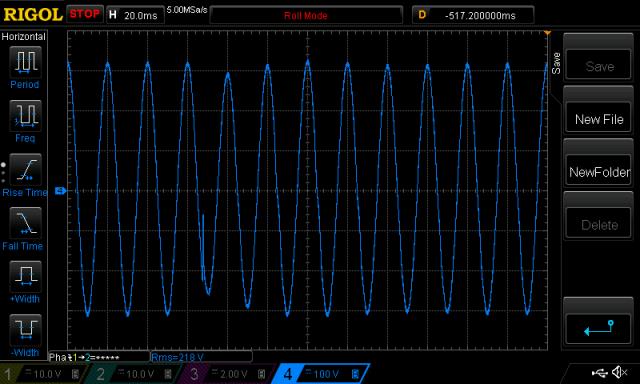

The capacitor is on the 240V end and is 10uF.
It produces a nice clean output as seen below.
It's a credit to Madness to design and provide these good quality boards.
I notice one thing already and that is the board does not like
running at less than about 32V DC supply.
This is non-optimal for me, I test on the bench with a 27V supply.
I wonder if I change one component (the 18V zener) if I could get it to be happy down to about 22V?
Load tests will happen when I can run it at 22V. I have no way of providing a 48V battery near the work bench.

Good work Poida,
I gave up on the 8010 based control card and got my nano running the Mad power board now.
Need to fit more fets and capacitors then re test but looks great so far.
Started and stopped it 50 times in a row on full power and nice even start every time.
NO BANG!
Cheers Caveman Mark

Latest code now has SCR high current cut-off.
And it has 3 plus 1 decimal format for DC current, DC supply voltage and AC current.
here is the SCR over current cut-out behaviour.
Dark Blue is AC output voltage
Pink is low side PWM, undersampled so it does not look quite right.
Light Blue is the "AC Current" signal I fed into the diode bridge.
I used a simple 5V voltage from a potentiometer, which I am winding up to the SCR threshold.
This shows the simulated AC current signal rise to about 3.4V DC then the SCR triggers. This shuts down the gate drive IC outputs in the middle of a wave form.
No waiting for a zero crossing. It shuts down immediately.
We can see my transformer/inductor/capacitor/output load ring a little at it's resonant frequency afterwards.

I have found that resetting the SCR is rather fiddly, it is very sensitive to bounce contacts. The most reliable way to reset is to remove the inverter power, draining
the nanoverter DC-DC converter completely.

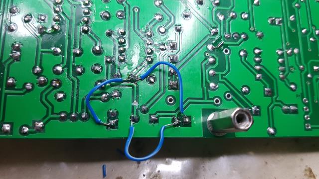

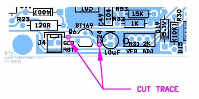

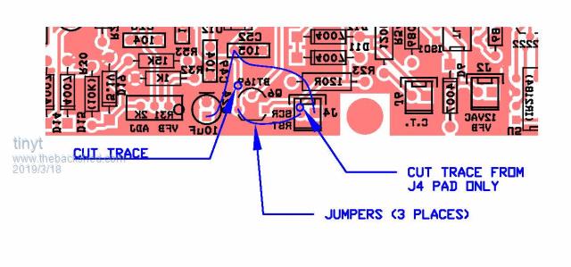

I think there is a flaw in the shutdown switch reset connection. Right now activating the switch shorts the scr making the current flowing thru it go to zero. But this also charges C25 (scr gate filter) to +5V, so when the scr reset switch opens, I think what happens is the scr gets re-triggered by the charge on C25 and also C27. I should have used a normally closed switch in series with the anode of the scr to reset it.
Try the following modification to the pcb and use a normally closed switch.
This is pcb top modification:
This is pcb bottom modification:

Tinyt:
I made the mods as above.
It does not work at all now. When the reset pins are shorted, it triggers,
disabling gate IC output and signalling to nano2 "SCR over current"
When the reset pins are open, no voltage up to 0.75V will trigger
the SCR.
I measure SCR trigger voltage at one end of R22, near C51. This node is equivalent
to SCR gate pin but more accessible for meter clips.
