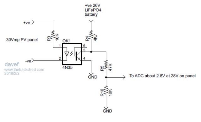

davef
Joined: 14/05/2006
Posts: 499
Posted: 08:17pm 01 Feb 2019
I made a mistake in the opto-coupler circuit. R4 goes to my 26V battery not to the PV panel. Probably wouldn't change the other resistor values but it would mess with the curve of Vadc versus Vpanel.

OK. I was wondering why you said the opto was isolated on both sides where they clearly had +ve tied together.

davef
Joined: 14/05/2006
Posts: 499
Posted: 07:54am 02 Feb 2019
Corrected opto circuit.
Another correction:
- R4 should go to a regulated supply, ie 15Volts in my case
The divider resistors will need to be changed. Suggest 3mA thru the diode and about 3mA through the photo-transistor at a nominal panel voltage of 30V. The divider resistors are adjusted so that when the panel input is zero, which makes the photo-transistor collector the highest, that the highest voltage presented to the ADC is 5V. That is for a 5V ADC reference.
Edited by davef 2019-02-04
