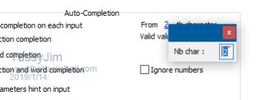

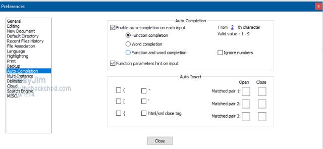

Posted: 11:01pm 13 Jan 2019
Auto completion now is working for me. I missed the part about having to go in to Settings, Preferences Auto-Completion and clicking Enable.
But I am unable to type in the field "From 1 th character". I type a "2", which appears as blank, and hit enter, and it still says "1". How did you change it to "2", Jim?

Posted: 01:35am 14 Jan 2019
Two things to observe.
Yesterday I updated my version of N++ to 7.6.2
They did mention that there are some folder changes but everything seems to work.
This morning auto-completion didn't work.
I now have MM_BASIC.xml in:
"C:\Program Files (x86)\Notepad++\autoCompletion\MM_BASIC.xml"
and autocomplete works again.
To set it to two characters before showing, click on the "1", enter 2 into the box and press enter.
The box will disappear and the setting is updated.

No not in mine, it reverts to 1 any number input is not shown in the box, box closes and 1 is redisplayed.

Posted: 01:57am 14 Jan 2019
I just did a clean install on my laptop which hadn't seen N++ before.
I chose the 64bit version for a change and put the two files in the same location as on the main PC
"C:\Program Files\Notepad++\autoCompletion\MM_BASIC.xml"
and
"C:\Users\Jim\AppData\Roaming\Notepad++\userDefineLang.xml"
I was able to change the auto-complete to two without any problems.
Posted: 02:05am 14 Jan 2019
  Quote   Search "triggerFromNbChar=" (1 hit in 1 file)
C:\Users\Jim\AppData\Roaming\Notepad++\config.xml (1 hit)
Line 73: <GUIConfig name="auto-completion" autoCAction="1" triggerFromNbChar="2" autoCIgnoreNumbers="no" funcParams="yes" />
You might be able to edit the config file directly.

Yes that works, set it to 2 and you still can't change it from the settings.
