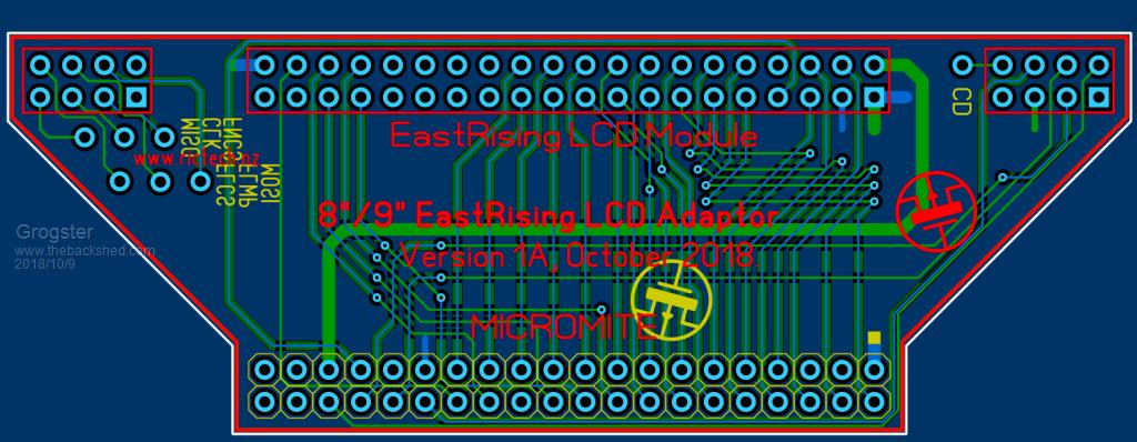

OK, chums, here we are:
This has both the SD card and touch SPI buses on their own pins as per the standard pinout for the 5" and 7" LCD's This is still E100 compatible, as the E100 joins those two SPI devices together into one bus, but for other applications where you need them separate - as mentioned by Jim, this has now been done.
16-bit data bus for the LCD data. I have yet to triple-check that everything is correct.
@ Geoff - OK, thanks for that info on the font chip, and so therefore, this connector is probably only good for the general purpose flash chip(if fitted). By default, the font chip and the memory chip are NOT fitted, unless you ask for them. As this is not catered for on the standard 40-pin connector from the MM, I have broken it out to some pads so you could solder your own wires on if you needed to talk to the memory chip....if you elected to have it installed.

I've just had a wee look around on the ER website, and this adaptor PCB will actually work with their 7", 8" and 9" displays - they use a standard(for them!) pinout on all their larger displays.
It will not fit the 5" LCD, but I am thinking of making one for it(which can probably cater to the 4" ones too), as the ER displays are on average six or seven bucks cheaper then the eBay or AliExpress ones, and ER guarantee supply of their LCD's for at least ten years(which means we can design with confidence).

Posts: 10114
Posted: 09:35am 10 Oct 2018
@ palcal - Hindsight is a wonderful thing. You are right, of course. But the issue is that no-one knew of the ER displays when the first TFT compatible MM's were created. Geoff and Peter used displays from eBay or AliExpress, as you would expect. Any new MM I design that needs a TFT WILL use the ER series, for precisely the reasons you and WW point out.
@ panky - Re: Pin-38, thanks a bunch. Now I know I have that pin connection correct.

My input would be to simply keep the 40-pin header as is current (and as documented in the MM User Manuals), and to optionally use the adaptor board whenever you use a 7",8", or 9" ER SSD TFT.
My only concern is the 'off-set' mounting holes!
WW
Posts: 10114
Posted: 10:44pm 10 Oct 2018
You both have a point. I jumped the gun a little there. The original concept remains. The ER are the best choice for those wanting 8" or 9" TFT's, so I guess you then get the best of both worlds.
