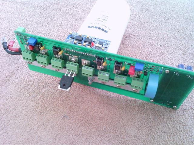

This "Oz type inverter" I built was nothing like what you guys are building.
I took the Wiseguy approach and designed it from scratch and its totally different in physical layout.
Firstly its all on one circuit board with short and direct tracks, and a very careful grounding layout. It only uses four single mosfets in the bridge although I made provision for eight mosfets. And each mosfet pair has its own personal TC4452 high power gate driver. The screw terminal blocks were a very new idea at the time.
It also runs at 100v dc so its only switching less than 20 amps. Its really just a baby...
It also has a very large non saturating choke, and transformer is tuned to 75Hz.
No fan or temperature sensing, just not needed.
It does have a current transformer and fast SCR type of over current shutdown.
I built it my own way, (using the Wiseguy approach) and thinking it all right through in detail before I started to lay the whole thing out.
I managed to avoid many of the potential problems you guys are still facing, and from this latest "glitch" revelation I have also been very lucky to avoid that unexpected problem and possibly others as well.

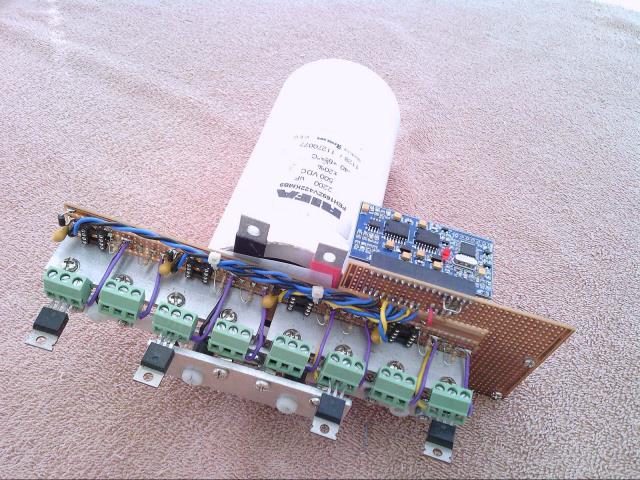

This is the original prototype, its a very similar circuit to what others here are using, but physically very different.
Final PCB with voltage feedback, +12 and +5 supplies, current limit, and reset button:

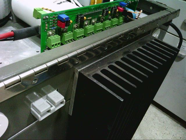

Mounted on its fan free heatsink:
If I remove the four screws holding down the four mosfets, and loosen the big nut on the base of the electrolytic, the whole board can be lifted out complete in around one minute, and then run on the workbench.

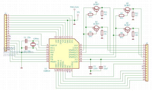

gaspo
Joined: 25/06/2018
Posts: 67
Posted: 04:18pm 20 Sep 2018

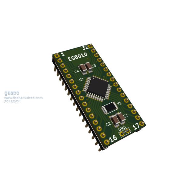

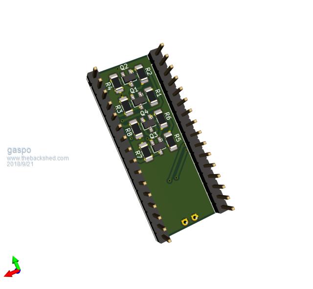

An adapter board might look something like this.
renewableMark
Joined: 09/12/2017
Posts: 1679
Posted: 09:16pm 20 Sep 2018
Thanks for the reply Wiseguy.
Gaspo!!! F hell, good work mate!!

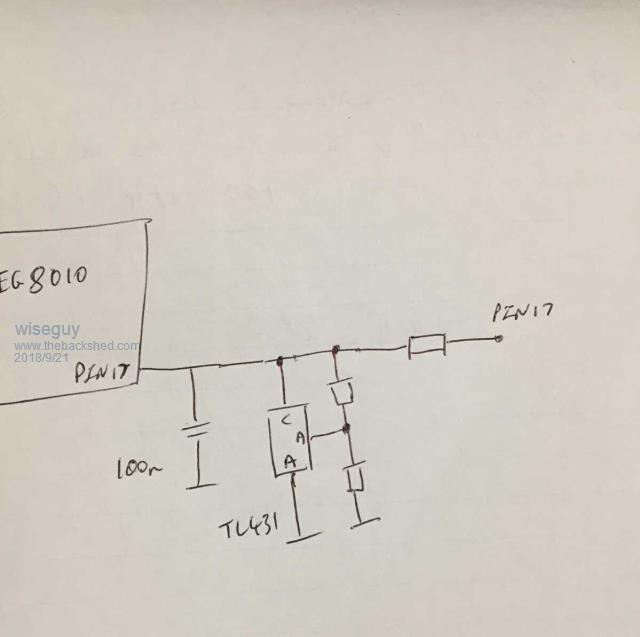

Gaspo - well done couldn't have done better myself, Im thinking you and Altium have had a long term relationship?
You saved me the trouble - I was thinking about TinyT and others with poor eyesight soldering in SOT23's so I was planning to adulterate a good layout and use normal resistors and TO92's etc and a normal crystal (the resistors would all stand up like an old transistor radio of course).
My dummy spit about not doing the board was at the end of a stressful day I felt differently the following morning.
However after taking a cursory look at your layout I think surface mount is the way to go. My only suggestion is to provide pads for the HF bypass capacitors on the analog inputs. I havent checked the schematic and pcb for correctness but I will assume it is ok unless you ask me to check it. Obviously the schematic is the most important part to get right the rest follows if using Altium in its intended fashion.
What are your suggestions of how tired old eyes and no smd devices in their toolkit that constructors could make or have access to a completed board?

Posted: 04:32am 21 Sep 2018
  wiseguy said   Im thinking you and Altium have had a long term relationship?
No, its not the Altium I'm friend with. I prefer the company of KiCAD
I was thinking of using the through hole components but the board is too small to fit it all.
The SMD parts I used are the normal sized 1206 with larger pads for hand soldering. These are easy to solder using the desktop magnifier lamp.
I've added bypass caps for the TFB, VFB and IFB inputs. Files are attached below.
2018-09-21_142821_EG8010-adapter-files.zip
wiseguy
Joined: 21/06/2018
Posts: 1335
Posted: 08:17am 21 Sep 2018
Excellent update Gaspo. At first glance I cant really tell the difference between your Kicad schematic & pcb and an Altium output - I dont know Kicad - I started with Pcad.
As far as a retrofit goes to eliminate cross conduction and minimise noise pick up by the crystal your updated board solves both. - could we make the vias under the xtal with hc49S spacing and un-tent them then the normal thru hole Xtal could be soldered in.
If a new construction is under way the bypass capacitors are better on the module, but if it is a retrofit the ones already fitted on the main board can be used. It does not matter if both are fitted.
1 last item to consider for future proofing - if the the 5V rail has any temperature drift the output voltage will vary in proportion, as Vref is tied to the 5V rail.
Could we have a TL431 (SOT23) added to EG8010 Vref with 3 resistors (values to be selected later), 1 from adj to anode (gnd) and 1 from adj to the cathode, a 100n cap from Eg8010 pin 17 Vref to Gnd. I think it will fit nicely. The third resistor is from pin 17 of the adapter PCB to the TL431 cathode, as the adaptor board Pin 17 is tied on the main control PCB to the 5V rail.
For a standard retrofit we would not add the extra parts (except the capacitor). The resistor between the pin 17's can be just bridged or 0 ohms fitted, it will then be as it always was.
The centre A pin is Adjust sorry
Cheers Mike
