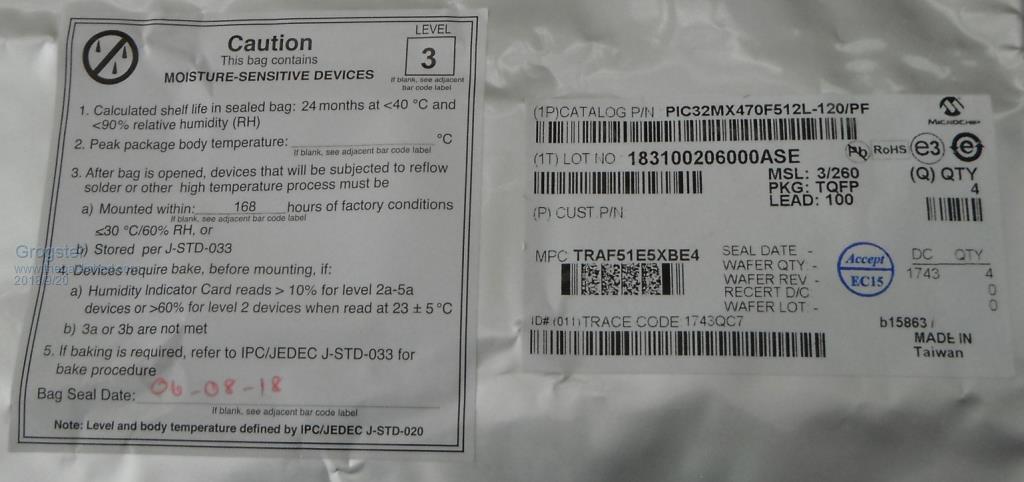

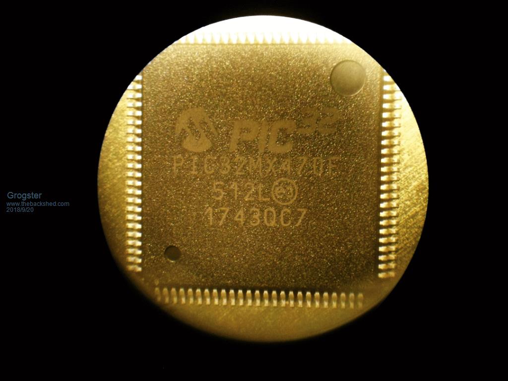

My current batch of 120MHz parts has the trace-code of 1743QC7.
These are 120MHz parts - I still have the anti-static bag they came in, and went back and looked, and they are definitely the 120MHz part. It is marked on the sticker, just not the bloody parts....
EDIT: I am a member of the Microchip Forums. If you can post your trace code here, I will post on that thread that Chronic linked to and they should then be able to come back and tell us - by their own admission - which speed it actually is.Edited by Grogster 2018-09-21

Now, THAT is interesting.
These are the parts I received, and here is the bag label:
I only bought these chips last month, as evidenced by the bag seal date. I have just checked a couple of my E100 kits from stock, and they too have the exact same trace code. When I looked back on that MC forum thread, I see someone has posted a (fuzzy)photo of their chip that also has the same code, and they are saying they are having issues with theirs at 120MHz. That wasn't you, was it?
The problem with NOT having the speed marked on the part itself, is that all it would take, would be for one MC employee to not pay enough attention when restocking their new chips, for that person to put 100MHz parts in the 120MHz trays - and then all 120's that go out are actually 100's, and no-one knows. Not even Microchip themselves.
To me, it's crazy for MC to NOT mark the different speed versions. It does not matter if there is only one speed, but if you have different speed options, it should be marked on the device itself. Disappointing. Especially when by MC's own admission, they USED to do it, but then they decided not to - the logic of which escapes me, when if you use the wrong speed part, you can have issues. Seems like MC have created a whole lot of extra hassle for everyone(including themselves) for no reason.

Yes that was the point I was trying to make, any mistake and there is NO WAY to tell if it's the correct speed rating, and as pointed out before there is NO internal ID that can be read to identify the part, 100 MHZ and 120 MHz read exactly the same and they are marked exactly the same - MicroChip are MORONS for deliberately making that decision to actually do this - one has to wonder why?
As the forum member said, all the trace codes and paperwork mean absolutely NOTHING if the wrong speed part was put in the sealed bag.
