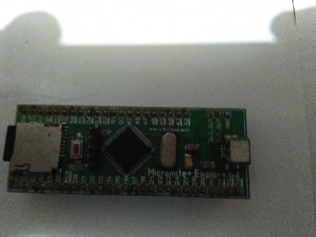

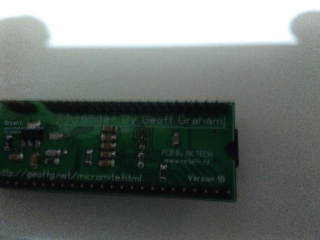

Some close-up pictures of the E64 module would be useful - especially the solder contacts on the uSD socket, and also 4 close ups of PIC (i.e. of each side of the 4 rows of pins).
Not trying to create 'work' for you - it is just sometimes easier to help as we may see something

Ok did the reflash of the beta10 hex file and still got the same error: SD Card not found. I only set the option for the sdcard and had the lcd unpowered.
here are a couple of pic's of the module
Tomorrow I'll have look in good light at the solder joints and if needed resolder them
