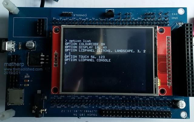

Posted: 05:49pm 20 Feb 2019
I tried to get all this sort of info on the silkscreen of the backpack. For the ILI9341 its on the silkscreen just alongside the ILI9341 header. You can just about see it in the picture on page 3 of this thread.
OPTION LCDPANEL ILI9341, orientation, 3, 2, 1
  Quote  Is touch like this?
OPTION TOUCH 56,123
Yes, for the ILI9341, but for a ILI9481 on the HAT header it is 112,56. Again all this is on the silkscreen so I don't have to keep referring to the schematic Edited by matherp 2019-02-22
Posted: 07:53pm 20 Feb 2019
Ok, thanks. There it is, right before my eyes. Excellent idea.

Posted: 08:38am 21 Feb 2019
We seem to have two different things going on here. The first is that I had a typo in the text strings which incorrectly reported ILI9341 as ILI9481. This is corrected in the attached.
2019-02-21_182944_Armmite1.3.zip
The second is that you can't get the display and/or touch working. I've just tested a display on my Nucleo/backpack and it all works perfectly. I'm confused by
  Quote  gui configure
in your post. Do you mean GUI CALIBRATE? Is the display itself working and just touch failing or is it both? I'm pretty confident in the firmware as this is old code shared by all the Micromite family so as always check all the solder joints etc. I had a problem with my backpack and found I'd missed soldering one of the pins completely - easy to do when there are so many!
Posted: 09:59pm 21 Feb 2019
Thank you. If you were confused, it was because I was confused. Yes, I did mean "GUI CALIBRATE" (and did use that to test).
With the new version, it does confirm ILI9431, but still nothing on the display (which worked before and after on a bigmik 170 backpack).
But here's a question: do I have to supply power to the 144 backpack? I haven't done that, thinking to power it off of the Nucleo board.
Posted: 10:50pm 21 Feb 2019
  Quote  But here's a question: do I have to supply power to the 144 backpack? I haven't done that, thinking to power it off of the Nucleo board.
Yes, that is the problem. The concept of the backpack is that it supplies power to the Nucleo, it has a much bigger regulator. The power header on the Nucleo should be set to E5V.
Posted: 01:02am 22 Feb 2019
Ok, done and working now. That was a tough couple of solder points for me to make--I had been hoping to avoid it.
Thanks very much for your patience with one coming late to the h7-144 backpack party.
