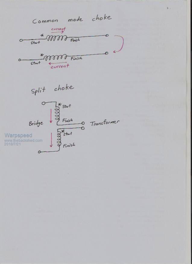

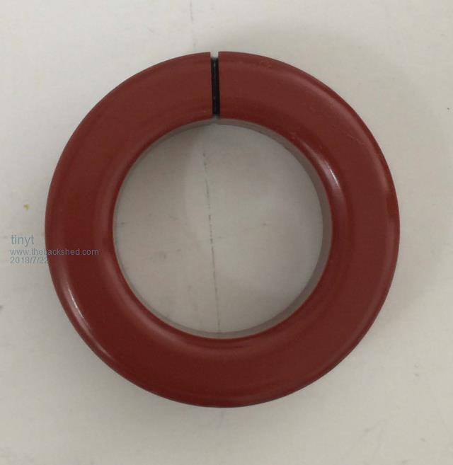

  Warpspeed said   Very nice indeed Klaus.
What are you using for a choke ?
Ring ferrite toroid and large non saturating ex aerosharp C cores.
Pics in next instalment.

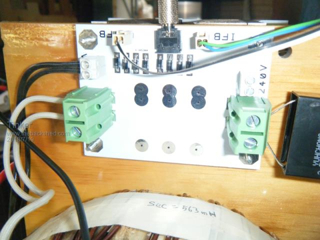

There is another little PCB that deals with the AC side.
On the left are terminals for 230V AC in from the secondary and smaller terminals for the feedback winding.
There is space for up to 3 x 2uF capacitors in the middle, not yet soldered in.
The mains out terminals are on the right as well as two smaller 230V terminals to connect a power (V,A,W,KWh) meter.

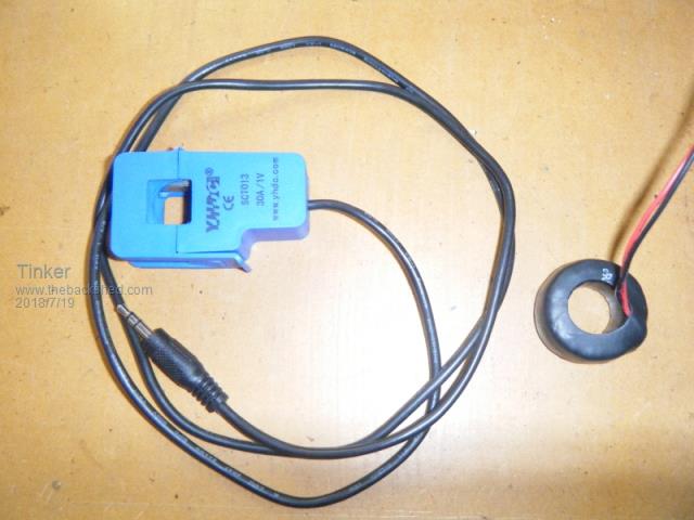

On top is a 3.5mm jack for the current transformer I bought, the blue one pictured. This proved to have too small an output (unless I wound the wire 10 times around) So I resurrected the C/T from a junked power display which had plenty of volts for the 15A test current.

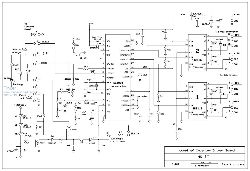

Here is the schematic of the control board, I use a printed version for checking.
I start with powering the little DC/DC converter By itself from my adjustable bench supply. 55V DC in got 12.2V DC out, good enough for me.
Pre test conditions: no IC's plugged in, no EG1810, no capacitors, no primary winding connected.
Connect the 12V output to the control board, the 55V input to the pos heatsink and neg busbar. Apply 55V, perhaps via an Amp meter, and check for excessive current. There should be virtually none, just the on current of the 5V regulator.
Then I check for the 12V to be where it should be as well as the 5V.
If all is well now is the time to select the series resistors for the trim pots.
I like to have the trim pots centered before soldering them in. With 25 turn pots an Ohm meter is easiest for that. For a 2K pot turn the little screw until 1K is measured between the center and one outer leg, its not critical BTW.
I have a little special screwdriver for that, this has a collar so it won't slip off the tiny slotted head even if its in a awkward position. Got mine from RS components (check for "moulded plastic trimming tool") but perhaps nowadays available from Ebay as well.
I did the VFB adjustment first. The toroid primary is connected via a switch (The toroid is NOT connected to the inverter yet) to the mains and the feedback winding to the feedback input of the AC board. Or if a separate little transformer is used, that instead of the toroid.
Turn on the switch and measure how much DC is at the VFB header pins. Its not critical as long as its more than about 6V DC. No filter capacitor is used BTW.
We know, from the application notes, that the EG1810 is looking for 3V DC feedback on its VFB input when the secondary is at the required AC voltage.
For those unfamiliar with feedback, it works on the same principle as a governor on a genset. There it adjusts the fuel supply to keep the RPM steady for varying loads.
With our inverter the feedback keeps the output voltage steady for varying loads.
A load increase would drop the secondary voltage. This also drops, proportionally, the feedback voltage. The EG1810 senses that and pumps in more power to the primary to compensate.
Anyway, we need a simple voltage divider to set the 1K trimpot wiper at 3V DC when there is the required AC at the secondary.
So, working backwards, with a 1K trimpot its mid point sits at 3V. A 0.5V adjustment range is plenty. So, the lower end of the pot (on the schematic) sits at 3V minus 0.25V = 2.75V.
The upper end sits at 3.25V in this example.
Now, the measured rectified feedback voltage in my case was 16.75V. This depends on the number of feedback winding turns or little transformer rating.
For my case the upper series resistor, RX, has to drop 16.75V minus 3.25V = 13.5V.
The lower series resistor, RY, has to drop 2.75V.
Now we need to convert that voltage drop into resistance values. The trimpot is 1K so we could call that one unit with 0.5 volts across it.
RX has 13.5V/0.5V = 27 units.
RY has 2.75V/0.5V = 5.5 units.
With 1K being 1 unit 27 units become 27K. RX=27K
5.5 units become 5K6, the nearest standard resistor value. RY=5K6
Sorry about that tedious explanation for those for whom all that is old news, perhaps it helps some newbies. I always find it easier to check when understanding why those values are set just so.
Of course, these calculated values are different for a different DC output from the feedback winding, just change the Volts across RX as required.

Now I get my chosen current transformer and measure its output at various currents.
Required for this is a 20Amp meter and a big transformer with room to squeeze in a single turn of 2mm wire or something that can handle 15 Amps. One pass through the toroid center would do as well.
This wire passes through the C/T and is shorted by the Ampmeter. I feed the transformer primary from my variac and slowly increase its voltage until 5 Amps AC flow. Then note the corresponding output voltage from the C/T.
Repeat for 10A AC and 15A AC on the Ampmeter.
If I wanted a 30 Amp trip then I would double the 15A voltage for the RZ selection below.
But not everybody has a variac so then what? Use some load in series with the primary to drop the voltage, perhaps 100W lamps might get a suitable current in the single turn. Need to experiment here.
But, care is required with mains voltage connection! Also, never apply full mains voltage as the shorted single turn could get very hot and also damage the Amp meter.
Another important thing, I noticed that my C/T was very suspect to magnetic fields. Its output varied a lot when it was next to the big transformer, also which way it was turned there. So, I made that single turn with a long wire which let me hang the C/T near the floor and away from the transformer on the bench.
Keep this in mind when fitting the C/T in the finished inverter. It should be as far as possible away from the transformer and its primary wiring.

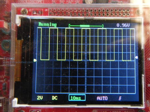

A CRO is required for this test, that little digital kit job works admirably for that.
With 55V power applied, on my control board the low voltage sense will activate as well initially, turning on the fault light. This is reset, fault light now off.
Now the inverter power switch is turned on and then the 230V switch supplying power to the toroid (or little transformer). Only a few seconds are available for the second part or the EG1810 senses no feedback and shuts down. Do not reverse that switching sequence.

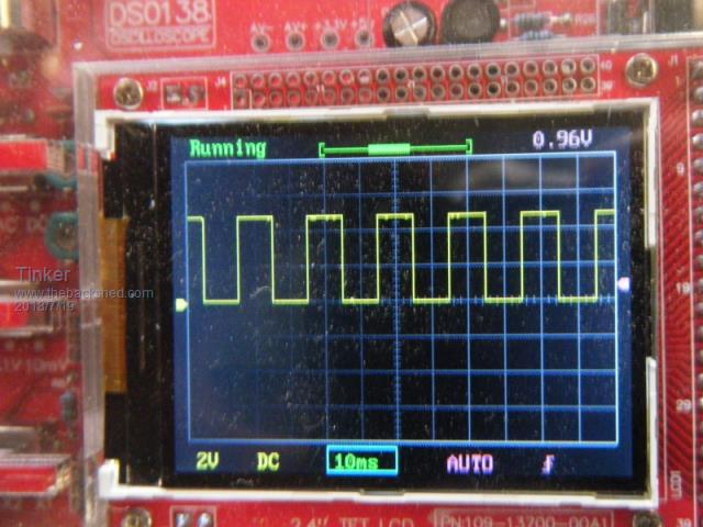

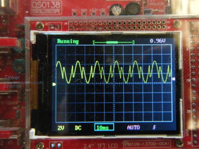

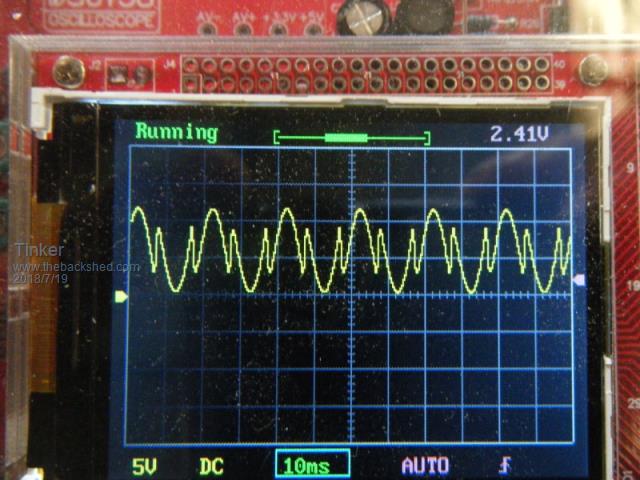

The EG1810 should now soft start and run. Check for the waveforms at the socket pin 10 of #1 IR2110. Be very careful with the probe tip, a slip could kill the EG1810. You know its dead when there is only a square wave, or nothing, at all tests below.
It should look like this:
Pin 12 of same IC looks the same.

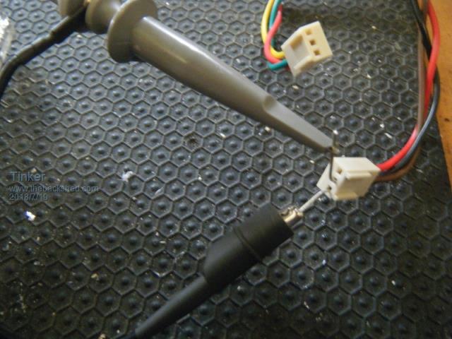

Now we need the special capacitor probe shown in the EGS002 application notes.
Applying that to pin 10 of #2 IR2110 we get this wave form:
The same signal at pin 12

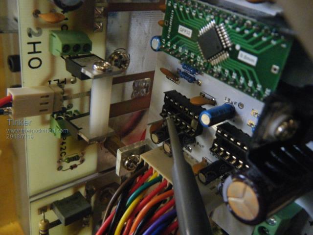

Insert the two IR2110 chips. Take care no pin folds under the chip body as its inserted.
Now turn on as above.
Test for driver output here on the end of the unplugged gate drive lead:
Signal at the 1LO plug:

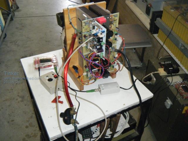

Here is a picture of my test set up:

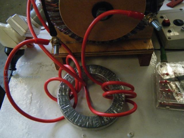

All my test were done with 4 turns for each primary leg on this ring ferrite core.
It did not seem to matter if the turns were untidy, as long as the wire went through the hole 4 times.
Both coils were wound in the same direction but connected at the opposite ends to the primary.
Later I experimented with fewer or more turns with a 2KW load. 3 turns at each side is still OK. The slight wiggle at zero crossing gets a little more pronounced with every extra turn above 4. I tried up to 6 turns each.
That ring core is soo much more user friendly for the experimenter. I used it because I did not have an E65 ferrite core and was pleasantly surprised.

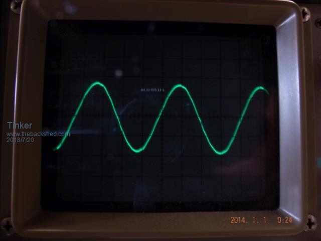

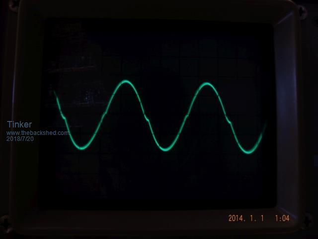

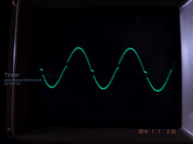

Idle current test with a 0.8uF capacitor at the secondary:
0.2A and this wave form. BTW, I used a long exposure so the slight fuzzyness of the trace is camera shake.
With a 1uF or a 2uF cap the idle current did not change, nor did the sine wave.
A 4.8uF capacitor drew 0.22A and the sine wave straights got a little wavy.

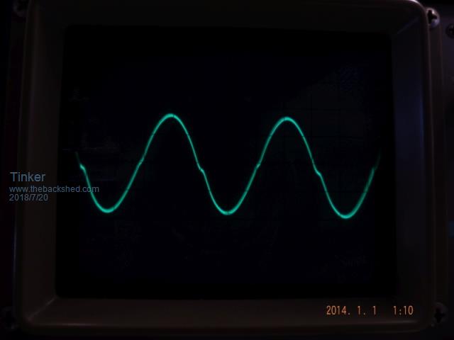

A 7.4uF cap (the black boxy type out of the Aerosharp) drew 0.27A and had a little worse wavyness.
Load test with 2KW with 0.8uF cap had a small 'kink' at the zero crossing.
This 'kink' got more pronounced as the capacitance was increased. Here at 4.8uF.

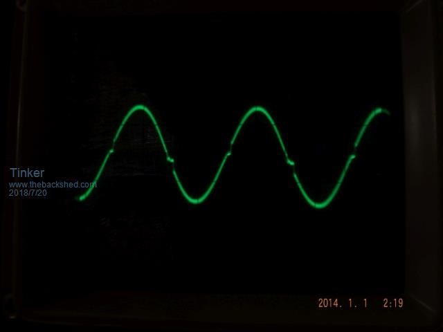

I should mention that all the load tests above had the big non saturating choke in series with one primary as well. This has 18 turns wound over doubled Aerosharp C cores, the bigger ones.
To see what happens under load when it is not there look at this image.

I will also wind another choke to suit the single big C core I have left over. I should be able to fit 11 turns totaling 45mm sq (many wires in parallel). I have a 150 turn test coil that fits this core and tomorrow should find out the saturation figures for a single C core with the original 1.6mm air gap.

Posted: 09:53pm 20 Jul 2018
  tinyt said   Is that what they call common mode choke?
It looks like a common mode choke, but there is one very big difference that has to do with the phasing of the two windings.
A common mode choke is wound so that dc flowing around the circuit cancels out in the core, its not what we want. Current flows around the circuit start to finish in one winding, then finish to start in the other.
We need a split choke that continues on around the core in the same direction, but with a break in the middle of the winding (where the primary is connected).
Its very important that you get the winding directions right or the choke is not going to do anything useful.
If you have any doubts about this, just build a simple choke with a single winding and connect it in series with the primary.

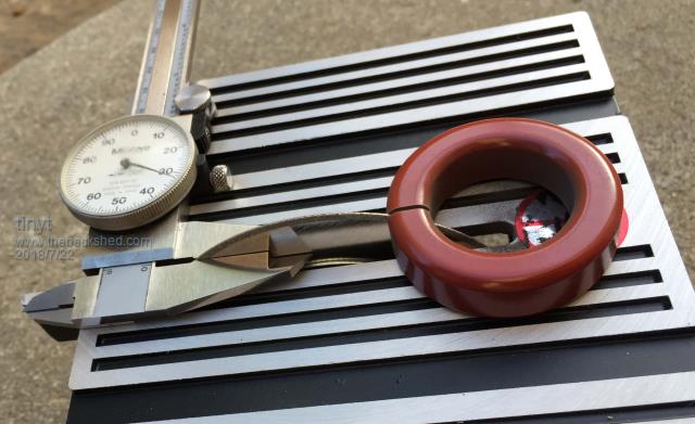

  tinyt said   I wonder if a gapped ring ferrite can replace both the Exx ferrite and laminated C-core chokes.
I think cutting that ferrite ring to create a gap is asking for it to break elsewhere too. Ferrite is brittle.
As it is its easy to wind thick wire around it and it does the job.
The inverter runs fine without an added gapped iron choke but the non saturating feature of this is very nice to have.
Perhaps Klaus could test that one on it's own.
Tried cutting:
This is the saw that I used Mini saw with diamond dust blade , bought it to cut pcb. Now it has another use.
Maybe after cutting, restore the structural strength by filling the gap with epoxy? The magnetic gap will still be there.
If the gap is too wide, it can be made magnetically narrower by filling it with iron filled epoxy. You can make your own proprietary mix using iron fillings or use ready made steel filled epoxy like J-B weld steel reinforced epoxy.
Adding this to my testing to do list if and when I complete my inverter.
Edited by tinyt 2018-07-23
Posted: 07:49am 22 Jul 2018
Yes, a diamond saw is the way to cut it - I do not have a blade like that.
I think you still want two different chokes but let us know how how the one above performed. It looks a bit too small for a decent wire size.
The one pictured in my post is 120mm OD, 80mm ID and 22mm high.
