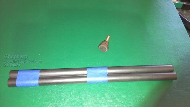

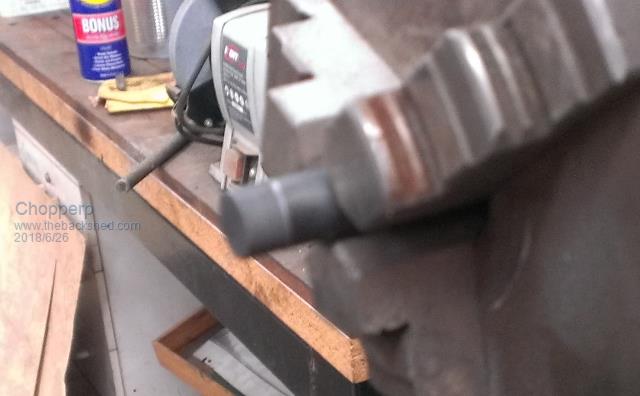

Success!!!

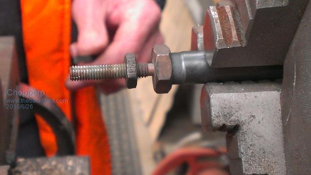

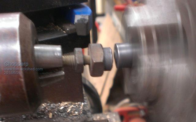

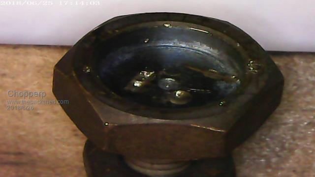

We machined the rod down until it was just bigger than the well in the bolt head.
We then put a bit of a bevel on the end
The bolt was then placed in the tail stock of the lathe & we gently forced the head onto the rod. The rod was then cut off.
With the rod out of the chuck, we used the tail stock again to force the carbon right into the head. It aint coming out.
Two were done today, 8 more to do (includes a couple of spares).

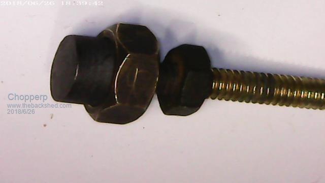

Many thanks to all who contributed to this exercise. I'll post some piccies of the contacts in situ.
Old pad removed from the head. Couple of drill pot holes there.
Blurry photo of the rod after being machined
Bolt pushed onto the rod
Bolt loosely held in the chuck while the rod was cut
Finished item

Looks great,
I really thought the rod would shatter under pressure , hence suggesting heating the head, but I am impressed..
They look great..
Posted: 09:46am 26 Jun 2018
I am double impressed !
Very nice work Chopper.

Thanks guys for the comments. Pushing the bolts onto the machine rod was an experiment which did work.
ChopperP

Well done Chopper.
It does look on the top picture of the machined brass head ,
That the brass head has been upset by some pressure after the carbon rod was inserted.
Cheers john

Hi Johnmc
Thanks.
One of them was slightly bent. I think that this was a pre-existing condition. Not a major problem.

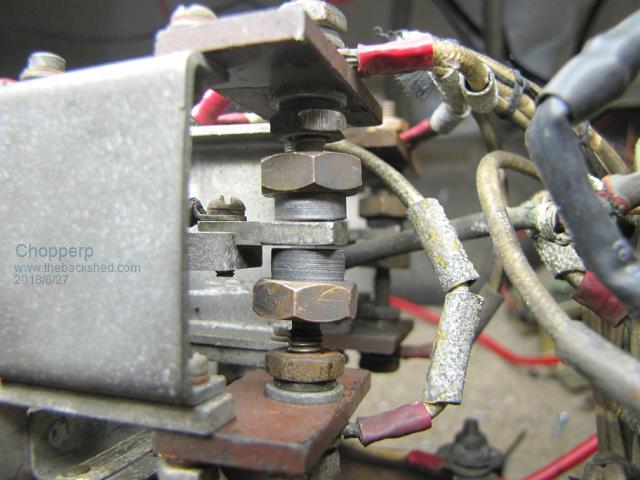

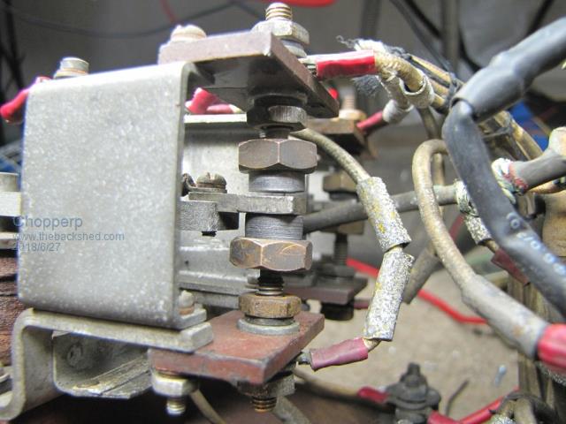

Posted: 12:21pm 27 Jun 2018

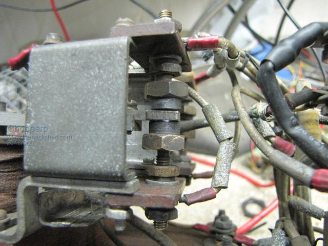

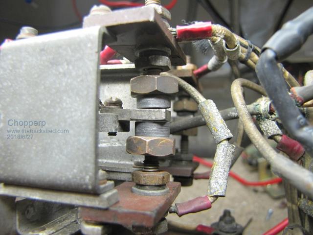

Removed the old contacts & installed the refurbished ones in the current limiting relay. Gave the pads a bit of a 'polish' & set the gaps to the required 25 thou with the armature roughly horizontal.
Connected my test set up & at just over the required 31A, the bottom contact opened & hovered between the top & bottom contacts. In operation, this will cause about a 75% drop in the generator's field current, reducing it's output.
At 33A, the top contact fully closed. When this happens, the field current is totally inhibited, cutting the output altogether.
The reverse occurred when the current was reduced.
This is how I had it set up with the original contacts. Good that things stayed the same.
The current is set by the armature return spring tension & the differential (hysteresis) by the vertical position of the contacts. Much fun. In normal current limiting operation, the relay will 'work' mainly on the top contact.
Some piccies below FYI. The set of contacts in the background to the right are for the voltage regulation. They're next to be done.
Contacts in the 'Rest' position. Current below 31A
Current at about 31.5A. The armature sits between the two contacts.
Current at 33A. Top contact closed.
Current just above 31.5A. Some arcing evident on bottom contact

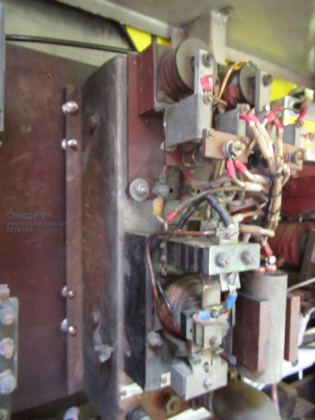

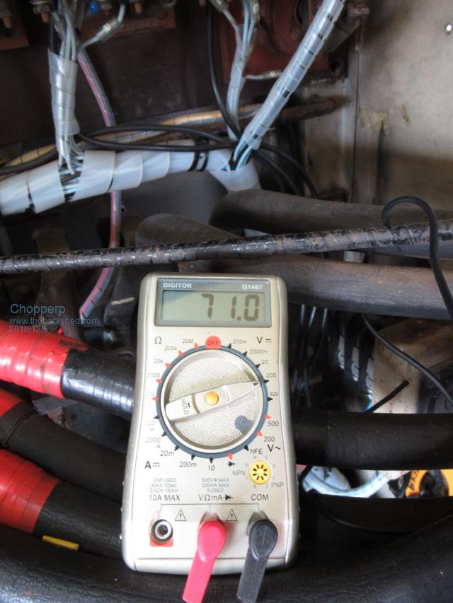

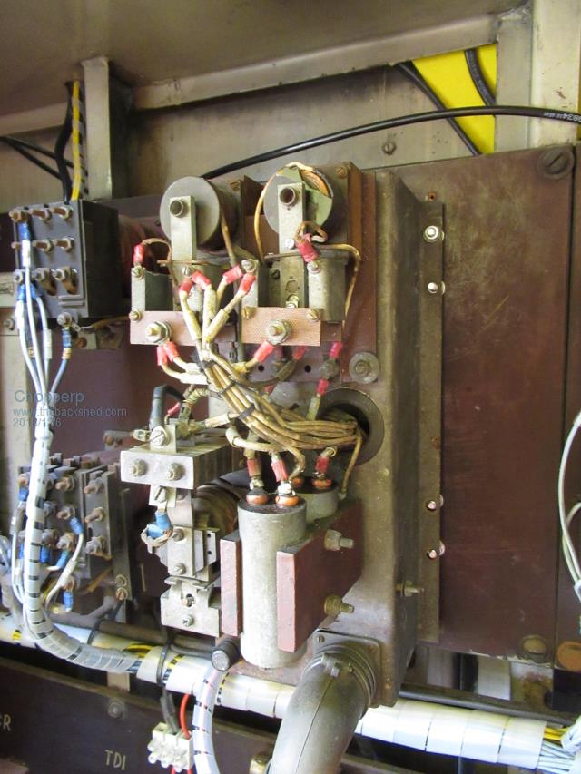

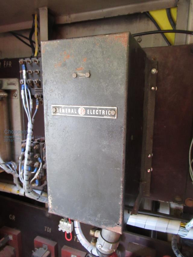

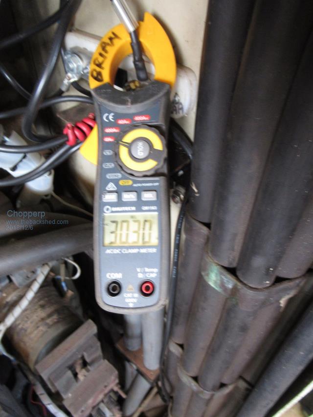

I finally got around to testing the regulator in the Loco.
I couldn't quite get some of the voltage regulation specs listed in the instructions on the bench so I sort of left it at that. No immediate need for it.
We will now need it for checking the Loco in came out of next week at another location so it required a real test.
I fitted it to our working Loco & got a qualified off-sider to fire the Loco up for me.
Happy to say that it worked quite well.
The idle charge current was not quite as high as the one it replaced but it came up & limited to about the 33A limit with the engine revved up a bit & stayed there while the voltage was low.
The voltage steadily rose & started regulating a bit below 70V (cover on) with the current dropping of course. Slight adjustment needed to bring it up to around 70V.
The regulators were swapped back again after the test.
I still have to replace the carbon contacts & do a full setup on the main unit. Two spare old contacts have gone AWOL so I won't be able to do a direct replacement of the 4 contacts.
Also, we will have to make up another cover as one is missing.
Some photos.
Regulator: Temporally Mounted with Cover
Regulator: Cover Removed RHS
Regulator: Cover removed LHS
Output Voltage with Cover Removed.
(Drops when cover fitted)
Output Current Falling from 33A Max.
(Voltage Regulator Operating)
