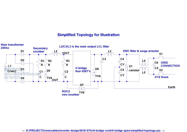

Posted: 05:50pm 19 Jul 2018
Yes you are quite right but when not operating there is a substantial LC filter between the grid and the H-bridge as well as a standard EMC filter / surge arrestor. I have drawn a topology diagram I just hope the site is nice enough to let me load it :)
Unfortunatly the 25Khz is completely asynchronous to the grid and would not be feasable to phase lock, Exactly as you say the phase of the interrupt strongly affects the amount of energy stored in the inductor and would be one reason for the apparent randomness of the failure! However as you also mentioned if I can snub the energy in an RC then there is far less if any to be dealt with by IGBT avalanche.
I hope the topology diagram is visable, I think it is potentially unique (position of H-bridge in LCL) and solves many other nasty problems.
As it loaded that png I tried the inductor ring again but nogo, maybe its the density of the plot........

Posted: 09:24pm 19 Jul 2018
Its certainly unique, and current drive has rather a lot going for it.
Direct mains connection is a bit of a worry though, as there is no way of specifying how high voltage spikes may go. Some years a go we connected a Dranetz mains analyser up, and (microsecond) voltage spikes of several Kv were surprisingly common.
Not a lot of energy there as the pulses were so brief, but still a concern.Edited by Warpspeed 2018-07-21

A picture is worth a heap of words. The last grid feed inverter I worked on used a self commutating FET bridge (no logic or uC was used) a 500V FET died...no surprise.
One aspect I liked though was that there was a small dead-band at the zero crossings so shoot-through was not possible. From memory it had a front end push pull converter and it monitored the mains differentially and used that as a reference signal to modulate current from the push pull converter on the primary side.
The 5kV spike effect you saw, if I understand correctly, by open-circuiting between the current source and bridge stage is probably not truly representative of the failures you are having, as current interruption should be occurring near the zero crossings at low/no current ideally. With the series switch, it could be openened much further from zero with higher currents flowing & much more spectacular results.
If the IGBT bridge is controlled by software is it allowable (near the mains zero crossings) to stop the front end current source and then commutate one side of the IGBT bridge off and then commutate the other side on and then re-enable the current feed. Alternatively if that cant happen could an IGBT be placed directly across the output of the 25khz bridge rectifier (a current shunt) but can only be activated for the time around the zero crossing, when commutating from one leg to the other of the IGBT bridge.
I know that last bit sounds drastic but the current & voltage from the 25kHz current feed should be at a minimum then so little power is actually passing through the current shunt. Although there may be a small increase in signal distortion from your grid feed near zero crossings, in the scheme of things it is of little consequence?
What happens if the mains feed to your property open circuits due to a line fuse blowing in the middle of high current flow through your bridge ? Could that also be an issue? Too many questions...sorry

zaphod
Joined: 03/06/2018
Posts: 93
Posted: 08:58am 21 Jul 2018
  wiseguy said   A picture is worth a heap of words. The last grid feed inverter I worked on used a self commutating FET bridge (no logic or uC was used) a 500V FET died...no surprise.
Yup well first up there is a dead band enforced by the zero-cross detector that consists of two detectors one for +half cycles the other for - that cannot overlap, on top of that there is an output from the pll that disables the bridge when it thinks it is zero cross and the pll directly controls the smps ensuring it ramps towards shutdown and back up again around zero-cross so all the mechinisms are there BUT for some reason something occasionally goes wrong (and yes it could also be crap software I am renowned for not being the worlds best coder) :(
Yes I do like your IGBT shunt idea that would certainly be belt-n-braces but nothing wrong with that however if its a pll glitch and the pll also controls the shunt IGBT.......
The line fuse could happen and in fact we often get power losses during storms but usually the re-closers succeed in sorting it out! Of course this whole inverter impliments anti-islanding so it drops out on the first outage, not gonna worry me as not much sun around usually during a storm hahaha
I agree it is unlikely the H-bridge should open during high power output BUT I am doing the usual clutching at straws because ATM I cannot think of any other reason for a 1200V IGBT to blow :)
I might try increasing the deadband around zero-cross as there are already lots of waveform problems around there and like you say adding a little bit more isnt going to be noticible, with these particular IGBT's RBSOA=FBSOA so turning the wrong bridge legs on is not an issue and it is impossible through hardware to turn on more than one diagonal at a time or even the wrong diagonal......in theory :)
One other posibility is the inteferance causes the bridge to bounce (multiple on-off transitions) and this is doing the damage, however to add a latch that will work under all possible power situations is not easy so I will leave that one as an as yet unclutched straw!
In the meantime when the parts eventually drift along to my remote location I will try the snubber first :)
P.S. I once saw a half drawn schematic of that self-operating H-bridge so completed and simulated it, I think I concluded that no matter how you tuned the components it was a wish-and-prayer job and not something I wanted to pursue further, I believe it is used in certain far eastern products :)Edited by zaphod 2018-07-22

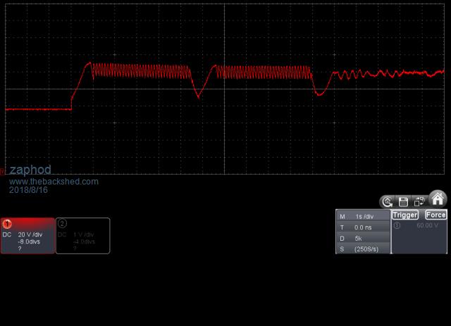

Worked like a charm that just goes to show EMC is a black magic art!
Now just have a crop of issues concerning the shared DC-link voltage to resolve, the booster generates the voltage according to both MPPT and export power trying to maintain 180V. The current source inverter increases power delivery till the buss voltage falls to 174V. The booster has an overvoltage trip around 195V & the CSI an undervoltage trip around 150V.
Well due to the dynamics and reaction times there are a few hiccups to fix, here is a typical overvoltage trip (booster locks out for ~7 seconds):
Here is a CSI UVLO event as it tries to restart (at 5 second intervals) followed by a sucsesful start :
This is an interesting wierd sequence I have yet to fully quantify:
Hope you find this lot entertaining, one major change compared with running the German job is the DC-link reservoir is ~1/10th the value so the dynamics need some tuning :)

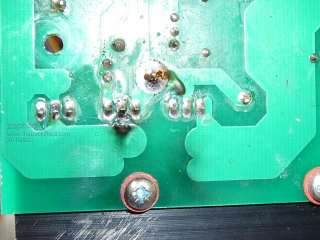

Posted: 12:56pm 23 Aug 2018
I didn't have time to do debugging as busy with other things but after a day or so noticed solar system not working, diagnosed to CSI shorting out auxillery 12V supply so removed and replaced with standby unit again. On bench CSI dissasembled and proves to have blown track of pcb where DClink+ feeds drain of half-bridge mosfet pair who'm on inspection are both s/c all 3 terminals so sadly dead! This unit has worked forever on the bench so suspect death caused by persistant overvoltages, that being the bus hitting 190V+ so I should have fixed that problem instead of leaving it installed and unfixed!! The mosfets are IRFB4227's so working pretty much up at the top of there voltage range. May have taken out the IRS2110 driver too as there's definetly a resistive short on its supply rail.
Probaby a moral along the lines of don't start something you dont have time to finish properly, or don't leave something half done etc etc. Backside hurting from own kicking hahaha
PS this also illustrates the problems of trying to use TO220's for high voltage and power, you run out of copper area due to tight clearances and in this case not using the topside due to the heatsink being flush with the pcb.Edited by zaphod 2018-08-24

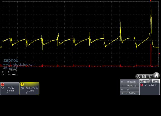

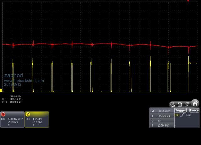

Posted: 08:36pm 11 Mar 2019
I do apologize I seem to have started another thread (letterbox converter) instead of updating this one! Well the above blow up proved to be very expensive and time consuming indeed as not only the fets were blown but worst of all the IRS2110 driver was destroyed in such a way the high voltage ended up connected to it's vcc that took out all sorts of other ancillary components connected to the same vcc rail (12V) :(
After much investigation I discovered the overcurrent detection was not working as it should combined with occasional sub-harmonic oscillation causing the transformer to saturate hence the severe overcurrent condition.
I was warned about all this by a strange ticking noise coming from the transformer during operation but chose to ignore it on the basis it was handwound so what did I expect! After fixing the sub-harmonic problem it runs soundlessly......
Cheers Roger
1Kwp DIY PV + Woodburner + Rainwater scavanger :)

Hi Roger, I was recently looking into a strange effect in my saturation tester which uses the IR2113 (same as 2110 but 600v not 500V). I noticed a weird effect as I was increasing the pulse duration (driving a large choke inductor) where suddenly heavy current was drawn from the supply voltage.
The output high side driver was driving the upper Fet on continuously - essentially un triggered - the input was low at this point. On the HO pin the Cro trace was continuously high except an ultra narrow low glitch appeared at the in high transition (Hin pin when it was driving the HO pin on (despite that it was already on)), pulse train was ~ 50% duty at the time. I found an IR application note AN978, top of page 9 describes the issue and cause - VS pin momentarily exceeding 5V below Com pin from inductive effects of load, layout, trace lengths etc.
In my case I cured it by installing a 4R7 between the bootstrap capacitor/VS node and the actual VS node of the Fets and added a UF diode between ChipVS and chip Com (anode to com) to clamp negative transitions at ~ 0.7V, the 4R7 was to minimise peak current through the added resistor. I know this is effectively added gate resistance in series with the FET gate drive circuit but didnt hurt operation - it already turned off too fast.
Maybe not the cause of the ticking you heard but good to be aware of - totally unexpected behaviour. If inductor saturation was your issue it could have caused this? Hope this makes sense - I should be asleep already.....
My circuit is a half bridge flyback circuit where both upper and lower Fets are driven on together with a winding also in series, but for a conventional half bridge converter where the upper Fet is latched on, the implication for driving the lower Fet on sounds scary.
Maybe also explains some inverter failures here, as the IR2110 is used a lot and sometimes connected to the power stage FETs through ribbon cables !Edited by wiseguy 2019-03-14
Cheers Mike
zaphod
Joined: 03/06/2018
Posts: 93
Posted: 07:42pm 12 Mar 2019
Hi Mike, Ouch that was a nasty problem you had there! I was aware of it's ability to do that having read the same app note, it also likes to UVLO the top driver too :) I have so many scope shots but I did actually trace the trafo sat to sub-harmonic oscillation and having fixed that the trafo no longer saturates, see the scope shot for the unequal conduction periods, this being a half bridge the results are bad!!.
I am astonished peeps would connect fast fet drivers and there fets with ribbon cable (that implies to me at least significant length) OMG! My layout is very tight as shown in the pic below, driver (U2) and fets (Q1/Q2) within an inch or so!
I think maybe my peak currents are lower than yours so I have not as yet suffered the com/vs problem but it's a very nasty gotcha to watch for. I hope everything is sorted in your saturation tester, blow-ups can be expensive and very time consuming to do the repairs let alone work out what went wrong!
Edited by zaphod 2019-03-14
Cheers Roger
