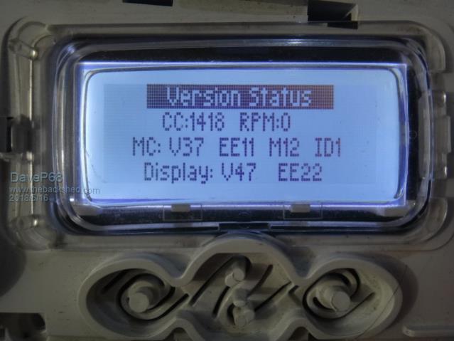

In the past I used a Fluke multimeter in frequency mode to measure RPM.
Now I use a Fisher and Paykel motor controller board with only the RPS unit connected (motor disconnected) to show RPM. When in diagnostic mode it can give you the true RPM reading. These F&P motor controllers aren't isolated so all connections in & out of the board are considered at mains (230 VAC) potential!!
Here's a display module connected to a motor controller I use to measure RPM.Edited by DaveP68 2018-05-17

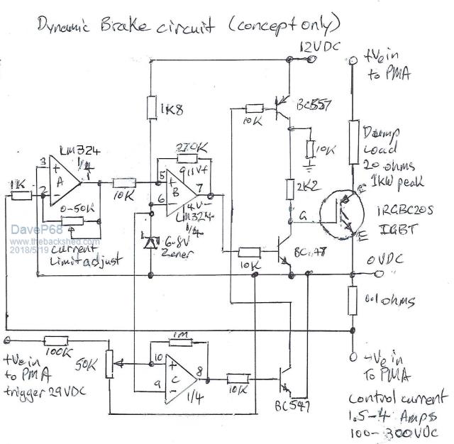

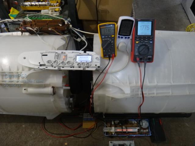

Here is a modified version of the dynamic brake circuit that has a voltage control setting as well as current. Yes it's still pure hardware control and is "concept only". Both the op amps I've used LM358 & LM324 aren't meant to be the long term solution for this circuit to work well due being not fast enough/low slew rate.
Also here is photo of my dynamometer with the dynamic module (blue) in MPPT mode.
The white bread board very bottom of photo is the control logic circuitry with a MPPT table sorted in a EEPROM.Edited by DaveP68 2018-05-20

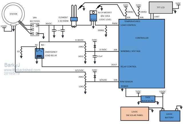

Here is a bit of a diagram of what I am planning to do.
I may as well share it, and see if I can get some feedback from you experienced people. Potentially a different way of doing things compared to what has been done here, but potentially not. Not expecting this to be new, but I havent seen quite a setup yet.
This is just a concept at this stage.
Any concerns or obvious mistakes, please please speak up. Would love input, but so far I am quite happy with what I have here I think, but very much open to constructive criticism as I have not done this in practice yet obviously.
Essentially, Stator into 3 Phase rectifier (wiring and quantity etc still to be determined, but the end effect is the same). This then goes into some caps to filter a little, but since its just going into an element it doesnt need to be super lovely.
Into the Element, and then that is switched in and out with the FET from the controller, based on voltage output and RPM information.
Main voltage through a simple divider with some level of protection to clamp it to 5V, and into the controller. Voltage will be sampled in time with the FET being engaged, so each sample is at a time of load.
RPM out of the stator pickups, into the controller.
Voltage out of the stator also goes into a relay into a dump load, so if anything happens with the controller (such as the battery dies) then the dump load will engage and save the world...
Controller is run off a 12V battery, which has an old car solar panel on it to maintain it. This is then regulated to 5V to power the controller, and also the LCD which will display all the infomation about the system.
I will then also monitor temperatures of the FET and the Element, maybe other things, with some thermocouples
Thats the plan so far. Edited by BarkyJ 2018-05-20

Circuit looks good and can't see any reason for that not to work as planned as long as the F&P stator are configured correctly.
One very important detail that can be overlooked on F&P stators is they have a limited output current.
At maximum current the stator will go into saturation and the torque drops off, so be warned don't go there!! That drop of in torque on a wind turbine will result in blade over speed (runaway) and could result in it destroying it'self...
The optimum current as a rule on a Star 36 pole copper stator with black cap factory standard is 1.62 Amps DC out of the rectifier. Saturation occurs at about 40% above the optimum current level. I personally wouldn't let the current go any higher than 20 % above the optimum current level.
Can see the stator in the photo is wired as a 2x6C Star.
A 36 pole copper stator with black cap wired in Delta mode the optimum current increases to 2.8 Amps. Output voltage drops down by 57.7 % respectively.
When the stators are rewired into other configurations such as 2x6C, 3x4C, 4x3C, 6x2C or 12x 1C the output current can be increased with a resulting drop on output voltage.
To achieve 1 kW of power output at around 500 RPM from 2x F&P stators they must both be wired 4x3c Delta with the operating voltage being around 45 VDC with 22 Amps DC.
Any deviation from this configuration will not give that output power due to load mismatch.

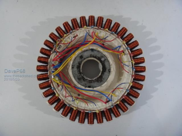

Here is a photo of a 6x2c Delta stator that I wiried up last year.
Will go into more detail in my next post as to why these operate the way they do.Edited by DaveP68 2018-05-21

It's just an example photo of how to wire a stator in Delta, as I didn't have a photo of a 4x3c wiring setup. Sorry about the resolution, as it's within the forum guidelines.
If you use the colour coded Red, Blue, Yellow wires like I have, less chance of making a mistake (Delta wiring is a bit trickery).
Remember Delta is in a triangle configuration of "Red Phase A end connects to Blue phase B end", "Blue Phase A end connects to Yellow phase C end" & "Yellow Phase A end connects to Red phase B end".
There's enough detail there for you to follow the concept of how to wire both of your 4x3C Delta stators.
Will provide more detail on how the current flow works in these F&P stators next post.
