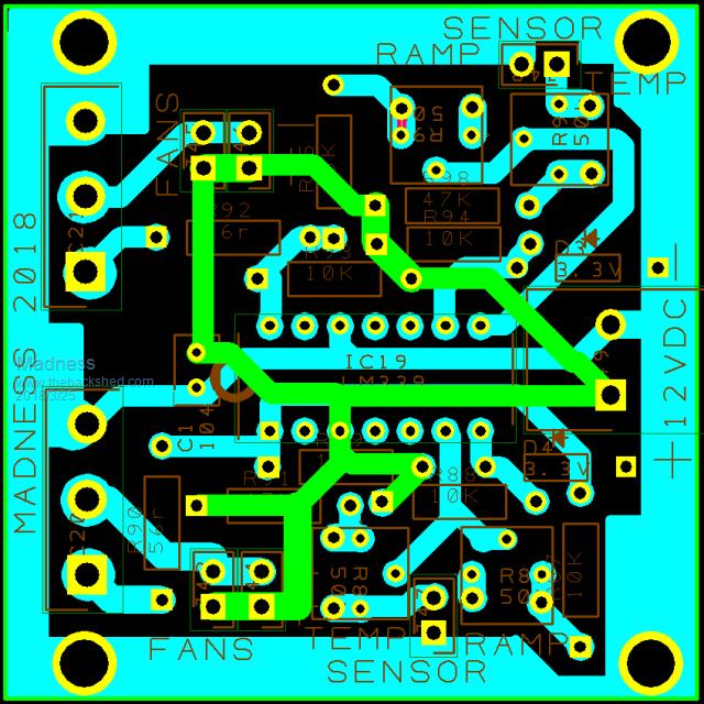

Here is the 2 Channel Fan Controller 50 X 50MM PCB. $4 each
Sensors are 10K NTC Thermistors my inverter case is split in 2 so one side is for all the electronics and the other for the transformer. There is a temperature setting and ramp to set how rapidly the speed increases with temperature. Any N channel MOSFET will work, I use HY4008s that still work from a failed power board. You will need heatsinks and it will need insulation if common to both FETs.
Parts are
1 X LM339 & Socket
2 X N Channel MOSFETs
2 X 3.3 V Zenere Diodes
4 X 50K Trim Pots
RESISTORS
6 X 10K 0.5W
2 X 47K 0.5W
2 X 56R 3.5W
1 X 104 Monolithic Cap
1 X 2 pole Screw Connector 5.08mm
2.54mm male pin header strip strip
1 12V power supply Like this.
Posted: 12:03am 25 Mar 2018

Forgot to say fan controller can be used for cooling anything, I use it for my GTI's also, instead of getting to 55 degrees and reducing output the GTI stays under 40 always.

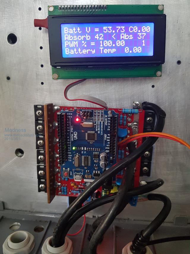

Thanks to Klaus AKA Tinker who sent me circuit for low voltage shut down on the control board. I have decided to add an Arduino Nano instead as it will allow better control with time below the set voltage rather than turning off with a brief dip below the set voltage. Also I will include optional auto restart after a delay of say 10 minutes. This would be preferable for unattended use so your fridge etc would still run if voltage recovers when the sun comes out.
Is there any other suggestions to make further use of the Nano.Edited by Madness 2018-03-26

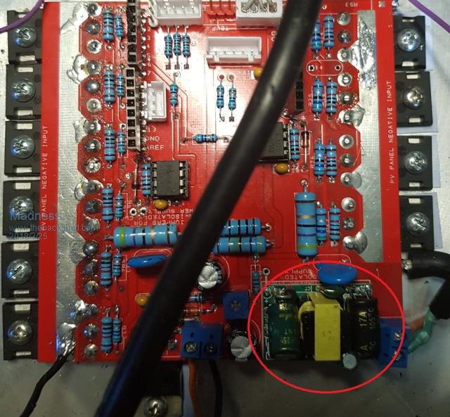

Here is a photo of the GTI regulator in operation, I did not have a battery temperature sensor connected at the time this was taken. It has temperature compensation included, regulation could be easily changed for various types of batteries. 3 X 15mm Copper bar on the left is connected panels DC to DC with PWM regulation. Right side is the high voltage DC regulation going to the GTI.
And another with the Arduino removed.
the red circle is around the isolated supply which is crucial for maintaining isolation from ground for the panels connected to a HF GTI.

  Madness said   Yes I was thinking about that, actually, the GTI regulator is running really well since I divided the Drains for the 2 MPPT Channels. All need to do is split the pads on the PCB, very simple fix. Anyone other interested? $8 a piece.

Posted: 11:16am 25 Mar 2018
Thats no problem Yahoo, turns out the change needed was staring me in the face all along. The first Bodgie version I built had the drains separated and it never caused any problem. In the end I went looking for what was different between them. It was just a guess on the first one that they should be separated, luckily I did that or I might still be turning on dump loads to regulate the GTI.
I don't know why it makes a difference must be something coming back from the GTI that caused the MOSFETs to short. They only failed when they started regulating one FET would short then there was no regulation just on hard all the time.
Anyhow as soon as I cut the track on the PCB to separate the drains it has worked perfectly ever since. Must be at least 4 months like that now, most days the regulation comes into operation, hardly even think to look at anymore, just keeps doing what is supposed to.
