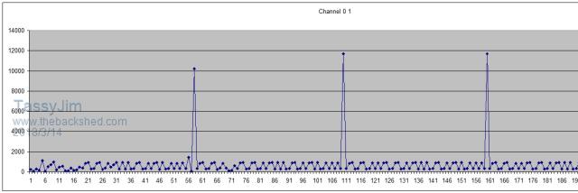

Posted: 06:36am 14 Mar 2018
That looks better.
I can read the file OK and found where the data started.
It starts at sample no ~5600 and runs for ~1000 samples.
You can easily see the short, long and sync timing in the excel chart
There are a few 'errors' in the first pulse train so that is good to have for testing.
I have domestic duties for a while but should be able to get a simulator going in a few days.
