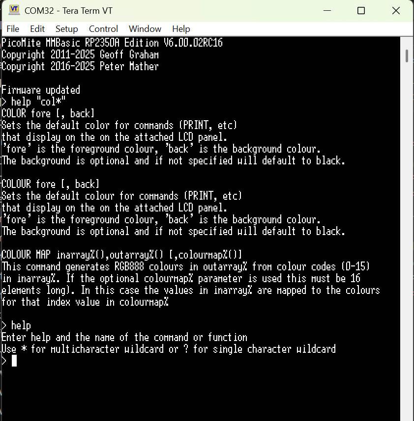

V6.00.02RC16 is available on
Fixes bug in GUI GAUGE
Fixes bug in SETPIN n,ARAW
Removes OPTION FAST TRIG ON/OFF as there is a bug in the Pico implementation of the C functions cosf and sinf so this is not reliable
Implements HELP [search_pattern$] command. See above.
HELP without a parameter just outputs the text:
"Enter help and the name of the command or function
Use * for multicharacter wildcard or ? for single character wildcard"
This looks for a file on the A: drive named "help.txt"
This must be formatted as follows:
~searchable_string
text line - recommend this is the command syntax e.g. COLOUR fore [, back]
text line
text line
~next_searchable_string
text line
etc.
There can be one or many text lines for each searchable_string. It is highly recommended that text lines do not exceed 80 characters in length
in the "search_pattern" use * for multicharacter wildcard or ? for single character wildcard
The command will output all sections (between the matching searchable string and the next searchable string) where the search_pattern matches the searchable_string
Edited 2025-04-19 01:23 by matherp

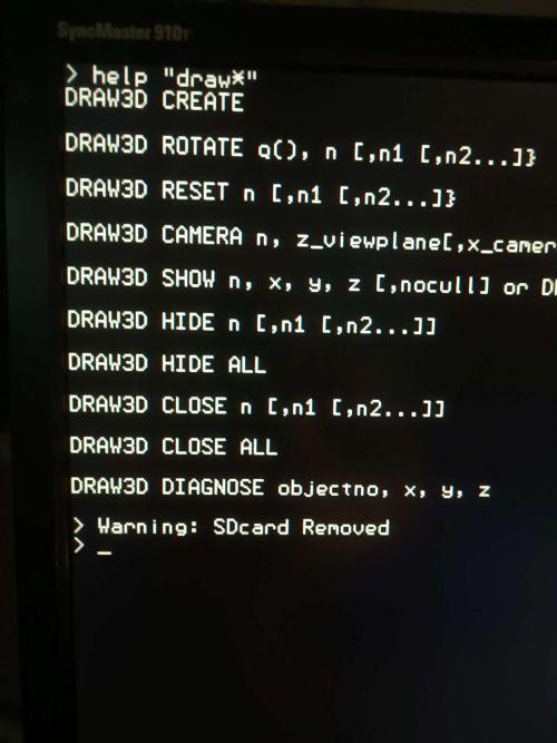

Posted: 05:42pm 18 Apr 2025
Draft help.txt 'build' here
help.txt.zip
Edited 2025-04-19 03:47 by electricat
