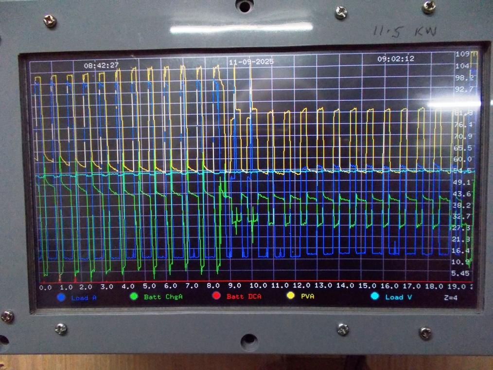

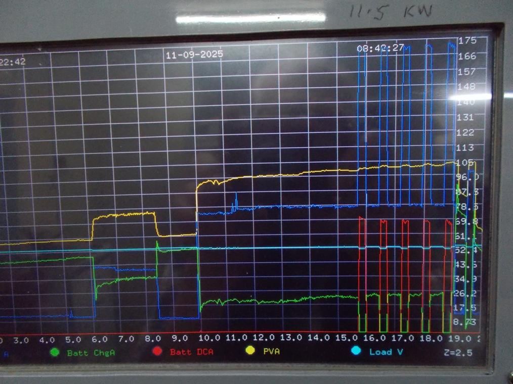

FYI a quick screen photo of the Ceramic Cook Top and other general loads.
Blue:   Inverter Input current.
Green:  Battery Charge current.
Cyan:   Battery Voltage.
RED:    Battery Discharge current.
Yellow: Solar Current.
Horz scale in minutes updated every second.
Vert scale in Amperes, and in Volts for Cyan trace (Battery Voltage)
Because of the single Vertical scale, these reading are slightly low. IE: Battery volts is actually 54V.
Below: DC current from Cook-Top cycling from 4.2kW to almost 10kW.
Below: Cycling from 640W <-> 5.4kW and then 640W <-> 3kW.

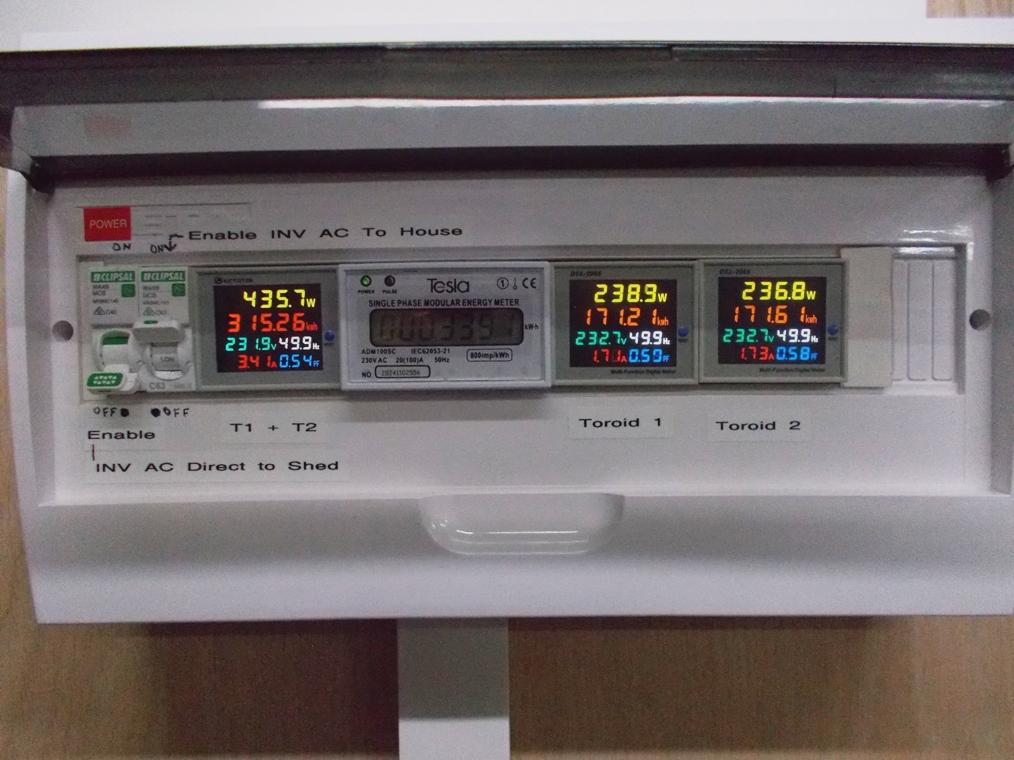

Below: The Inverter output Wall power Box, the Tesla kWh meter will accurately calculate Power down to very low power levels (PF does not suddenly go to .58 because of the inability of these colour multi function meters to calculate low Power PF.
The "INV AC Direct" switch was for emergency running with just essential devices, I have a feeling this may not be needed, but I have it just in case. These meters were reset recently when the new power box was fitted.

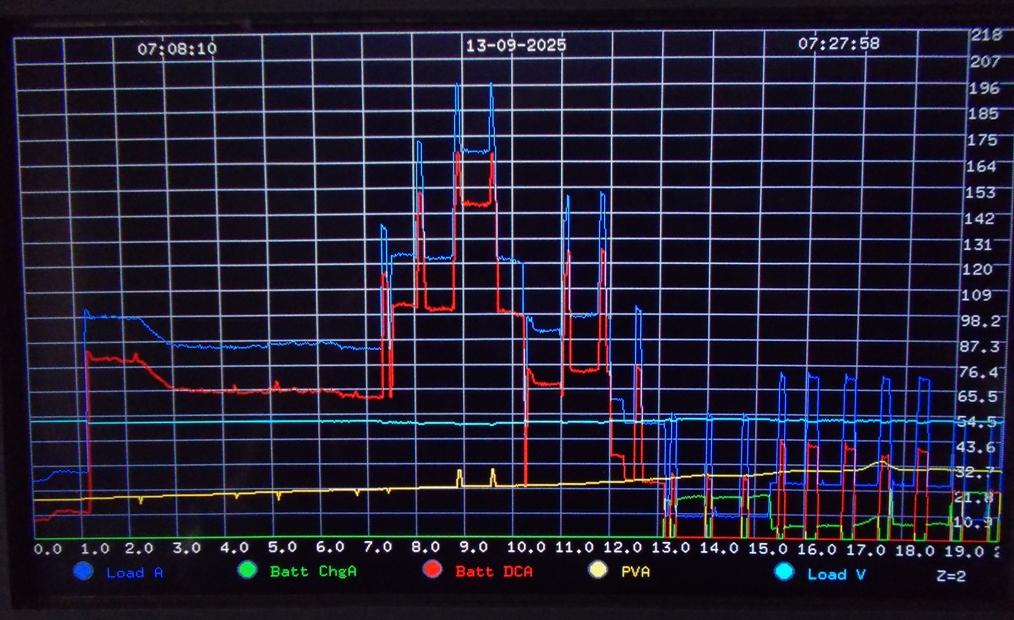

Overcast morning, at 7.18am screen shot of the Inverter peaking at 10.5kW, batteries at 73% SOC after overnight usage. It's now 8.07am, still overcast and solar output is at 3.7kW and rising. Lucky to be living in a good Solar location like QLD.

The power level of 10.5kW in the last post is wrong, it's actually much higher.
It's being clipped by the Maximum ADC input voltage of the ARM7. I built this 9" touch screen Solar monitor and coded it years ago. Just checking the circuit and code, there is a resistive divider on the input to keep the 500A Sensor voltage in range, it clamps the ADC input keeping the current to a very low value on overload and clamped at around 3.2V.
I need to modify that ADC input circuit and Code (resistive multiplier value) to read to at least 500A @ 3.2V in order to display the correct switching DC currents to match commercial Current Clamp meters, the down side is this makes very low current readings [< 8A] slightly inaccurate.

Posts: 3382
Posted: 01:44am 14 Sep 2025
You may be able to use a digital out/open collector pin to switch the range via another resistor in the lower leg of the divider and have the best of both worlds.
When the ADC value exceeds a suitable limit set the pin low.
When the ADC value falls below a limit determined the ratio of the two ranges set the pin high.
Your software could then either adjust the display to suit the range, or for maximum resolution on the low range, just change the trace colour to show when it is on the high range.

Posted: 02:03am 14 Sep 2025
Hi Phil, good idea and that would be easy to do as well, but luckily I put a big information header in the code file for various Hall Sensor sizes in the Series that I use.
I realized that all I had to do was to swap the 400A sensor for a 500A sensor and change a code define. The full scale sensor output voltage stays the same, but the Amperes per volt changes, with the 500A sensor my Limit is now 100A higher.
That is still not enough for the really big startup loads but should cover my normal household running loads, hopefully!
