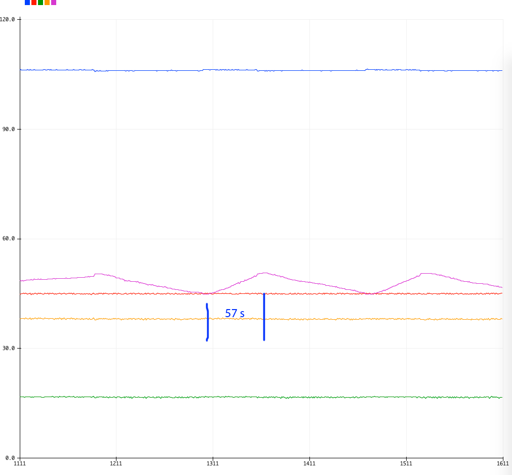

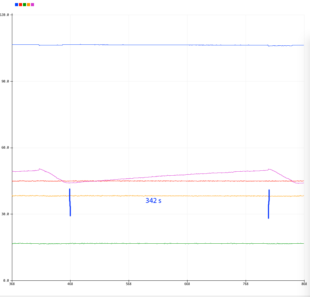

The test looks like this
We measure the time it takes for the heat sink to rise from 45 to 50C.
Purple is temperature.
Red is Vout
Yellow is Iout
Blue is Vin
Green is Iin
First is without the extra 75W, so this is the rise due to the dc-dc converter
when driving 1725W output.
It takes 342 seconds to rise 5 deg C
Now I add the 75W extra heat source. I located this heat source closer to the MOSFETS and diodes and further from the temperature sensor. This will give a fair comparison.
So adding only 75W makes it much faster, now it's 57 seconds to rise 5 deg C

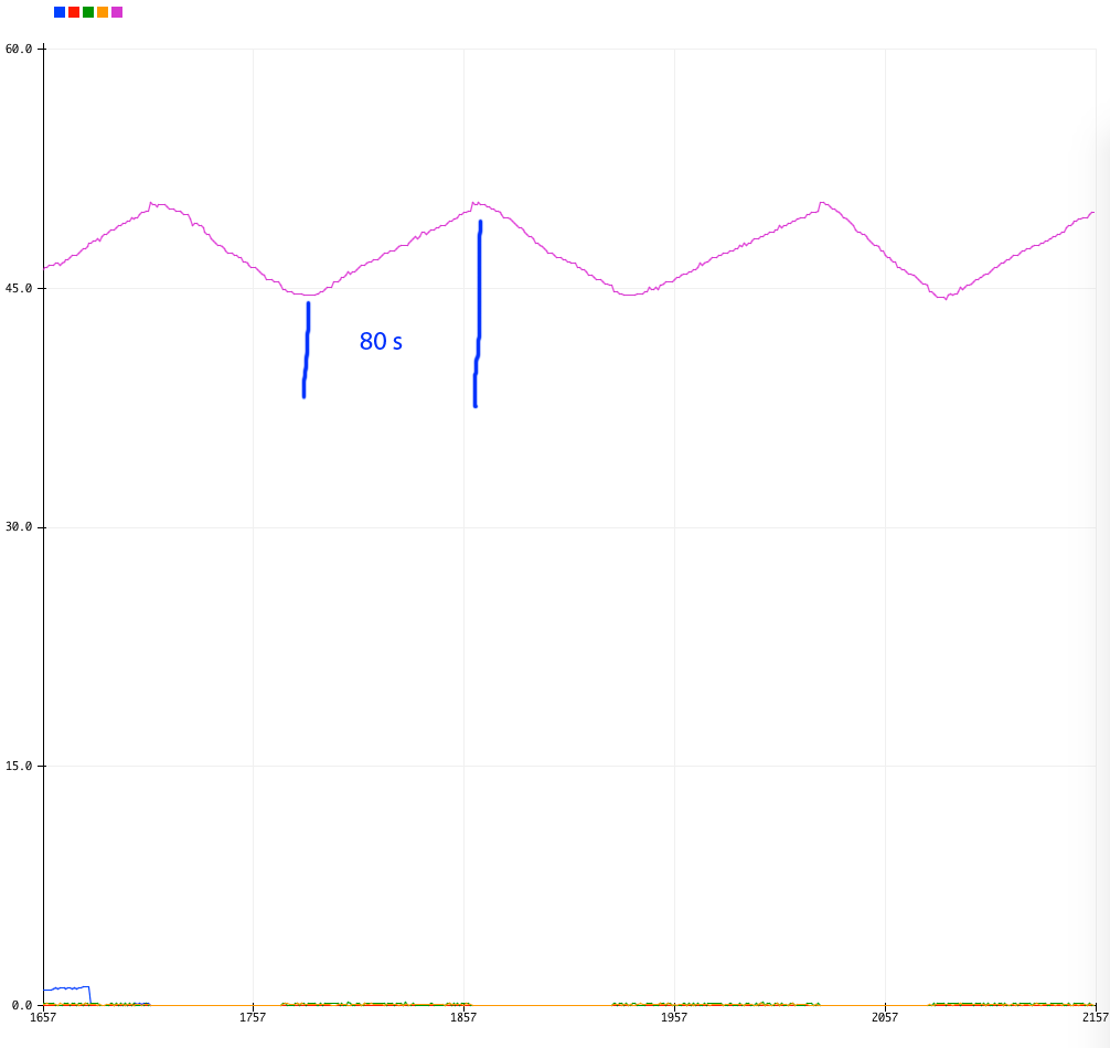

Finally here is the 75W heat source alone
It appears that just 75W is enough to raise the temp in 80 seconds.
Assuming that all this is linear (and it's not, but close enough for me with
this test) I can see that to raise the temp 1 degC it's 80/5 or 16 seconds
when fed 75W. A Joule is one Watt for one second. So the heat sink seems to need
16 x 75 = 1200 Joules to raise 1 deg C.
Now how about when we have only the dc-dc converter running?
It took 342 seconds to raise up 5 deg so it's 68 seconds per degree.
What power is this? 1200 J / 68 seconds = 18 W
So during this conversion (110V Input, 1725W output) there is 18W going into the heatsink.

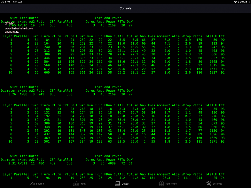

Well I have done the theory for a few different current settings and different windings.  I can calculate the diode and fet losses from the voltage drop of the diode at certain current settings - the same for the fet.  Most of my losses are in the windings of the inductor ( I assume core losses of 0).
Here are some of my calculations.
I have 45 Amps loss in the windings and about 47 Watts in the diode and fet combined using AWG10.  This gives 96% efficiency.  Efficiency decreases with current.
Persistence is the key

SYM-1:
I think 96% is as good as we can hope for.
Everyone will have a different result due to using whatever parts they have.

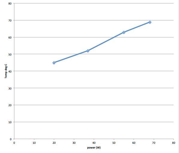

I put various power into the heat sink via the 2 x IGBT DC load and let things
stabilise, then took the temperature.
20W     45C
37W     52C
55W     63C
68W     69C
It looks like this:
Very linear so no surprises..
I think this seemingly too small heat sink will be more than enough
for my requirements which is 45A, at about 2500W.
I estimate even 63C at 55W will be quite acceptable operating conditions
for the MOSFETS and diodes. This 55W is well in excess of the heat produced from 2500W output.

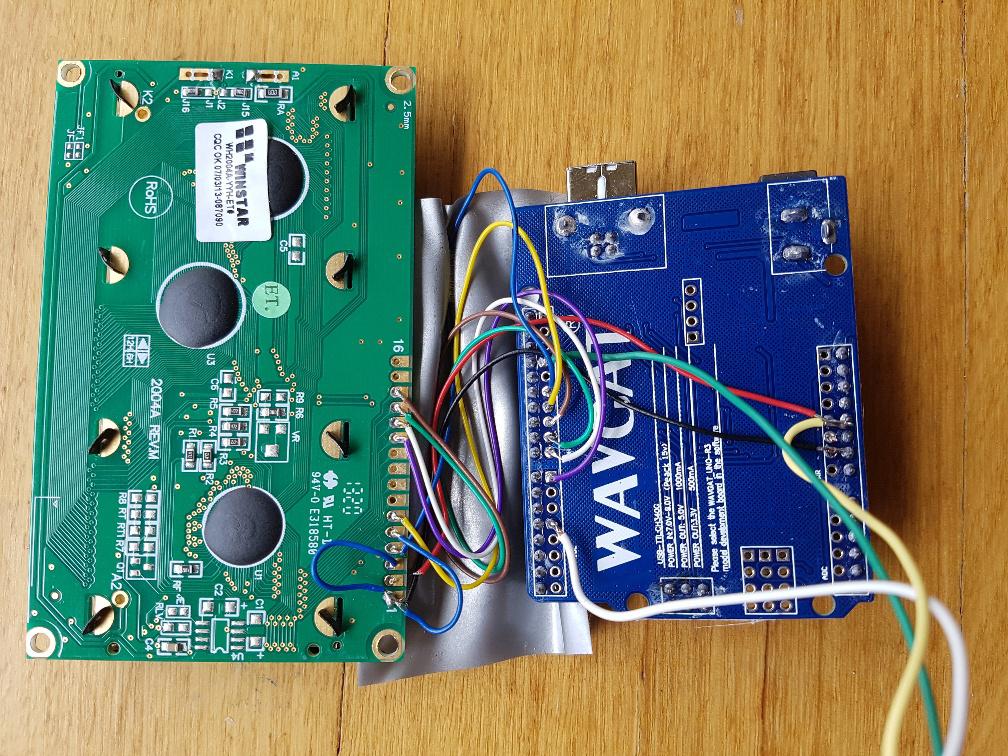

I used a 10K trimpot but a 5K or 1K would do

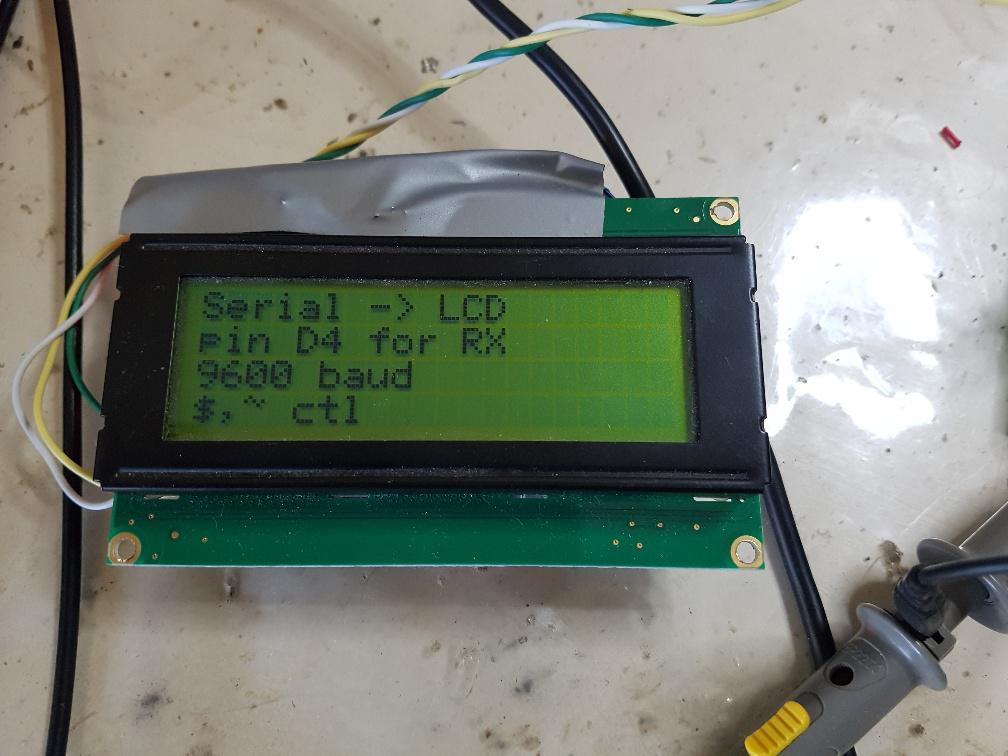

You only need the 2k2 resistors if you are going to use I2R LCD.
I don't want to support use of the I2R any more.
I want us to only use a serial type LCD which will be easy to make
(just uses one more Nano)

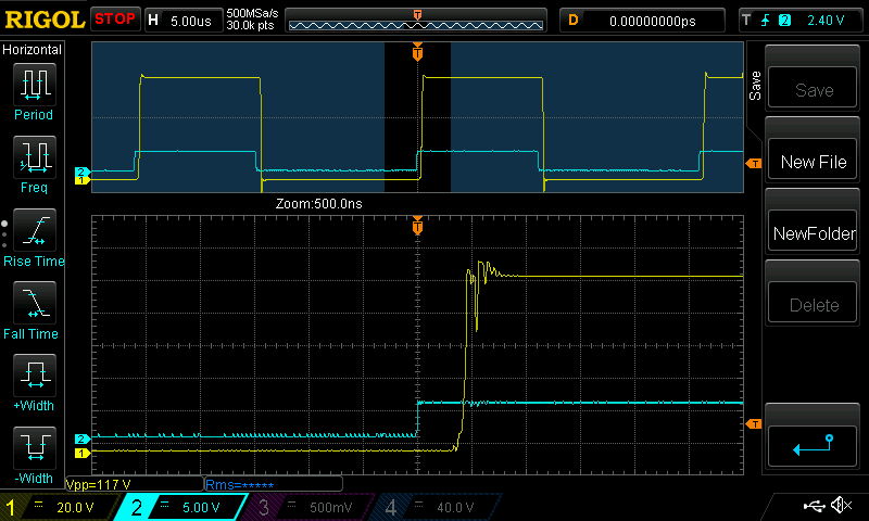

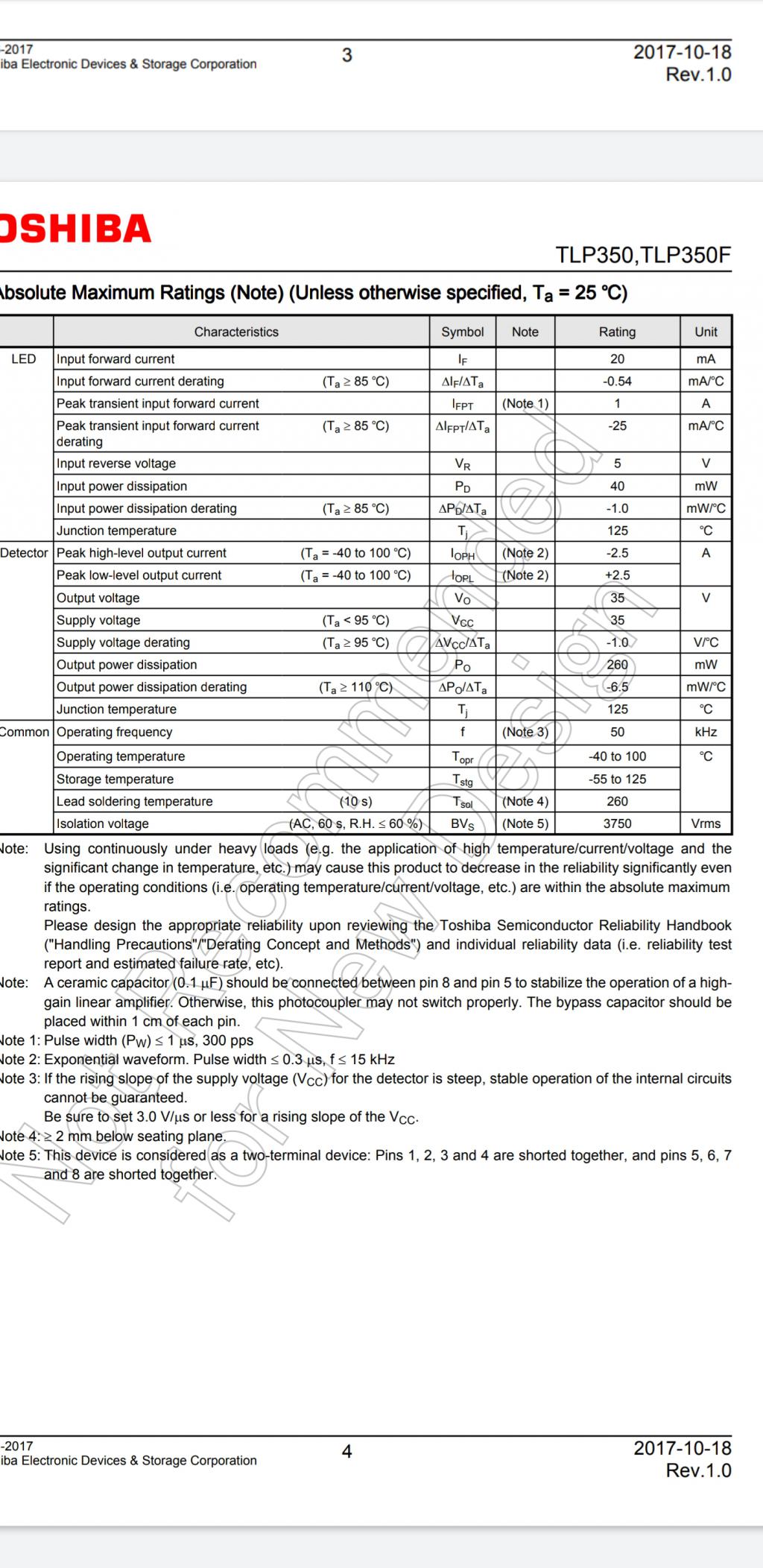

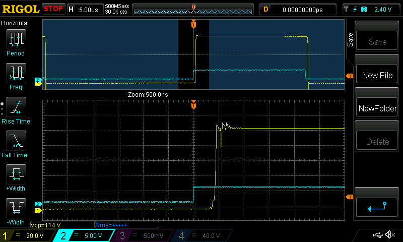

  wiseguy said
A word of caution, the FOD3180/FOD3182 will operate at up to 250kHz versus 25kHz for the TLP250 so if planning to try higher switching frequencies don't use the TLP250 unless you intend to use around 20kHz only.
Mike, I can not see any problem with running the converter at 40kHz.
There is the propagation delay of course but it is frequency independent.
The rise time of the switch node voltage appears identical compared with
running at 20kHz.
See below for tests using the TLP250. Only change is pwm frequency.
the "20kHz" is of course 19,200 Hz
and the "40kHz" is 38,400 Hz
The rather untidy oscillations might be reduced with some R-C snubbing.
Or smaller gate drive resistor, or a higher current drive from
the FODxxx. Time to experiment.

Also, can you run us through the serial fitting for the LCD?

poida
Joined: 02/02/2017
Posts: 1507
Posted: 04:56am 17 Aug 2020
to make a serial LCD:
You need a 20x4 LCD, a nano and a few bits of different coloured hookup wire.
If the LCD includes the I2C converter, then it's easier, only 4 wires to the LCD
and 3 wires to the mppt.
If no I2C, then it's 8 wires from nano to LCD and 3 wires to the mppt.
I have built both types, and there is no preference for either.
No I2C type:
3 wires soldered to 5V pin, Ground and D4. These could be twisted together and make them 1 foot long. Put a 3 pin connector on it so you can easily insert it.
Note well which is ground and which is 5V. I would use Red, black and white for this.
On the LCD we need to give 4 bits of data, the enable, the read strobe
and 5V and ground. The datasheet for the 20x4 LCD modules show the pinout.
there are 16 pins. We need only 1/2 of these.
1 = ground
2 = 5V
4 = register select, this is driven by the Nano when writing data
5 = Read/Write, we connect this to ground, for write only.
6 = enable
11 = data
12 = data
13 = data
14 = data
pin 3 needs some care, some LCD require a voltage between 0 and 5V to give good contrast via a trimpot, others can be to ground, or to 5V. Your module will differ from mine.
The one pictured needs it to ground.
The nano LCD library knows 6 pins need to connected, it only wants to know which data pins are connected to what LCD pins.
I have chosen:
Nano D12 - register select, pin 4
Nano D11 - enable, pin 6
Nano D7 - data bit 4, pin 11
Nano D8 - data bit 5, pin 12
Nano D9 - data bit 6, pin 13
Nano D10- data bit 7, pin 14
And 5V and Ground, with two links from ground to pin5 and pin3 on the LCD.
code specific for serial to LCD using the above wiring
nano_serial_to_parallel_LCD_2.ino.zip
Here is how I did it with one of the Wavegat boards you gave me.
White is serial data, Green is ground, Yellow is 5V, all leading off
bottom right.
When using an LCD module with I2C, it's far simpler.
connect the 3 wires as above, 5V, ground and D4.
Then connect the I2C interfaces together, 4 wires. It should be easy.
Nano A4 = SDA
Nano A5 = SCL
5V and ground..
Then use the below code to run it.
You will need to know the I2C address of the LCD module and alter the program to suit.
nano_serial_to_i2c_LCD.ino.zip
Both programs use the same trival protocol.
9600 baud
every character sent is printed in turn on the LCD.
If "$" is sent, move cursor to top left corner.
That is all we need for the mppt and the nanoverter.
If it all goes well, once this gets 5V, you will see this
Edited 2020-08-17 15:05 by poida

On the tlp250 issue, the tlp 350 is literally pin for pin the same, with the same input / output current etc... but will happily run up to 50khz
Attached is a pic from datasheet..

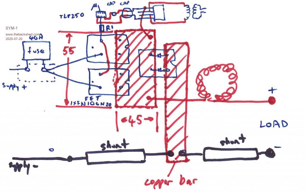

Posted: 10:32pm 18 Aug 2020
  SYM-1 said  I am having another look at my layout of my test rig as suggested.  If you will excuse the combo *circuit diagram - layout diagram* this is what I have come up with.
I am using a bit of copper bar to link the FET's with the diode and a bit of copper bar to link the diode with the shunts.
This is more a thought experiment at the moment but I am getting some copper bar.
What are the implications for stray inductance?  Any suggestions for improvement?
Having a bit more time to think about possible suggestions and in the spirit of advice to others considering your suggested approach - my advice would be don't do it !
If you have a few of those FETs & a fast diode in your parts bin well ok go ahead and use them but I would use a better gate driver (FOD3182) & preferably buffer the output.
The IXFNs are a lot stiffer to drive (4x) gate charge than the FDH's.  Mosfets have moved on since the creation of those wonderful SOT227 packaged parts of which I have used many hundreds.
In comparison, the FDH055N15A which although looks flimsy by comparison, it will give the SOT227 some serious competition. I did the following for my own purposes just to see and decided to share the information. Main specs of interest to me were....
                                         IXFN106N20  FDH055N15A    Comment
Continuous ID @ 25 Deg       106A           156A               50% more
Max pulsed ID                         424A           668A              57% more
RDS on Max                           20mOhm     5.9mOhm      338% less
Gate charge                            380nC         92nC             413% less
MAX Power                             520W          429W             121% less
Avalanche Energy withstand   30mJ           835mJ           2,780% more
Sorry for the previous poor formatting - I pressed update instead of preview.....
With regard to Max package dissipation of nearly 100W less, the FDH part passing 156A will create ~ 144W of heat, the IXFN @ 106A will create 224W of heat. For the layman, when passing 50% more current the FDH T0247 device runs at nearly half the temperature, is 4 times easier to drive and can swallow a shipload more abuse from inductive glitches.
Even if you need the extra 50V of the IXFN part there will still be a better T0247 part available.
Lastly when you consider that you can buy nearly 4 FDH's for 1 IXFN, I know where I would rather put my money.
Edited 2020-08-19 12:39 by wiseguy

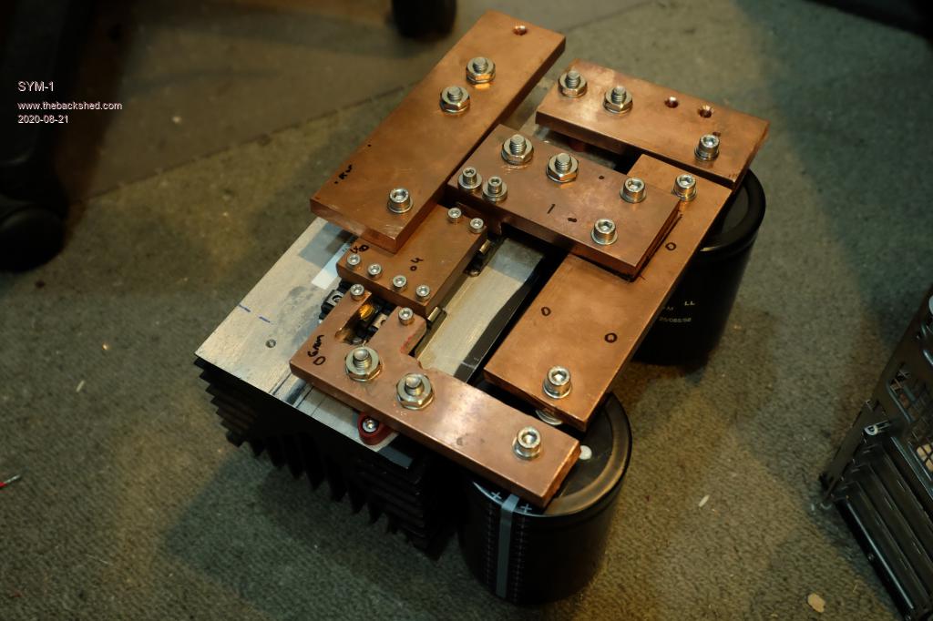

SYM-1
Joined: 18/10/2019
Posts: 47
Posted: 03:13am 21 Aug 2020
I have already pretty well built the module.  I have been a bit slow to finish it off.  However I will also build a module with the FDH055N15A.
The reason I built it in the first place is that I was having trouble with the TO220 FET I was using - even though it had great specs.
The SOT227 does have some advantages and some disadvantages.
Heat and Temperature
Pro
Firstly there is lead resistance.  The leads on the SOT227 will take 200A continuously whereas the leads on the TO247 will only take 45A.  I like things that don't get hot.
Con
While we are talking about heat - the SOT227 device does produce more of it - say 3 1/2 times more but in my case this will not lead to temperature rise because I am using a massive heat sink.  However the wasted heat does reduce the efficiency.
Stray inductance
Pro
There are two sources of stray inductance to worry about.  The stray inductance of the device and the stray inductance of the connectors.
The leads on the SOT227 device are more massive so lead inductance is much less of a problem.
Also they offer a convenient way to attach my massive copper inductors.  The copper bar is 10mm thick.  I think there will be minimal inductance in the connectors.
Con
From what you say the SOT227 device need a higher current drive.  This will lead to more stray inductance and it seems I will need a powerful gate driver.
How many devices do we need to carry - say 85Amps.  I want the be able to carry 85 Amps continuously.  This is mainly because I want it to be bullet proof.  In theory I could use one device but because of the high on resistance I want to use at least two.  I think this means they will be pretty unstressed even at 85A - that is 42.5 Amps each so I2R for the on resistance is 36W.
I like the 200V headroom too - just to make it indestructible.
Mainly though I wanted to try something a bit different and I had the components on hand.  I certainly would not expect most people to take my path.
I am a bit worried that some have had a bad experience with IXFN devices and I am not sure how that Avalanche Energy affects the vulnerability of the device but I have gone too far down this track to not try it out.
Good work on the project Mike.  Great documentation of both good points and bad.  I have learnt a great deal.
wiseguy
Joined: 21/06/2018
Posts: 1335
Posted: 05:09am 21 Aug 2020
SYM1, that is 1 serious bit of engineering - if there was a construction prize I would nominate you for it ! Tinker who we don't see much of here anymore also did wonderful mechanical assemblies & I know he would be very impressed with your implementation.
Someone said my Eltek frame was explosion proof - your creation then would be nuclear proof.  I hope it performs as well as it looks - stray resistance inductance etc would be nigh on immeasurable. How did you go tapping the copper ? - I have broken more than a few taps doing that. Last time we electrically burnt out the tap to save re-drilling and tapping 63 other holes !
Im not sure where your 45A max for the T0247 leads comes from ? The resistivity of 1cm of lead 1.17 x 0.51mm is 0.00028 Ohms and at 100A causes ~ 2.8 watts of heat. If you can insert the legs fully and solder the devices including the wider shoulders it would be much better again. The site I used for the calculator is here
I also like things to run as cool as possible, higher efficiency = less stress, less heat, less current > longer life.
Cheers Mike

SYM-1
Joined: 18/10/2019
Posts: 47
Posted: 05:50am 21 Aug 2020
None of the holes are tapped.  The SOT227's are 13mm high so a nut fits easily underneath.  I haven't tried to tap copper.  I have some trouble with aluminium at 3mm.  4mm is OK.  A bit of cutting fluid helps.  I found the copper interesting to drill.  I ended up drilling a small hole (4mm) and then increasing the size.  That was much easier.  Some of the holes are 8mm.
I can't vouch for the voracity of the 45A.  It is just something I read on the web in a comparison between SOT227 and TO247.  I am sure either will do the job OK though.
Good idea going back to first principles with the lead calculation.  I get 0.37mOhm for your lead calculation.  I am using a formula resistance = length * 22/CSA.   CSA is cross sectional area.  I found that formula on the net but haven't verified it from first principles.  The result is pretty close to your result.
