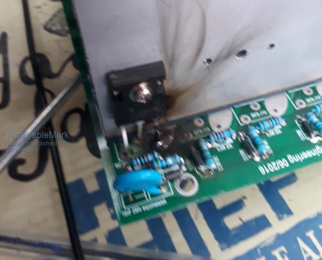

1200 watts current draw at 228 v(rms):
1200 / 228 = 5.26 A(rms)
Peak current draw: 5.26 x 1.414 = 7.44A
Using the magic ratio of 9:1, 7.44 x 9 = 67 amps peak battery draw.
If the 20Ah battery cannot supply this, the expected 48 Vdc input voltage will become low, the inverter will be starved.
Maybe the mosfet drive voltage became low and Rdson went up and overheated the mosfet silicon, causing the high speed avalanche failure. Just my opinion.Edited by tinyt 2018-04-30

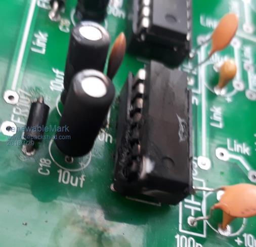

Looking at the pictures, if re-using the PCB, inspect it and make sure there are no burned-open copper traces and scrape off any carbonized fiberglass.Edited by tinyt 2018-04-30

  tinyt said   Looking at the pictures, if re-using the PCB, inspect it and make sure there are no burned-open copper traces and scrape off any carbonized fiberglass.
Yeah, thanks mate, already done, carbon conducts too!

Hmmm control board was a lot more rooted than I first thought.
Popped 2 sets of 2110's attempting to get it going.
Zener diodes tip35's various caps were rooted.
I'm pretty sure it will be ok when new chips arrive.
Been tempted to buy a scope like this but will only use it once or twice.
If you ever have a big fry up I suggest to just do a complete rebuild of the board.
I'm still not 100% sure it's right. Most parts replaced, seems to test voltages through ok.
Right two pins of fets measure 7-8mohm with ribbon cable not connected, but 3.5m ohm when it is connected, that is with 2110 and 8010 board removed.
I'm feeling that's not right, I'm suspecting I'll have to replace everything I haven't since the big fry. Feels like banging my head against a wall considering new boards are coming.
Desoldering and burning components messes up a board, thes ones are looking pretty worse for wear now.Edited by renewableMark 2018-05-02
