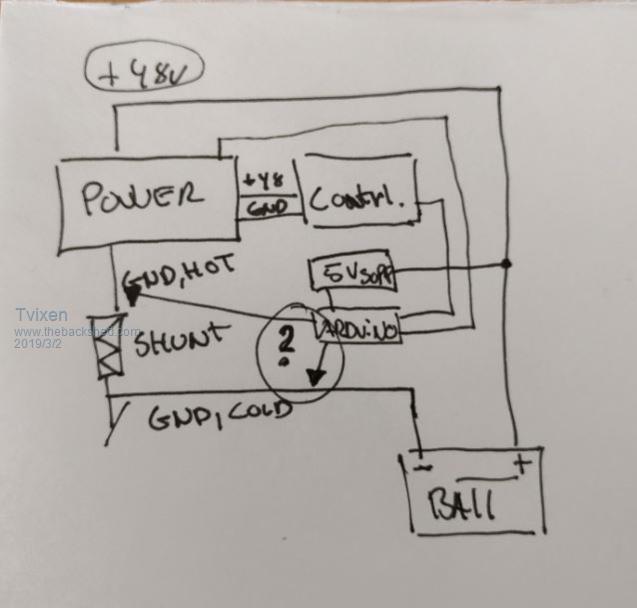

As i read your PCB details for the control board, you use a shunt to measure the DC current. Right ?
If you use a shunt resistor(on the low side), do you have the common ground
on the hot or cold side of the shunt?
I'm asking because if i connect the Nano to hot grount, there'a a lot of noise on the ground line when I turn on the inverter. But the question is, what's the right way to do it?
See attached.
Br Tim
Posted: 09:51pm 01 Mar 2019
The ground cold as you call it is connected to the Battery only, everything else is connected to ground hot including earth.
The shunt is very low resistance so should not matter regarding the noise anyway, check all your connections are making good contact and earth it as well.

Ok.... So my lineup is correct. Must be the ads1115 sniffing some of the 25khz from the powerboard then. I will try "yet" another filter on the differential input then.... Thanks for your input and the fast reply

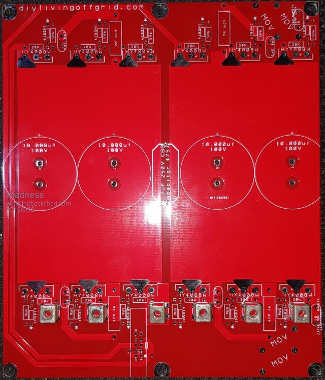

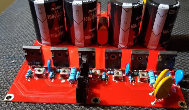

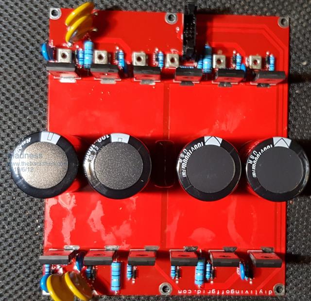

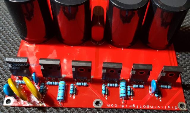

After Poidas recommendation my stock of 8KW power boards is getting low, I will need to order some more. Still have plenty of other PCB's.
The 4KW version of the power board is simpler and easier to build also the transformer required is half the size. The 4KW is no toy and will run a modest off-grid home easily.
The screw terminals are for the Negative power input, you can still solder it directly to the bottom of the PCB but this version allows running 6 smaller wires to the PCB and screwing them on. This makes it easier to mount and requires minimal clearance under the PCB. CThe control board connection is the same as for the 8KW PCB so will work with Poidas or my control board.

Any difference in idle current between the two power boards with the same transformer?
I am looking at fully populating my 8kW board then running it on a single toroid. (I have four toroids here, but I'm too lazy to unwind the secondary and stack them)
Posted: 12:47am 12 Jun 2019
There would be very slightly less with the 4KW as it does not have (or require) the TOTEM pole drivers that are on the 8KW.
You could run 2 single Toroids in parallel, but if you want low idle current then better to do it properly and completely unwind and double up the cores.
