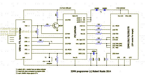

am in need of a second opinion or two, regarding using ICSP just to erase the flash in an MX150.
one of the final hurdles to getting pic32prog usable through the bitbang interface is that released versions of the mmbasic .HEX file have the JTAG ENABLE bit cleared. this poses a slight problem - ic32prog's bitbang unit was originally written with JTAG in mind, but we have no JTAG access.
the solution i've been working on is to simply place code in the JTAG head unit (currently a micromite) to perform an ICSP flash erase. in theory, quite a simple process which doesn't even really need the micromite to read anything back from the target.
following the microchip datasheets didn't work, so i generating a trace from pic32prog, see below:

the letters d, e, f, g in the above trace encode TDI and TMS, with TMS = bit 0, and TDI = bit 1. the sequences match up to the constant labels in the source.
i've recreated what should be the essential sequences in the following micromite code (partial listing), but it still fails to achieve the desired outcome:

in particular, can anyone see any faults in the way i am getting into ICSP mode?
any suggestions would be most welcome...
rob :-)Edited by robert.rozee 2014-10-29

I don't really understand how it's supposed to work, but the line
Pin(25) = D / 2 ' TDI
jumped off the page as being out of place in bit-banging, perhaps the line should read
Pin(25) = D \ 2 ' TDI
As I said, I don't really understand what's going on in your code so I've probably guessed completely incorrectly.

Posted: 07:51am 28 Oct 2014
you are indeed right, it should be "Pin(25) = D \ 2", although in the context it would have worked the same.
looking at your code, the error in mine stood out like a sore thumb - i had no equivalent of "SetMode(&H1F, 6)" at the start. within the pic32prog trace this was combined with reading the device ID and i'd completely overlooked it.
after adding in the necessary line of code, the JTAG head unit can now erase a JTAG disabled MX150 by simply typing at the windows console prompt "echo * > com3:".
many thanks Peter, for your help!
rob :-)
fyi, here is the complete (now working) code now running on the micromite. it operates with a very simple single-character set of commands (defg DEFG 23458 .>?*) and would easily translate onto a small PIC or similar. the only real requirement is for at least 48 bytes of input buffer and sufficient pins (8 I/O + a fast comm port).

You must be implementing 4 wire JTAG I assume from your code above. Are you going to implement 2 wire ICSP ?
Peter
The only Konstant is Change
Posted: 03:14am 29 Oct 2014
Peter:
yes, it is the 4-wire JTAG interface that i am working with currently - simply because this is what the 'adapter-bitbang.c' template that Serge prepared for me uses. he created this template by stripping out the USB code from 'adapter-mpsse.c', itself designed to talk to Bus Blaster v2, TinCanTools Flyswatter, and various Olimex programmers based around FTDI's FT2232.
the main problem with JTAG is that: (a) it can not erase a pic32 with <bit 2> of DEVCFG0 cleared, as this bit (in hardware) disables the JTAG port when set to 0, and, (b) when using the JTAG interface it seems to be at least difficult (if not impossible) to clear <bit 2> while programming DEVCFG0.
i've now overcome (a) with your help, while chatting to Geoff indicates that as long as he doesn't change one small part of his code (b) will not be an issue in future - all past micromite .HEX files have <bit 2> cleared as well as the JTAG interface disabled in code shortly after MMbasic starts up. so having <bit 2> cleared is currently superfluous and hopefully can remain so in future (subject to a few simple tests that need running).
2-wire ICSP is on the roadmap. once i have fully functional and stable code, then the next steps will be:
1. replace the micromite with an Arduino Pro Mini - which will yield significant speed gains and (mostly) solve the chicken/egg problem. to this end i've been reworking my initial handshaking mechanism between pic32prog and the JTAG programming head to allow good throughput with a very small (64 bytes) RxD buffer at the head. the way buffering and handshaking is done is the key to speed.
at that point i want to look seriously at getting the code back into the main trunk of pic32prog so that the 'official release' can be used to create a micromite with just a few dollars worth of extra hardware. this largely will satisfy my initial goals when i started this thread.
2. add the ability to compile and run under linux and unix. currently serial port I/O is all done through windows-specific API calls. i'm rather hoping a linux expert will step forward and volunteer to fix this, as a cursory glance reveals a right can of worms.
2. realign 'adapter-bitbang.c' algorithms to make it compatible with 2-wire ICSP programming. this requires several subtle changes in the algorithms used, which i have been loathe to tackle while there are other outstanding issues. it will also require a couple of tweaks in the main body of the pic32prog source, which is strictly in Serge's domain.
3. look at going to a "minimal hardware" programming head, perhaps the LM555 based design i've suggested before, perhaps something even simpler. i've been thinking around an idea using a capacitor and resistor to generate a ramp from xD, which PGD and PGC can in turn be recreated from with just a couple of transistors. i've also been thinking around ideas of programming a pic32 with no TDO feedback from the target.
so, much work to do. as long as people are interested, that is.
