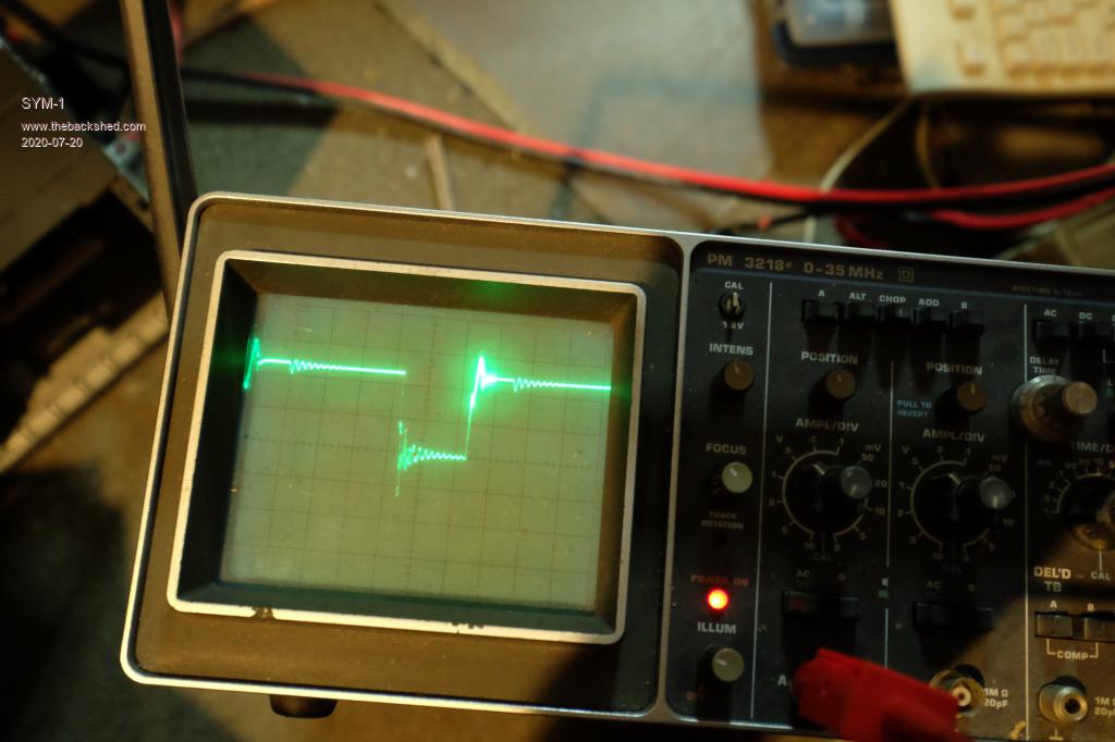

I am a bit worried about the -ve going oscillations in this picture.  How about RC networks across the diodes?  Any idea of the values?

That appears to be ringing - a decaying oscillation which is quite normal. The voltages and currents we are working with usually means there is a not insignificant amount of energy in the ringing.  Ringing is not really harmful usually except the first peak when added to the supply voltage can avalanche the FET causing heat if it exceeds the Max FET Drain voltage.  The ringing can also be exacerbated by not having enough capacitance or and close enough to the input and output nodes.
I am guessing the narrow neg peak is during the turn on time of the flywheel diode, a snubber should help to tame it .
Typical values to try to snub out the ringing would be capacitors from 470pF to 10nF and resistors from 4R7 to 47R. When snubbed close to optimum, there will be a single peak rise followed by one smaller undershoot that then settles to a constant level.
If the resistor gets hot or burns your fingers either the cap is too large or the resistor value should be reduced - looking at the CRO trace whilst carefully placing the temporary snubber values across the diode is a good way.  Start with 10R and a 470p capacitor and then vary the values to another increment whilst observing the CRO trace is heading in the right direction. Dont try for a perfect square-wave you will waste way too much energy achieving it.
It is also important to follow good probing techniques - Poida described these a few times in some of his posts sometimes the ringing you are looking at is fake (not the Donald Trump type...) and caused by improper probing technique.

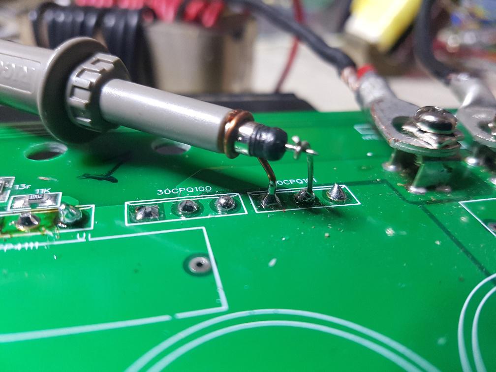

As far as probing the response of the circuit, I would always
want to set up a probe with ground being DC ground and the signal
on the inductor/MOSFET SOURCE/DIODE node.
And not use long leads.
Long leads when looking at sharp square wave signals at about 20kHz
can be 4 inches. This is too long.
Here is how I probe a powerboard at the above described node.
just solder the two wires on pins of the diode. You will find it easy to
determine which pins are what.
This probe technique gives a high quality signal to the CRO.
What you see with this probe tech. is what is on the pin.
(for frequencies up to 100MHz and that is all we need to care about anyway)

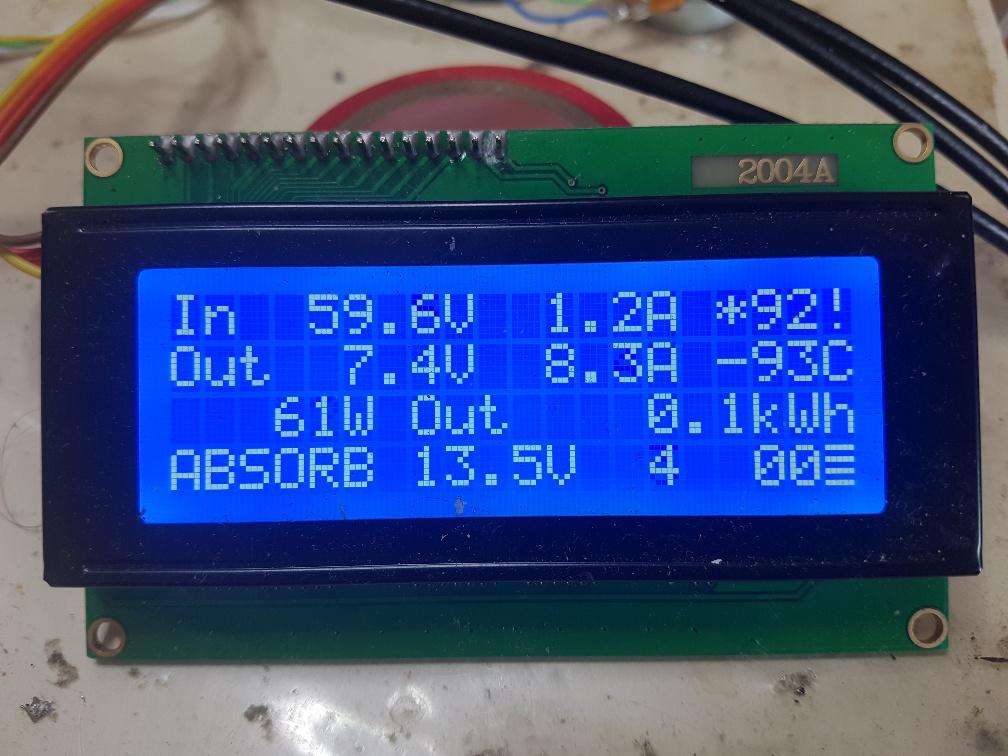

I added the current throttling due to heat sink temperature function to the firmware.
You need to set it some value that means something to you.
For me I have the heat sink maximum temp set to 75C and the new value
"HS throttle low" set to 55C on the working prototype connected to the East facing array.
This will have the controller reduce the maximum output current
gradually, from 45A - the maximum current - at 55C to 0 Amps at 75C
If the heat sink goes past 75C, the controller will switch off and show
"overcurrent" on the LCD.
When current is reduced due to throttling, an "!" will be shown on the LCD in the top right corner, where the heatsink temp is displayed.
If throttling is not in effect, then there will be a 'C' instead.
The "*" next to the temperature means the fan is switched on.

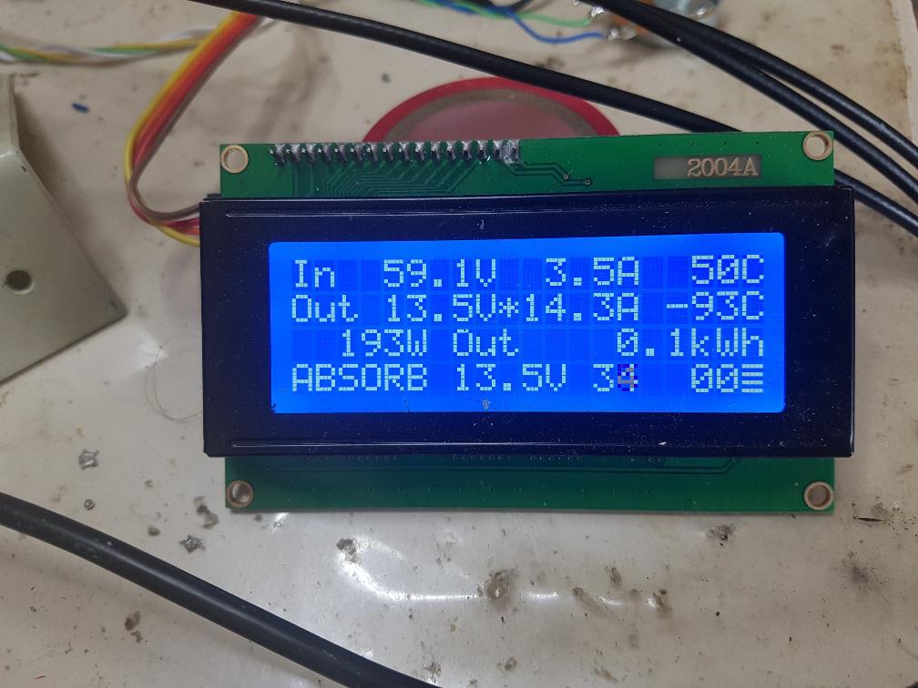

here it is under test conditions with no throttling:
and when throttling is happening. I use different values during the testing
(and photos). No NTC is connected to the toroid NCT input so it shows a nonsense value of -93C.
I had heatsink max = 100C and HS throttle low = 80C and a maximum output current of 20 Amps. This means a simple relation of throttled output current.
up to 80C = 20A
85C = 15A
90C = 10A
95C = 5A
100C = 0A
In the photo above we see HS temp is 92C so the output current limit is now set to
8 Amps. This is what is in effect.
I think this will make the controller behave in a way it will not need a fan even if the heatsink is undersized. It will not overheat the MOSFETS.
The LCD display is very useful to see what is going on.
I probably need to write a book on how to build a controller and run it.
Latest code with heatsink temp throttling:
EDIT: minor change, put the 2 files into one directory
mpptv5.zip

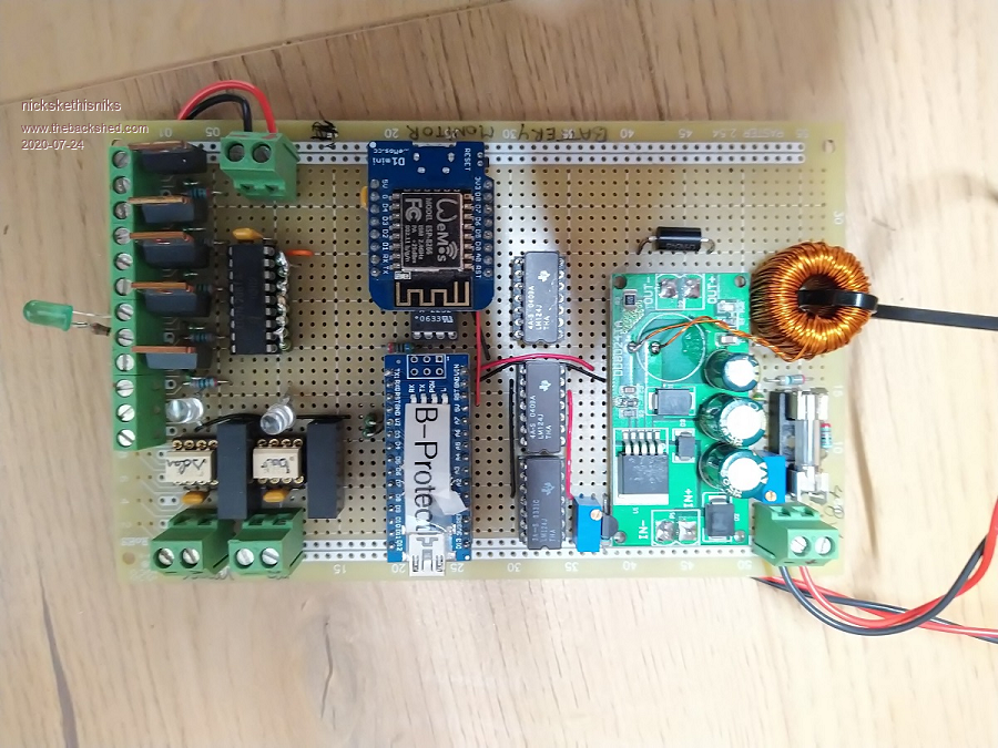

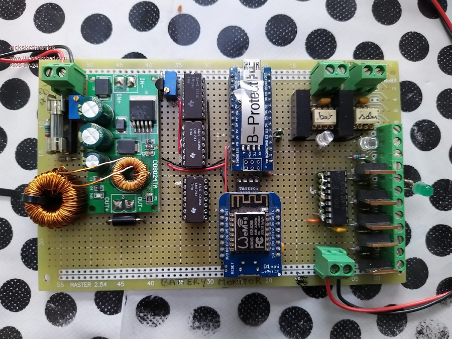

Hi Poida, I noticed you are using the same dcdc as I used in the past, I’m using 2 in my ozzinverter, 1 for 5V the other for 15V.
Last weeks I noticed a hot buck inductor in one of my other prototypes, my “battery monitor” that I use for disconnecting my solar panels as last protection when my solar controller would go short circuit. This  “module” also has 4 other mosfets for switching relays/ contactors, like the 3kw hot water element and the main contactor after my inverter. The board used to send data over wifi to thingspeak so I could monitor the battery over the internet. There are also some other ic’s but that was not my point to make.
What I wanted to say was that the inductor was running hotter week after week, I decided to change the inductor with a self wound T90-26 core. Probably a little bit over kill, but hey why not spent one hour to make some +200turns for a “protection” system.   I also added a suppressor after the dcdc, if it goes bang it will safe the rest by blowing the glass fuse.
I may call it, thermal runaway, if you read the micrometals datasheet, those cores can degrade really fast under the right circumstances (a lot of heat). The original had 100µH, it now has 2mH and it runs fine without heating up. I think there is only 50mA power draw on 12V.
My other boards are fine, I just wanted to let you know.
For disconect I use a Schaltbau contactor, they sometimes come on ebay:
(don't know wich type from memory)
Contactor
Edited 2020-07-24 03:56 by nickskethisniks

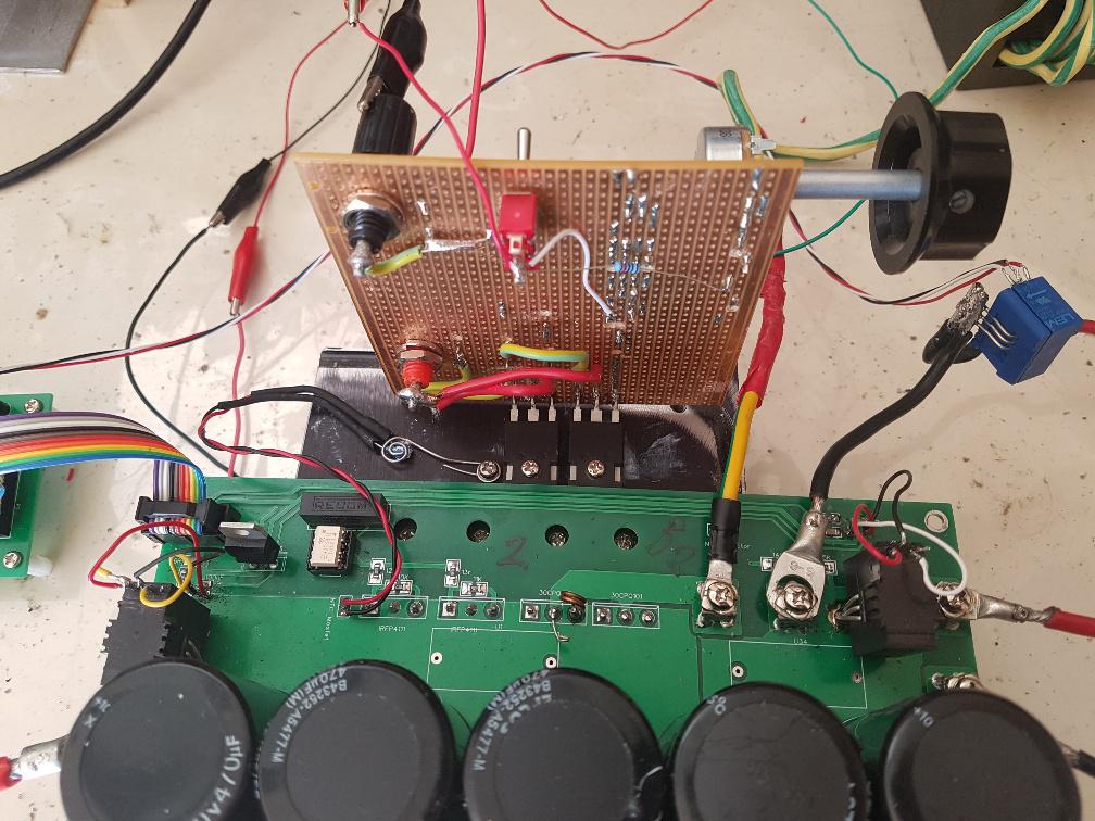

So, with the spare board that has no caps I put the 2 remaining 470uF 450V on the input
and one 100V, 10,000uF on the output.
I then give it the berries.
Let's see what breaks.
I drive it with 87.6V input, 2000W output into the bucket of Ohms
which is right now 47.7V and 41.2 Amps.
what gets hot and what does not?
The two 4&0uF caps get quite warm. Not too hot to grip with the hand.
The inductor gets warm too but not beyond the PCV insulation limits.
The 10,000uF cap stays cold.
The 2 oz PCB track joining the MOSFETs to the inductor gets nice and warm.
The heatsink gets nice and warm.
Next test is to see how the mppt firmware performs.
This is interesting since we have 10,000uF on the output, instead of
5 x 470uF (2,350uF)
Will the mppt scan function work at all?

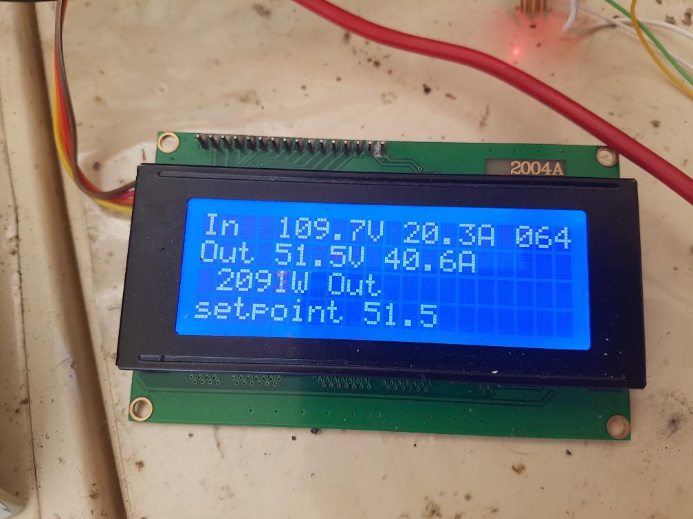

I thought I better see how the mppt will go with a hot heatsink.
After designing a dc-dc converter, I was wondering if it
would run OK when hot. But it would take ages to heat up enough when under load.
So I had to preheat the heatsink with the 2 x IGBT variable DC load module
to about 65C and put the converter to work.
Test conditions:
110V in
51V out
2000W out
65C heat sink temperature
The mppt board uses 2 x FDH055N15A MOSFETS and 2 x HY5110 as diodes.
No problems, stable running from 15C water up to the point where the bucket of resistance starts to boil.
check out the video
that's insane
This gives us some guidance when setting a heatsink upper temperature limit.
2kW is OK at 65C, probably good even to 2.5kW or 50V @ 45A
Edit: I just took it to 75C, no problems.
