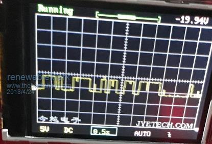

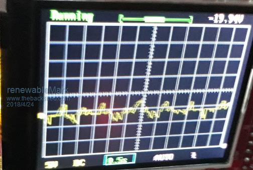

OK decided to go and have a look at it.
New driver chips (rs 2110)
Voltage still jumping all over the place.
I connected ground and put the probe on each heatsink
This is left heatsink
This below is right heatsink
And this is the output from torroid, ground lead on one output side, probe on other side
As you can see it's pretty messed up. Something is wrong, I just don't know what.
Cheers Caveman Mark
Off grid eastern Melb
Posted: 07:56am 24 Apr 2018
Your right it is something.
Look at the gate signals to the MOSFETS and work back from there to see if you get a good signal. Both sides will make square wave when first turned on.Edited by Madness 2018-04-25

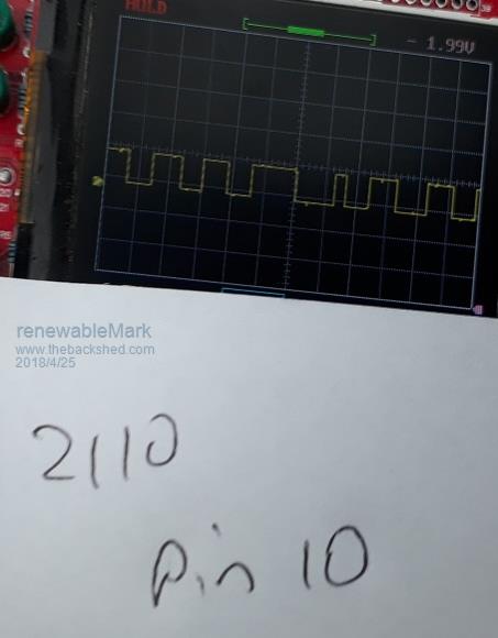

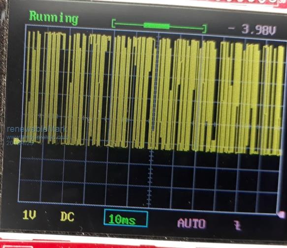

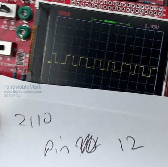

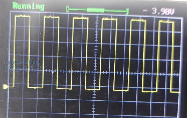

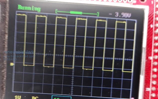

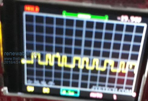

Finally worked out how to use this scope properly.
Pins 10 and 12 on top 2110 socket are fine.
Pins 10 and 12 on lower socket are all messed up
This is without 2110 chips fitted.Edited by renewableMark 2018-04-26

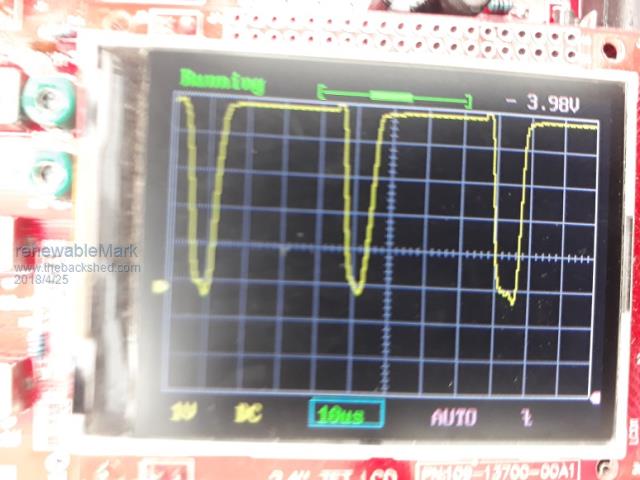

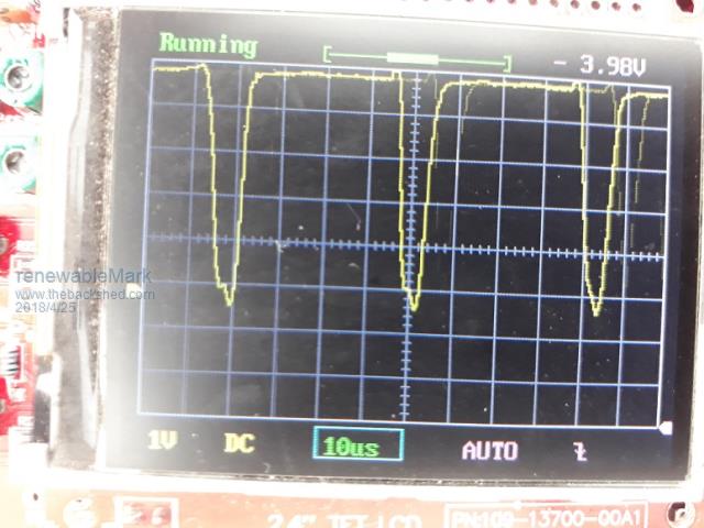

oztules
Joined: 26/07/2007
Posts: 1686
Posted: 11:50pm 24 Apr 2018
Ok, pins 10 and 12 on the top one is the 50hz, and should both look the same, and be uniform square wave 50hz.
The bottom chip has the spwm on it, and your scope quality will determine what you can see clearly..... mine is pretty spotty.
However, it will look like two straight lines with fizz in the line. No vertical component if your still on the setting you use for 50hz.
As you up the frequency of the trace, it may resolve into variable width square waves, but mine does not go that well. On my second scope, I can get some resolution, but not clear.
What you can deduce is that the spwm is there, and there are no spurious waveforms... but for my equiptment, it is hard to define properly. I am guessing that what you are seeing on the bottom chip, may be fairly good. post pics if you can.
If so we move onto the next stage..... whats coming out of the 2110.
The top chip will have the same 50hz square wave, but higher voltage on both the outputs.... remember the high side will be not as defined as the low side in the top chip.
This is due to the voltage pump to create the voltage above the 48v supply... ie when the top fet conducts, it will pull the source up to the drain voltage... so suddenly you need 10-12v more than the supply to keep the gate 10 or more volts above the source... thats the diode and 10uf cap... so on long duration waves, the voltage will sag after the initial cycle turn on, so you will see a slope on the high side outputs on the 50hz chip ( top one).
Because of the speed of the 20khz on the lower 2110, there will be no discernible slope on these waves if you can see them ( mine can't).
On my scope, it is more like just two lines with "stuff" impressed on the line. There are no vertical components on my scope, so the waves are very well formed, and get from zero to max instantly as far as my old scope thinks.
So... pic of the high side signal into the lower 2110, and the output of both top and bottom 2110.
To recap, the top 2110 is all 50hz, the bottom 2110 is all 20khz ( 23?). The pin 1 is for the low side fets, and the 5&7 pins are for gate source drive of the high side fets.
So test and more pics of those 4 waveforms on the input of 2110, and the outputs of the 2110.
..........oztules

OK I'll post the pics of sockets first
Top socket pin 10
Pin 12 top socket
Pin 10 bottom socket, same setting
Pin 10 bottom socket, changed setting to 10us
Pin 12 bottom socket 10us
