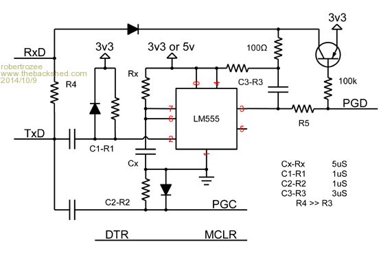

it is probably more instructive to go the route of downloading MinGW and DownloadSVN so as to build pic32prog oneself. i must admit to being surprised at how straightforward the whole process was.
once folks are in a position to build pic32prog themselves, it will be possible for those in the community to get down to the serious task of reworking adapter-mpsse.c so that it can talk to the target through calls to a single function:
TDO = ICSPtransaction (TDI, TMS, TDOflag);
(where TDI and TMS are passed in, and TDOflag indicates if it is necessary to return the value of TDO)
once we figure out how to do this, then a number of different hardware interface models become possible, including John's FT232R, my LM555, and your MMbasic version. i've been studying the layers of adapter-mpsse.c and slowly but surely the mud is starting to become clearer. although, my C training was nearly 30 years ago on mainframes, and the input of others would certainly speed things along.
perhaps even Geoff might be able to lend a hand?
rob :-)

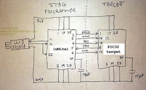

this is set up to talk to the JTAG interface of the target pic32, and requires a micromite attached between serial port and target running the following short basic program to decode single-letter instructions from pic32prog, and to respond with the state of TDO where required:
SetPin 2, DOUT ' MCLR, connect to pin 1 on target
SetPin 3, DOUT ' TDI, connect to pin 16 on target
SetPin 4, DOUT ' TMS, connect to pin 14 and 22 on target
SetPin 5, DIN ' TDO, connect to pin 18 on target
SetPin 6, DOUT ' CLK, connect to pin 17 on target
SetPin 7, DOUT ' status LED (via 1k resistor to ground)

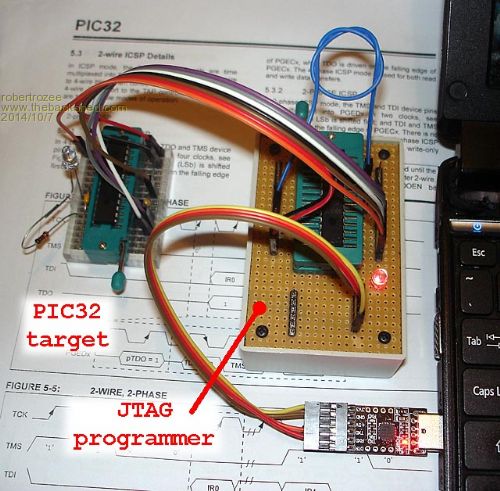

the reason i've proceeded in this way is simply to get something working - initially i didn't realise that pic32prog didn't talk via a 2-wire PGC/PGD interface. this code here is very much a test to see what happens. it is quite possible that along the way i have got TDO and TMS swapped over, MCLR inverted, or other small errors. but it is a start. once i've got this part working, then the plan is to move back to a 2-wire interface using PDC/PGD and no MicroMite in between.
i would much appreciate any feedback. if requested i can post a compiled copy of pic32prog.exe but would much prefer if people could set themselves up to compile it themselves - allowing you to make alterations to the open source code.
pic32prog expects a parameter -dCOMn, where n is the number of the comm port. the code will only compile under windows right now. someone needs to suggest a widely used serial port library that allows reading and setting the comm port's status pins that is cross-platform.
rob :-)
schematic for the programmer hardware. not much more that a couple of pic32's:
the time taken to program micromite basic into an mx150 is approximately 15 minutes, with the PE loaded in the first 20 seconds. note the RxD/TxD LEDs on your usb to serial bridge while programming the actual code - very little time is spent actually transferring data. usinga an arduino pro mini (around $3 on ebay) instead of a micromite would speed up the process considerably.
note that a status error is printed at the beginning of programming, and there is a checksum failure at the end. these can both be ignored for the moment. the verify of the last 4-bytes programmed fails because 'code protection' is not being correctly turned off - as indicated by the status error report at the start. this is a problem in the routine serial_execution() that remains to be fixed.
fyi, this is what my own setup looks like:
i would very much appreciate feedback before proceeding any further. plans are, if there is interest, to look at moving from using 4-wire JTAG to 2-wire ICSP, as well as using a non-programmed interface to the target.

over the last few days i've been trying to rework my LM555 pic32 programmer circuit to allow reading back PGD via the serial port's RxD line. i believe i now have a solution that should work:
essentially, TxD is now looped back to RxD on the usb-to-serial bridge indirectly, via a resistor. this allows for the characters being echoed back to be modified on the fly. we take the falling edge of the monostable output, and turn it into s shortish negative going pulse (3uS). this, via a diode, inserts one or two zero bits in the middle of the bitstream. but, if PGD is being driven low by the target (after the 3rd clock pulse) then the PNP transistor will already be turned on, which suppresses this negative pulse.
so the programming procedure consists of sending TDI, TMS, chr$(255), 4th pulse. TDO will be encoded into the 3rd character returned in the sequence. if it is read back as chr$(255) then TDO = 0 (transistor turned on). if it is a lesser value then TDO = 1 (transistor turned off).
experiments with pic32prog and a micromite as JTAG programmer have shown that good throughput can be achieved via a serial port provided one works with (not against) the buffering within the operating system. the OS is happy to buffer up data coming back, so one can stream out data to be written to flash at high speed, then at leisure read out the response.
i believe programming in just a few minutes may be possible using a generic serial port bridge. feedback, please?
rob :-)Edited by robert.rozee 2014-10-10

I'm short of time so only reading.
The LM555 looks too complex and too many components for me.
If I get a chance I plan to see what I can get into the rather small plugin umite space and if it's enough then move my code there and in that case I suppose under 2 mins to program pretty much anything.

I still read this post when I get the time, and I do have to agree with JohnS that the 555 circuit is a bit too complicated.Edited by G8JCF 2014-10-10

And yes, I agree it has to be simple, no 555 timer.
