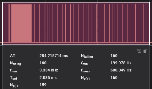

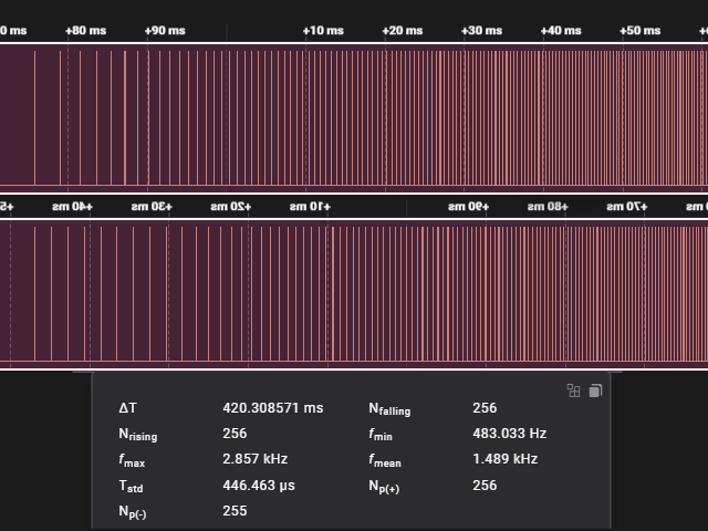

My tests of the above firmware are good. I'm seeing the correct number of step pulses for every value I've tried from A0.0625 (1 pulse) and up. If I request a move of A100, I actual get it, both in the number of pulses, and the reported A position afterwards. And it works fine even up to a 50kHz pulse rate. (An actual motor has other ideas, what with resonance and all, but that is a different story.) The rogue pulses at sub-system start-up also seem to be gone.
The pulse pattern looks like a brute force fix at the end of the pulse train, with a few pulses at 5ms intervals added to get the correct number.  ;-)
With an S-Curve accel profile, this is very noticeable. 44 of 'em in this capture. (Accel = 50000 in this example.)
