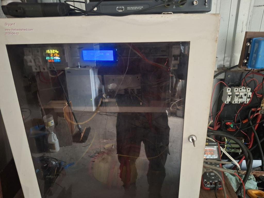

Ok ran the test again and saw 3.4Kw load then it dropped to 3Kw so thought best to know what the DC current is at 3Kw

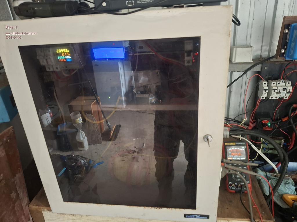

Now I do have an electric 1800 watt oven here so decided to put all 3 elements on

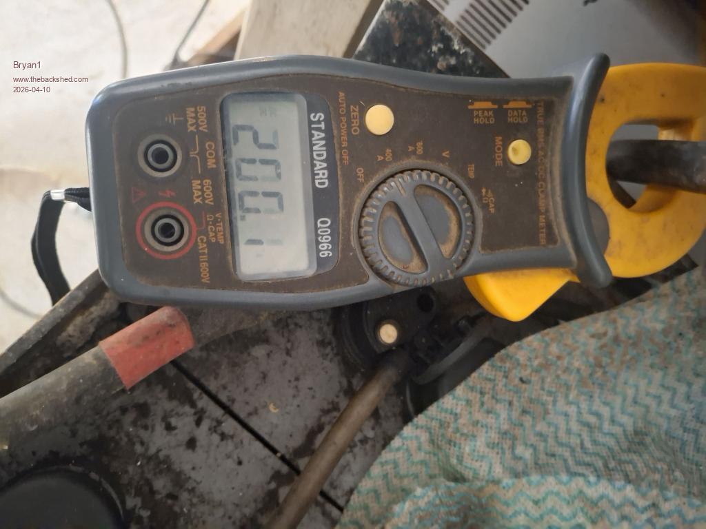

The DC current draw

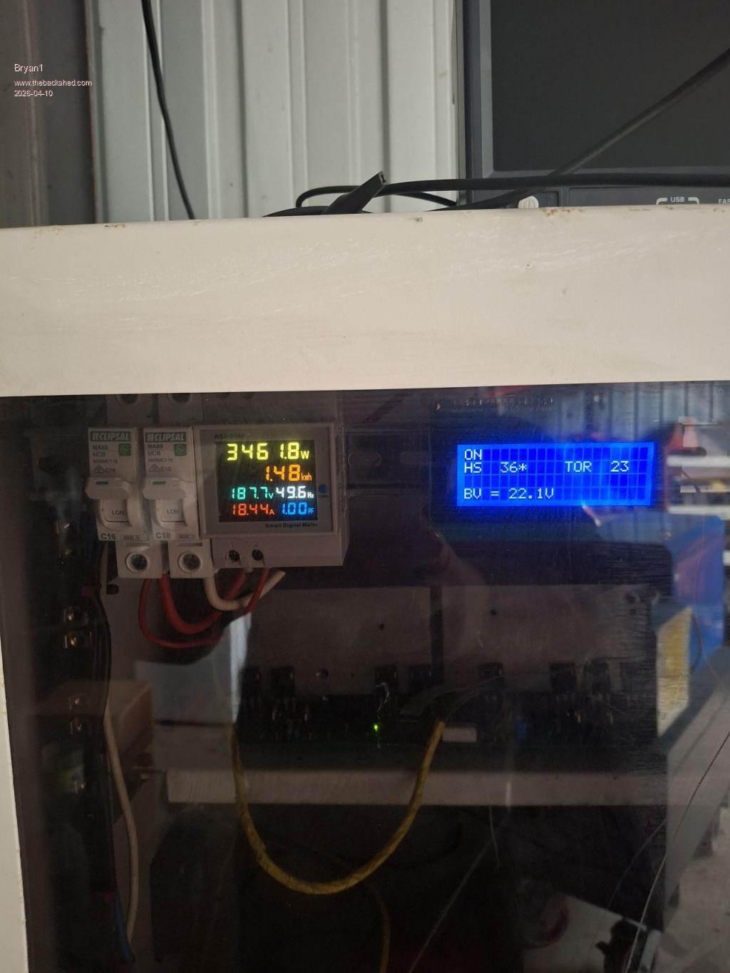

Posted: 03:20am 10 Apr 2026
Observations:
BV = 22.1 volts (from picoverter)
DC current = 200.1 Amperes (clamp meter)
Inverter Input Power draw = 22.1 x 200.1 = 4422.2 VA or Watts
AC load = 3461.8 Watts (from Multi-Function meter, pF = 1)
Difference = 4422.2 - 3461.8 = 960 Watts.
Edited 2026-04-10 13:21 by tinyt

4.4Kw so far is a good sign I think too and seeing 18.5 amps on the AC side does make me want to see 20 amps
Also while doing these test I see the AC voltage drop under the load now the 49.6Hz shown on the multi function used didn't budge under load so I do think that is a good sign this inverter is working correctly.

The Nano frequency will not shift with load or regulation, the AC on that Mains monitor should not drop more than a volt or two, depending on the quality of the PF factor calculations for a given load with AC monitor quality.
The picture showed 187v on the AC meter @ 3.4kW, that is a nothing load, AC should not drop unless, wiring, toroid or VFB regulation are not working correctly.
Or - due to toroid design or very low DC input, causing close to 99% PWM drive at low power, leaving no headroom for higher load current regulation.
Or the photo is wrong?

Nicely spotted KeepIS. I didn't look at the energy meter and see how low the voltage had dropped that low.
That is definitely something that needs addressing.

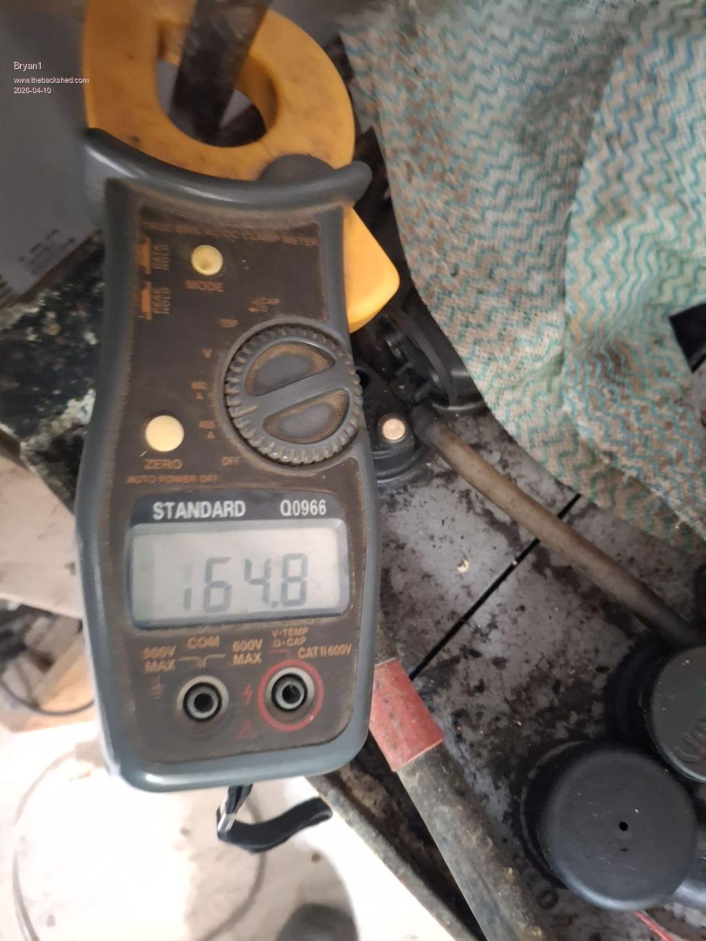

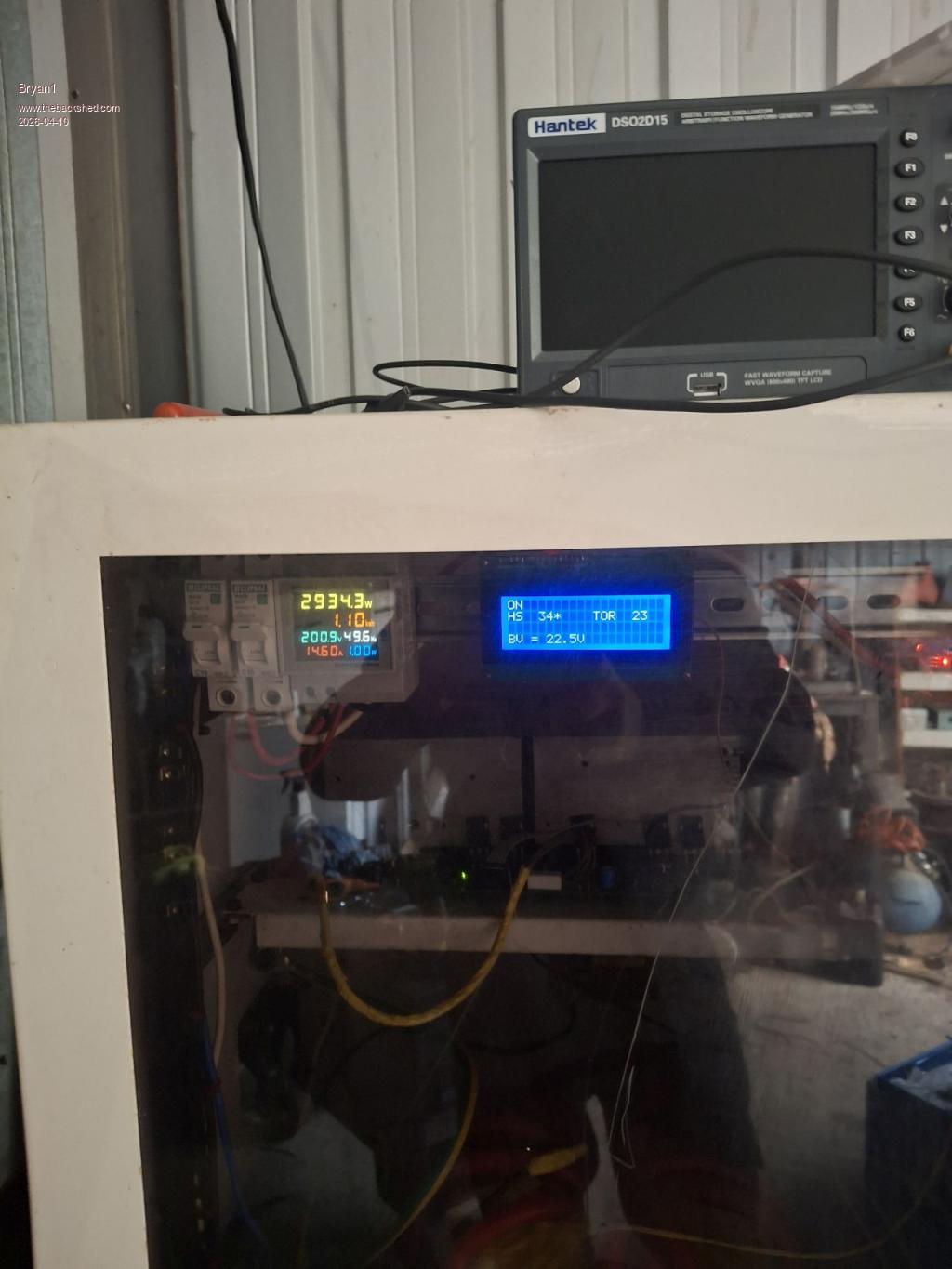

Ok just had to try another test
With the single element
Now with the single element and the toaster oven
So at 1.5Kw no voltage drop but at 2.8Kw the voltage drops so yes a new problem to try and solve.

Those energy meters are quite accurate, I've used many of these over the years and currently have 3 in the Inverter switchboard panel, all are within 500mV of each other. Try testing with purely resistive loads when comparing them against a True RMS DVM.
EDIT: I wrote this while you were posting your photos above, so you have now confirmed
the accuracy of the Meter and the problem you have.
