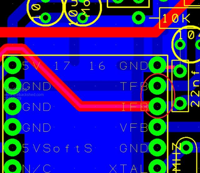

Posted: 06:31am 16 Aug 2018
Just did a small update for the voltage sensing of the Control board PCB.
With this version, you must change the 9K1 resistor located at the top end of the Nano with a 5K1 or a 4K7 either is fine. This better range sensing into the higher end of the voltage range.

OK my machine is shutting down fine from under voltage.
The red led for over current lights up and stays on.
When it shuts down the led next to the 8010 blinks twice for over current.
When the voltage rises enough to bring it back in the good range the red led goes out, the 8010 still blinks twice, but it doesn't restart.
On an unrelated issue the battery adjustment voltage seems to be hard to adjust very finely. the volts read 48.00 tiny bit more and it goes to 48.67, then 49.00, then 49.33.
If I replace that 10kpot with a 10 turn, will the voltage be able to be set more precisely?
It's not a big deal, just wondering if it's an easy fix, then I'll do it.
Cheers Caveman Mark
Off grid eastern Melb
Posted: 11:23pm 18 Aug 2018
Overcurrent does not reset by itself and never has and never will. Also it is not related to voltage, if you catch it right away you can reset it by shorting out the middle pin of the SCR to ground otherwise you have to reset the EG8010 by completely powering it down, there is no other option. There is much more detail in JohnMc's thread.
Voltage adjustment is not perfect and part of that is why the Regulator has the Analogue to digital converter in it. What you are seeing is the steps that Arduino can recognise, you can get it within 0.17 of a volt which is enough resolution for the application.
renewableMark
Joined: 09/12/2017
Posts: 1679
Posted: 11:51pm 18 Aug 2018
When it shuts down from undervoltage it appears to be telling my 8010 that it's overcurrent.
Tried it a few times with zero load on the inverter so it can't be an actual overcurrent.
When the arduino sees low volts it shuts down the control board, red light goes on and stays on and green light flashes twice for over current.
Cheers Caveman Mark
Posted: 12:37am 19 Aug 2018
Put your meter on the current and temperature feedback pins on the EG8010 connector to see if they are not connected by a solder bridge or something. It should not be triggering overcurrent.
Edited by Madness 2018-08-20

That will be it, got a beep there between the two.
Cheers Caveman Mark
renewableMark
Joined: 09/12/2017
Posts: 1679
Posted: 06:51am 22 Aug 2018
Yep, that was it, works like a charm now, shuts down and restarts perfectly.
