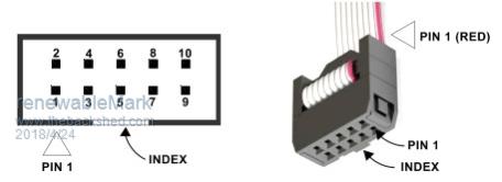

The index point on the plug is in the center.
When you make the plug, lay out the plug /s on the bench, so that the location/index protrusion is in the same orientation for both.... not facing each other. If it is on the left for plug one, then it must be on the left for plug 2 as well. Lay the cable on them.... note orientation and clamp them.
There are different gauge ribbons, make sure they are partnered to the correct plug... else crowding can occur, and shorts occur.
The real test is plugging them into their respective sockets, and measuring the resistance from pin one to pin one two to two etc.
This will prove that all paths are coherent, and going to the correct number pin.

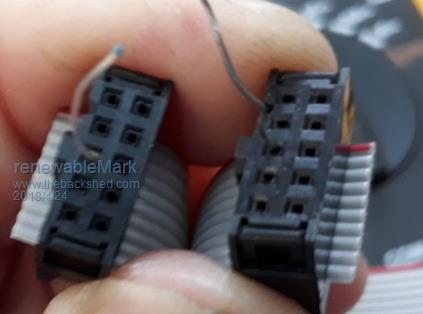

No closer, That cable is correct, resistance shows it's right.
soldered up another 8010 chip, cro tested that all looks good.
something between the control board and power board must have got damaged when I used the faulty ribbon cable, but I just can't find it.
Considering Mad's boards are probably not far off, I'm going to put it in the CBF basket for now.

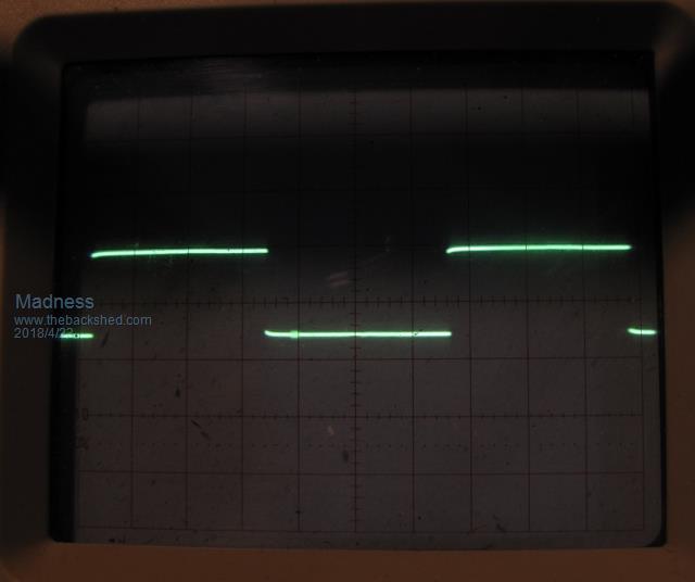

Mark I have been at the point of throwing the whole lot in the bin a few times. After a few hours I went back to it, I was not going to be beaten by a few MOSFETS especially when Oztules and others could get it working. I even seriously considered asking Oztules if I could get on a plane and visit him with the f'n thing.

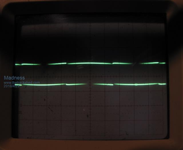

I would look at the gates of your MOSFETs with the CRO and see what you are getting there, you should see the same as you did coming out of the EG8010 and the IR2110's.
Try it with the Toroid disconnected as well and see what you get on each of the smaller heatsinks. This is what you should see.

I pulled it all apart today to test each bit by themselves and really go over the power board.
I'll have another crack since you went to the effort of taking and posting pics.
If that fails all the bits will still get used in the Madinverter
It's frustrating as I took it back to the setup it was in on p37 and it's just not working for some reason, something has failed since but just can't find it.Edited by renewableMark 2018-04-24

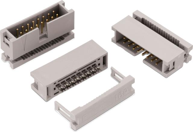

Ribbon cables are an instrument of the Devil.
If you must use a ribbon cable approach it with much fear and caution and expect to have trouble. Every time you plug and unplug one you are stressing what is probably a horrible crappy joint between the ribbon and the connector.
Insulation displacement joints are supposed to force a SOLID conductor between two tapered jaws where the wire is then supposed to be immovably and permanently wedged solid. Rather like a sliding type of crimp joint. Extreme constant applied pressure produces a quite good metal to metal electrical connection.
Only a complete idiot would try to use this conductor wedging technique with a readily crushable multistranded wire. Think about it.
If ribbon cables used single solid conductors they would not be as flexible, but at least the insulation displacement joints might stand a faint chance of working properly.
If you can get the proper professional tooling to do it, its probably just barely acceptable if the whole mess is installed inside a piece of equipment and then never disturbed.
Unfortunately for our typical home brew application, its never going to be left in peace but plugged, unplugged, and mercilessly stretched and flexed time after time.
If you are really stuck, use pin headers and header plugs, and solder each individual wire, then cover each soldered joint with small bore heat shrink to limit flexing right at the soldered joint.
Solder the male pins to the board, they never give trouble, its the females that can sometimes cause problems after many long years in a very dirty environment, so fit the females to the cable end if possible where they are more easily replaced.

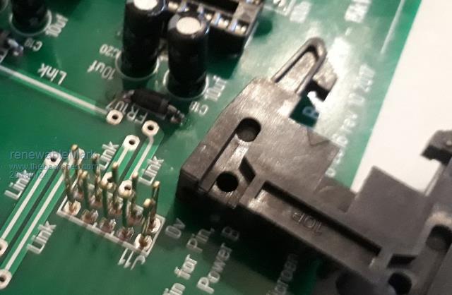

Tony, that's prone to making mistakes by connecting the wrong lead to the wrong pin, but at least when you push it down you would feel some resistance hopefully indicating a good contact.
You can actually pull the plastic part off the IDC plug leaving the pins neatly aligned on the board.
In my case, I don't think that's the problem, but I hear you, if the replacement boards weren't so cheap I would persevere and probably try that.
You do seem to get confidence in a connection when you can feel it go on tight.
I did a resistance check on the cable by itself and pin to pin on each board, everything was fine, so that's not my issue here

That type of connector is excellent because it has good strain relief.
Most are not like that.

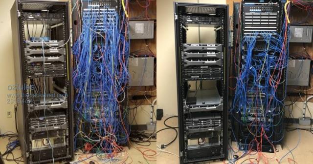

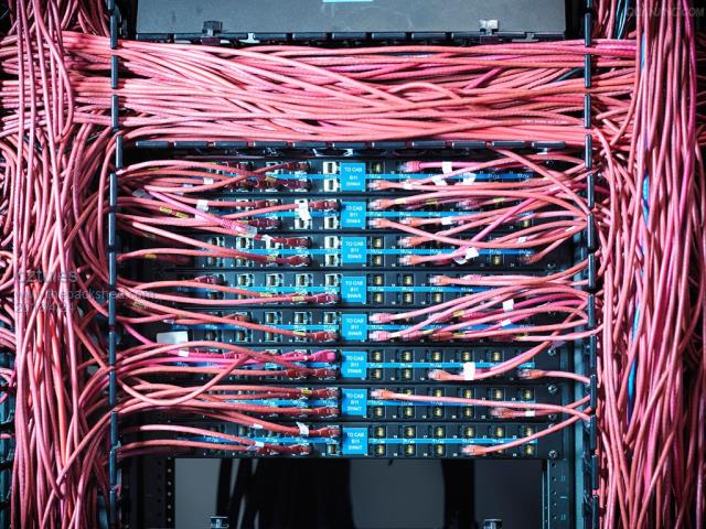

I do take your point Warp, and there is sense in it too...
But life without ribbon connectors can get like this very quickly when you have data lines or a lot of interconnects
or this:
Imagine the insides of a tower, with 40 wires to the ide HD, and another 40 to the CD drive and yet another to the second disk... 120 wires drifting around the place.... and need to be fitted. The alternatives are difficult to perceive.
So it seems to me to be the best bad alternative, rather than just a case of bean counting. It is simple repeatable idiot proof manufacturing..... and that makes it cheap.... I need idiot proof, so maybe thats why I am drawn to it.
Don't withdraw just because we differ on opinion.... thats a good thing. Folks need your expertise more than mine, as you have a lifetime of electronic experience that I don't have. That does not mean I have to agree with every aspect of your beliefs.
In this particular case, it is easy to reverse the header connection....only once.
After that you get it right every time. Longevity is another matter, but in this case we just need to get it to work.... then it can be tidied up any way we want...... but to get a working example is the first priority. Once that is achieved,we get experience, and then can move on to point to point if we so chose.
Because you understand what you are building ( because you designed it anyway ), it is easy to point to point, or break it down into smaller plugs and sockets as tinker has done, but as a first step, repeatable is best, and that means a paint by numbers board/s, and a blind wiring scheme ( ribbons)
Prototyping can look like this,
But, can you imagine manufacturing in this form?
......oztules
